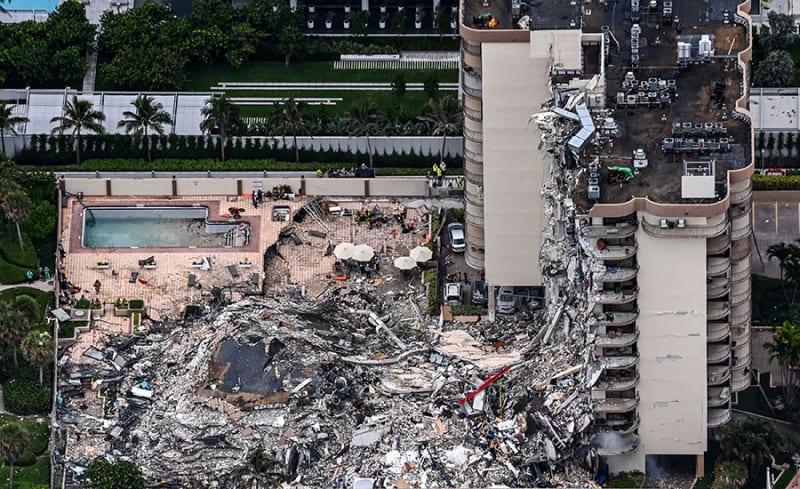

Here is the original interview with the person who made it out of 111 that @Spartan5 mentioned, He doesn't say where he ran toward but sounds similar to what the lady said on the phone (412) that the 'pool/lobby's deck may have been the initiating failure.
Is there a ok plan showing the apt #s?
News interview from a sister of one of the missing: (from Apt 412)
"Suddenly she says, 'honey the pool is caving in, the pool is sinking to the ground'," "He said 'what are you talking about?'
And she says, 'the ground is shaking, everything's shaking' and then she screamed a blood curdling scream and the line went dead."

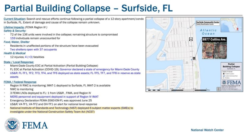

Separately, as was mentioned earlier, NIST investigators are on the scene. This from yesterday.

I note that two witnesses appear to be saying that the "pool deck" failed first, by perhaps a minute or more. To me, the pool deck is the expanse between the pool and the building. Photos show it surely did drop, by one level, I think.
I propose that by having that floor drop, there was then, for the soon to fall building(s), nothing to keep the intersection of their columns at that same level from moving towards the south (towards the pool deck location). I am assuming a solid sheet of concrete across the whole expanse, and I believe it likely there was a garage under the whole thing. The building could stand until some perturbation caused the sideways movement of those points on the columns, and they fell.
spsalso
He would have been blocked from seeing the pool deck by the still standing buildings. It appears it happened and he missed seeing it.
One of the witnesses was in one of the buildings that fell, and said something about the pool area acting funny. So it surely seems like that HAD to have happened first.
spsalso
I'm with sdh4 and dold.... the pool deck could have racked the columns along column line 9.1
That would explain the sudden collapse if several columns were able to fail nearly simultaneously
This would have been view from BlueGreen Hotel next door. They wouldn't have seen pool deck, but he could have seen first floor collapse into the garage first.
