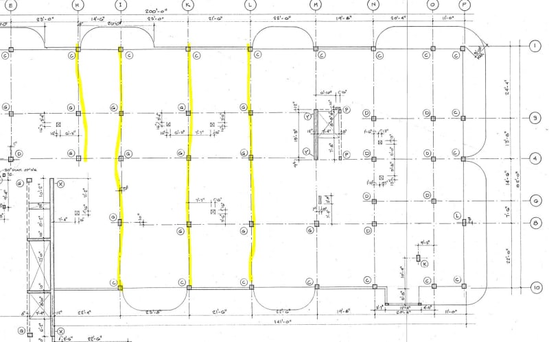

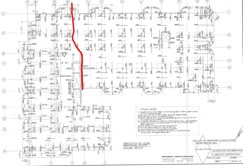

Nearly all of the upper-level columns in the remaining portion of the building sit on transfer beams between the first and second floors.
The three exposed columns where the parking slab fell (J12, J14, J15) are larger than necessary for architectural reasons below the second floor, likely why this portion of the building did not collapse.

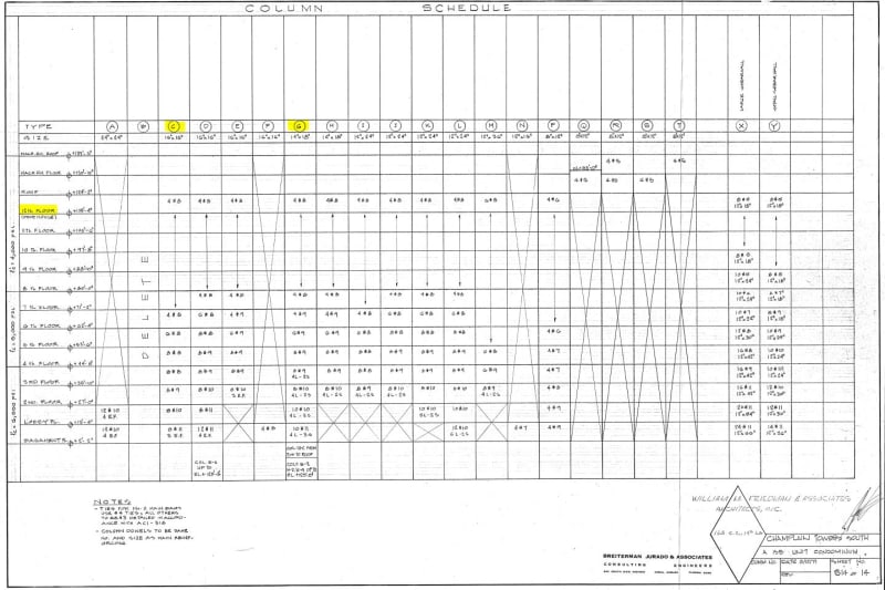

The columns in the collapsed portion were at minimum dimension all the way down, hence they would be first to fail with deterioration, settling, etc.
ALL of the columns in the initial collapsed portion are Type C at the exterior and Type G at the interior.
These columns have quite a bit of rebar at the lowest levels 12 x #11 in 16 x 16 (Type C) and 10 x #11 in 14 x 18 (Type G.)
Both types near the maximum reinforcement ratio, once concrete spalling occurs they would theoretically be over code allowed ratio and need to be strengthened.

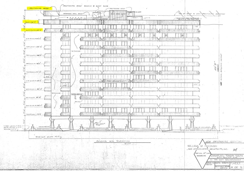

In addition, they appear to have been overloaded. According to the plans provided, the columns were not designed for the penthouse addition.
The column schedule mislabels floor 12 as the penthouse.
The penthouse addition drawings show the penthouse at the roof level or floor 13 (the elevator to the penthouse from floor 12 does not appear to have been added, instead the corridor was extended to the main elevators.)
The area under this corridor collapsed first.

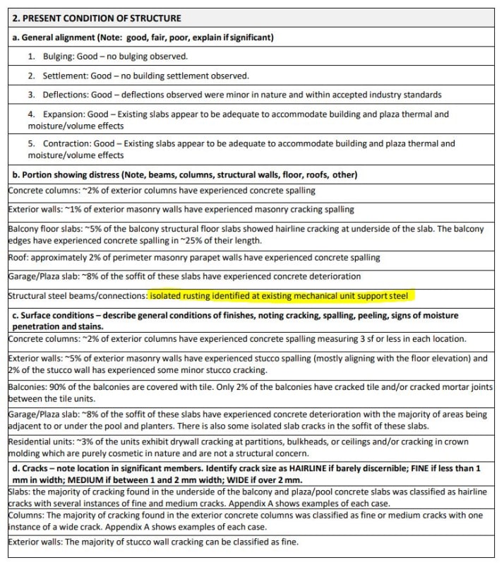

Finally, the recertification documents note the structural steel supporting the HVAC system had isolated rusting.
Failure of the HVAC steel would have caused exactly the type of collapse we saw (see my prior post above.)
The question is when was that review of the supports for the HVAC done. Considering we have documentation that the equipment was replaced within the last 2 years it seems hard to imagine that the supports would be in that bad a condition that rapidly.

The review you quote showing rusting of the HVAC system was supposedly done between 8/01 and 9/06/2018 but was not received by the town of Surfside until "5:35 PM on June 24, 2021."

IEGeezer: Beginning of the report says: "This report was not formally submitted or authorized by the property owner Champlain Towers South Condominium Association, Inc., as required by Section 8-11(f)(iv) of the Miami-Dade County Code."
I saw that also and wonder who paid for and authorized the study if it wasn't the Condominium Association?
warrenslo: You are correct. That's why I said supposedly. Providing a report two years late and hours after the collapse raises eyebrows.

Do we know which column on the x11 stack failed? Assuming it was a corridor column as the collapse seemed to start there. Those columns had an extra floor added to the roof for the walkway to the penthouse addition. The corridor column part of the collapse furthest to the east had both the penthouse walkway and HVAC frame added to it.

I don't think the current public evidence gives any certainty around that. To me, the security CCTV from the south makes it look like the K,L,M columns were first to go in the upper collapse, probably rows 4,8,10 (I'd guess row 10 first, but it might have started at the corridor row 4).
The red HVAC support frame looks to be the same for both old and new. It appears to span E & H columns in rows 2 and 4. There's also the I series of columns between it and where I believe the earliest upper collapse is visible.
There's a fair bit of interpretation / guesswork above, trying to interpret the distant CCTV image which is looking diagonally across to it and it's all very quick. We can't rule the new HVAC unit out as one of many contributing factors, it just doesn't look to me that it was at the root of the failure or part of the early progression.
