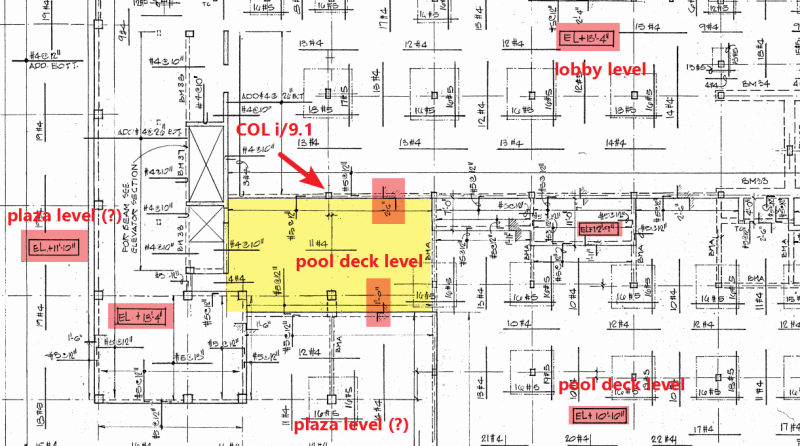

Looking at the video it appears that the column on grid I/9.1 was the first to go, although I can't see the interior columns to the north.
See attached snip from the lobby level slab. A couple of items regarding the yellow area and the column with the arrow pointing at it:
Lets say:
+10'-10" = pool deck level
+11'-10" = plaza level
+13'-4" = lobby level
1) this looks like a low point (+10'-10" only open to the pool area to the east) where the slab would seem to be at higher risk of corrosion. ;
2) there is a 2'-6" step in the slab at this column joint.
2.a) this leaves a decent offset between a potential lateral load implied by a failed slab panel (possibly yellow area?), and the restraint at the primary deck at +13'-4".​
If the yellow area collapsed first or another area at pool deck level collapsed first then triggered the yellow area to collapse doesnt really matter I suppose. If the yellow area fell at any point I would start looking at some amount of lateral force being applied to the column between two supports (foundation/basement slab and the slab at lobby level).
Next, perhaps since all the columns along grid 9.1 are tied together with a beam at the slab step, if column I/9.1 (i.e. "the suspect column") collapsed first, that could potentially mobilize a force on grid 9.1 columns acting to the west, with load path bonus from the steel in the perimeter beam.
This seems to be reflected to some extent in the collapse video - the columns along grid 9.1 are among the first to go, starting at the suspect column and propagating east.

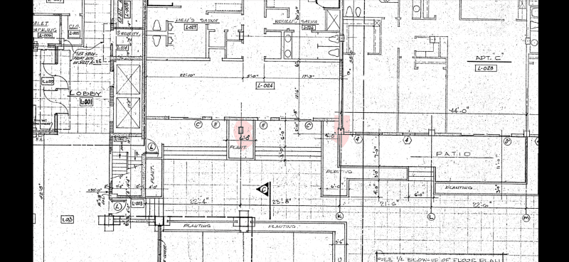

This is exactly the column that stood out to me.... It kinda looks from aerial that it could be where the planter was located 🤔 extra load and water infiltration and maybe not as easy to see during a visual inspection.
The waterproofing may not be a structural issue, but the slope and drainage definitely is a consideration and coordination that should always be considered. Even now I've seen lots of architects try to apply waterproofing to a flat slab and then "slope the finishes"..
Obv lots of speculation at this point, but as engineers our brain is trying to find an explanation to this horrible tragedy.
@missstructures I agree with columns on 9.1 line. Particularly @ I and K line. Both are exposed to planter box at lobby level.

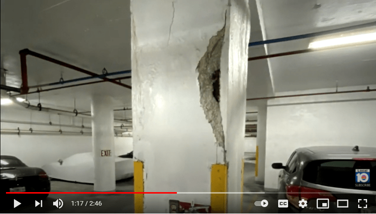

Below is an image taken from a youtube clip on the sister building. The column doesn't look safe with the cracks and concrete spalling.
Surprisingly residents are still allowed to live in the building, given the witnessed catastrophe.
That's from
They say that's Champlain Towers East, which is the much newer of the three buildings (1994, I think), which makes it all the worse. Champlain Towers North is the one which is near identical and the same approximate age as the South tower that has collapsed.
That looks about head height, so unlikely to be vehicle damage, it must be corrosion damage. I'm not an expert on corrosion in RC, but up high on the column suggests to me it's probably coming from the slab above rather than rainwater from vehicles. I know how destructive the ocean environment can be, but that's scary. How bad is the pool deck slab as a whole, if that's the state of the columns supporting it?
I certainly wouldn't want to be within a block of that building right now, until it's been properly surveyed (and appropriately shored up / repaired).
