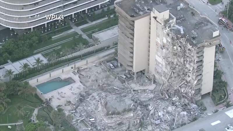

Quite an incredible collapse for an RC building (if this is what it is). This couldn't have been a single column failing but the whole ground floor somehow. Very strange.
Going frame-by-frame in the video it looks like the failure initiated at the base and over a large area. My guess is a sink hole.

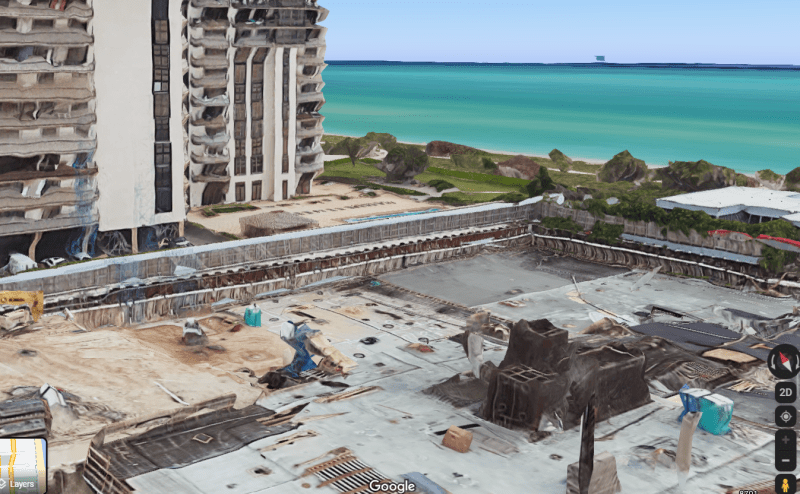

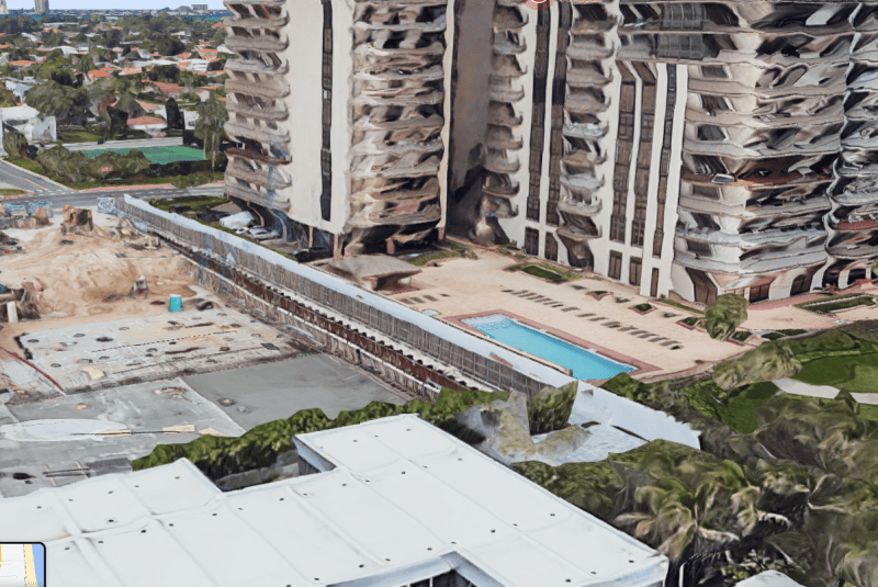

Some more perspectives of the adjacent construction. Looks like that building has been completed based on the image posted by JoelTXCive.

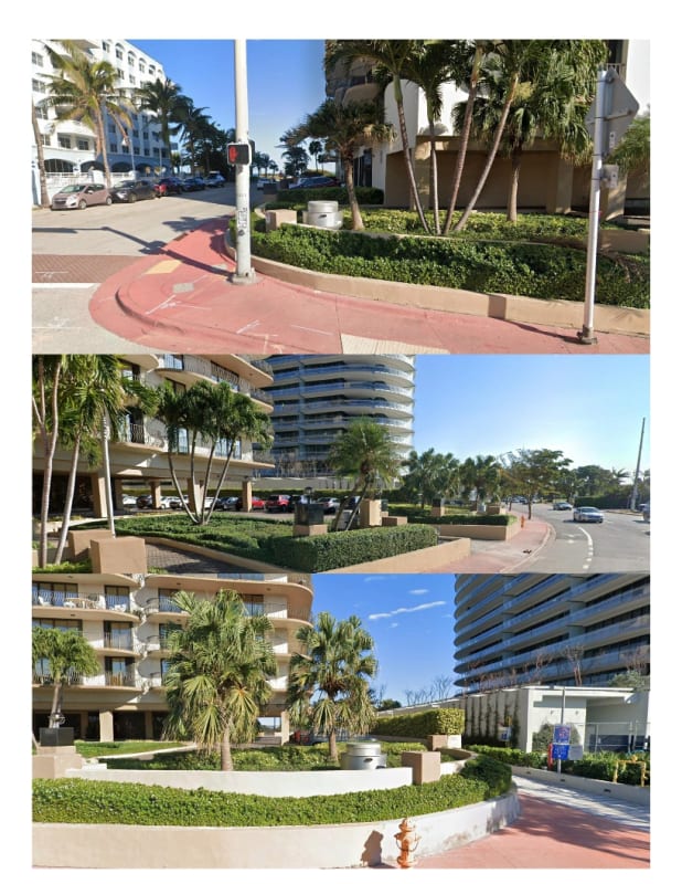

you can see the entrance to the parking garage on Google street view.

There appears to be subsiding in the area adjacent the collapse. Look at the cars in the parking area. The depression extends out towards the pool.
I noticed that there appear to be exhaust fans mounted at ground level along the western edge of the parcel are these for an underground parking? (must be a pretty big garage if that is the case)

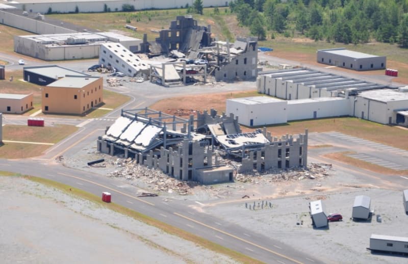

Not me, but my boss volunteered someyears back to be an on-call volunteer structural engineer for fire departments. He would train with them occasionally for building collapses, partial or full, etc. and basically he'd be directed to inform them if they could demolish this wall, or this steel section etc. Where to put up temporary shoring if needed, etc. The risk assessment portion however is valid, and he explained some law (this is hearsay, so im not sure how true this is) that carves out an exception for structural engineering consulting during ongoing rescue operations.
@rscrane Urban search & rescue teams often have a structures specialist on the team who will evaluate low/medium/high risk, lowest risk entrances to the structure, if/what shoring is needed, etc.
This is probably far more info than you ever wanted, but here is one of the manuals for this role:

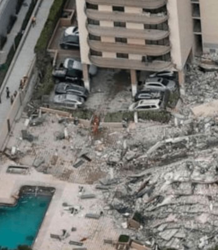

This is a complete speculation on my part, but it looks like theres a below grade parking garage here and I wonder if the column layout matches the framing above. You can see in the images the columns of the garage have clearly punched through what appears to be the 1st floor slab.
Re: rescue training, etc - there is a facility in Georgia, US built specifically for the rescue training operations. Perhaps not so much structural assessment, but they definitely practice placing shoring and demolition, etc.
I may or may not have been involved in the construction...[shadeshappy] .
guardiancenters.com/

beej67, karst related sinkhole was my original thought but as Rimitikitavi pointed out, the columns are still in place and have punched through the deck.

I think the punching shear failure seen in the photo could also have been caused by the impact of the collapsing building landing on garage roof slab.

I saw a picture of cars sitting on a slab that was detached from its supporting columns. If you lose a slab in the parking garage due to punching shear, the column slenderness immediately increases with a commensurate loss of axial capacity. If that capacity is less than demand, gravity will do the rest. Whether the parking garage slabs were overloaded or have been slowly failing for some time until last night the capacity finally dropped below demand is currently unknown. My guess is the parking garage slabs failed in punching shear for some reason and the suddenly (more) slender columns were instantaneously overloaded leading to the collapse.
ETA - from the picture, there weren't drop panels or thickened slabs at the column locations.
