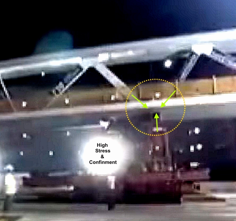

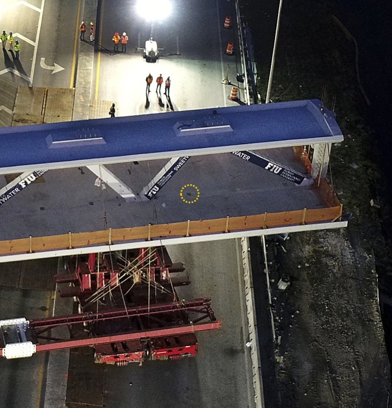

An article from heavy.com...there is a time lapse of the bridge move. Hopefully, some video at the time of the collapse will turn up.
I can't see the position of the transporter wheels.
They have the ability to castor individually or be steered individually.
I doubt that the wheels would be dragging sideays.
Bill
"Why not the best?"
Jimmy Carter

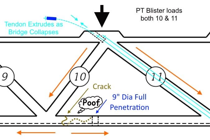

Member 11 may have been a tension member during construction but it was a compression member after the temporary supports were removed. Assuming a total weight of 950 tons, the bridge reaction at each end would have been in the order of 950 kips under dead load only. Member 11 appears to be oriented at about 35o to the horizontal, so it would have been loaded to about 1650 kips, a compressive stress of 3,300 psi on a 24" x 21" section under dead load only. It did not need any prestress at that stage.
At that cross section and length, how stable would that member be against buckling?
We should remember that the drawings we have seen are preliminary or proposal drawings. The construction drawings may well differ. The pipe stays are one thing that could have been changed to allow movement. The cast in bolts could have bolted down a bracket, which then had a slip connection to the pipe. But that is conjecture, and I agree if built the way the preliminary drawings show, the stays would have changed the way the final structure worked dramatically.
Lonnie P asked if the truss/frame was monolithically cast. I think it was, more or less. There must have been some construction joints, but I don't think it was a matter of precast elements being connected together.

One possible explaination...,
Why would a crack form in an area that is under considerable compression both from the PT tendons and the overhanging load?
The distance between the canopy and the deck remains constant at #10, while outboard of #10 they both hinge together.
