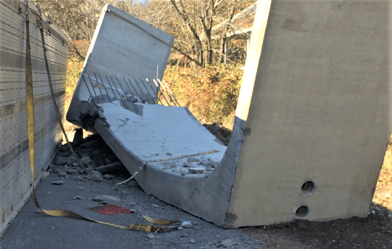

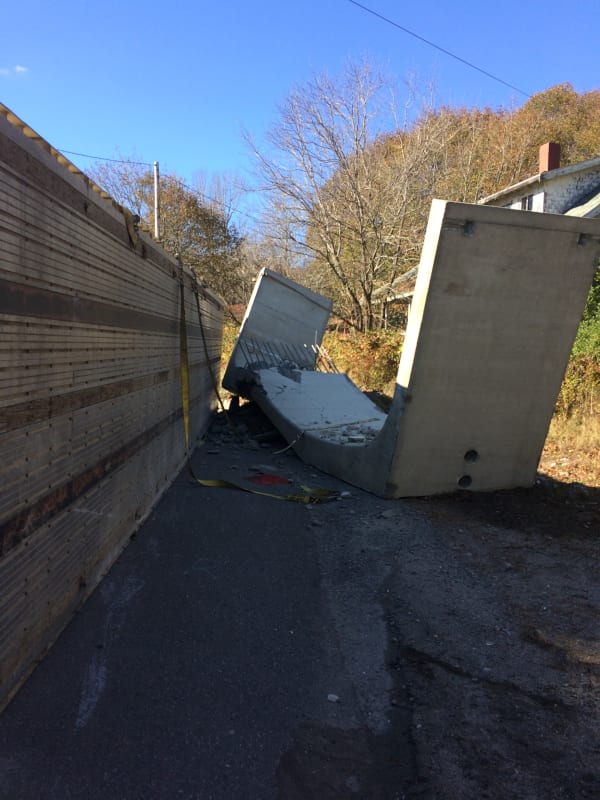

For reference, here's a precast arch structure I designed that was unfortunately damaged during shipping (no injuries except to the drivers pride, thank goodness). It was not prestressed but just look under the fracture in the shadows; lots of concrete debris in various sizes. If this was prestressed I imagine it would look even more destructive.
Concrete just doesn't like being thrown at the ground I guess. [roll2]
