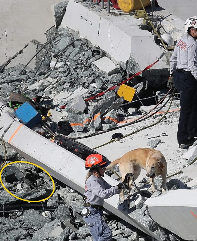

It looks like they have needed to do some chipping around the PT Blister opening. Having a hammer chisel strike the plate washer of the PT strand would account for the strange whipping sound one witness remarked on. It would have somewhat of a warped echo sound.
Bigger:
