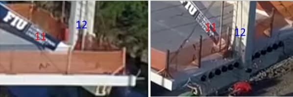

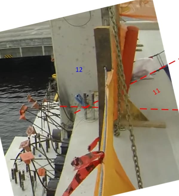

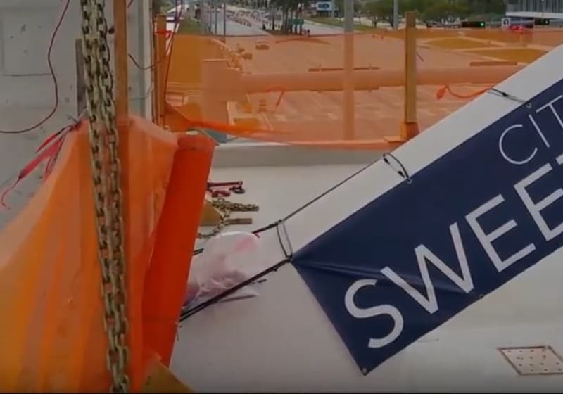

Here's a look at the connection of 11 to the deck and to 12. First a couple of images for orientation showing where 11 and 12 would have been located relative to the lower deck, that is now resting on the ground.:
and
[and added later, from the link epoxybot posted 17 Mar 18 04:22.]

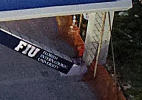

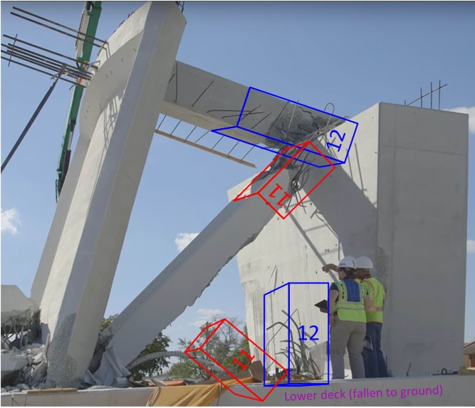

Now side view of deck at 11-12 after collapse:

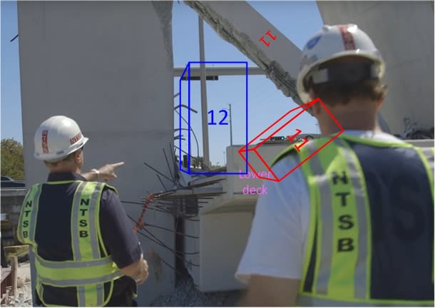

... and finally, a closer look at the connection point where 12 and 11 are no longer connected to the deck.
One thing that strikes me is the likely difficulty of transmitting compression from 11 to the deck right in front of the openings for all the services in the vertical 12. And where's the rebar that would tie member 11 to the deck? Perhaps obscured by the rubble, and/or torn out and still attached to #11. But maybe engineers who actually know something about this topic would see something different.
The last two images are from the NTSB videos, linked in my previous post.

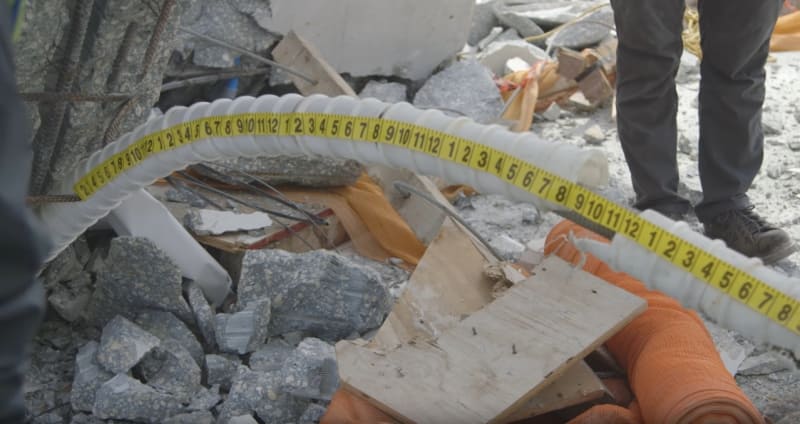

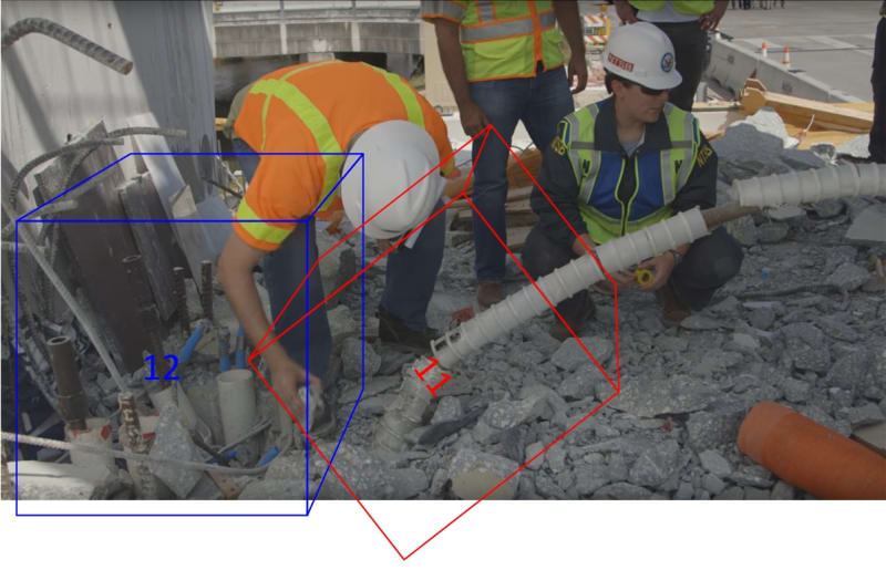

Does anyone know the size and load of those two PT rods in #11?
According to the page 115 (Drawing sheet B17, 2015 NOT FOR CONSTRUCTION DRAWINGS), there is no PT rods in #11. But reality doesn't seem to fit those drawings.
Those drawings are hardly rough sketches either. There are quite specifica about the placement and loads of the PT rods including orientation within the beams so they don't interfere with each other at the nodes. (AKA some PT bars in cross section are in the XZ center plane, others in the YZ centre plane while are distributed to the corners.) One would suspect that member #11 wouldn't need PT once the bridge is in place as there is already significant compression. Adequate nodal reinforcing however would be obviously essential. If however adequate nodal reinforcing isn't present then tensioned PT rods could help keep the connection together.
That said it would seem the PT tendons that did exist in #11 were essential to holding it together. If we make the reasonable assumption that the PT adjustments that were being made was the straw that broke the bridges back.
AUCE98 said:
I worked for VSL as an engineer for two years several years ago, mostly monostrand commercial building design work. My understanding from some former coworkers was that they were in the process of de-stressing one of the threaded bars when it collapsed. So they were attempting to reverse the stresses within the no. 11 diagonal when the collapse occurred.
As mentioned about this likely allowed the connect.on that was already under significant strain to shear. One would expect that adequate reinforcement would have been provided for. But clearly it wasn't.
From Ingenuity's post, "Keep in mind that the 1-3/4" grade 150 ksi bar was stressed to 280 kips (max), about 70% of UTS."

Zero experience with bridges, or concrete, or pre/post tensioning, but also rolling around in my head is the arrangement of the PT strands at the top of member 11. If we believe the not for construction drawings we've seen, one strand goes right through to the top of the blister, past member 10, whereas the other stops short and is embedded in the joint, before member 10.
They were presumably working on the 'longer' PT strand as that lines up with where the construction guys were on top of the bridge before collapse. It doesn't make much sense that releasing compression from the strand would cause failure when the member is acting in compression anyways - technically you should be making the situation better (less compressive stress).
What I am wondering is what else besides applying compression was that 'long' PT strand doing? It looks a lot like any compressive loads in that strand would also help to carry shear between the top ends of members 10 & 11 and the canopy. By releasing the compression in the strand, has more shear load (unsuccessfully) been transferred through the remaining members of the joint?
EDIT. This is the picture to which I refer (from Pt 1 of this thread). If you picture this drawing without the 'long' strand in member 11 (e.g. if compression had been removed from it) the joint as a whole looks awfully weak to me with very poor load paths between all of the members.

... shows two PT rods exposed at the joint of 11 and 10, with the lower of the two apparently undergoing adjustment with the jack.
You probably saw the drawing which seems to detail the 2-3 junction.
gwideman - I thought B was one of the strands of member 10? Maybe I am mistaken.

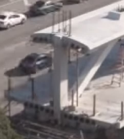

Im a chemical engineer, so to those who know about this subject:
This shows a drawing of the pedestrian bridge when finished from my local (Danish) engineering society paper. Why was the bridge erected without the cable stays? Wouldnt a bridge like this normally be build so that the pylon was build before the span is installed? Was this a part of the "accelerated bridge construction"? Or is the drawing an outdated drawing?
Best regards, Morten

Morten - this has been already covered in earlier comments. No need to repeat it.
