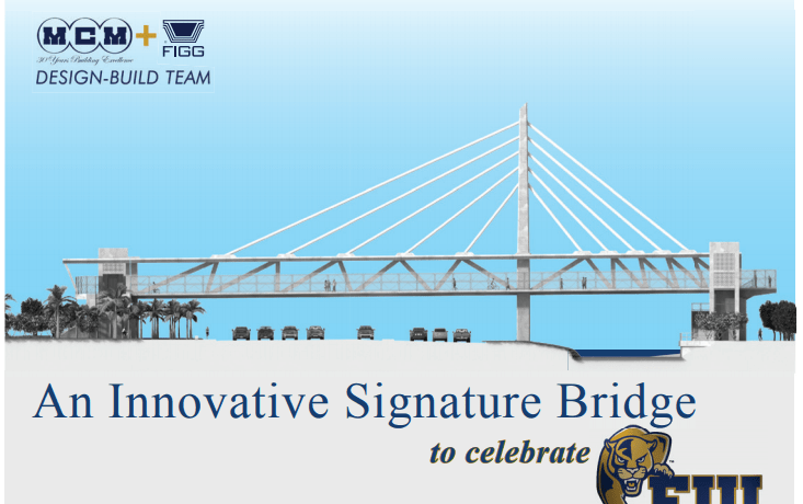

I maybe in a minority, but, I thought the original design was attractive, and, an interesting engineering design problem. I also think the cable stayed members should have been incorporated into the design. With the 'slender I-beam/truss' configuration, the lateral torsional stability would have been a major design issue.

The bridge in that link looks like what they were building.
I thought there was an original design I hadn't seen before. I did run across this design in my earlier searching. It's certainly more attractive, and it has real cables.
A cable stayed bridge might have closed the road for months. It might also have collapsed as the Colombia bridge did, for similar lack of appropriate design and analysis work. Just like the steel structures in the Hyatt Regency and the I-35 bridge.

The long span of a cable-stayed bridge could be made with six nearly identical sections built nearby. After building the support structures and the short span, the six sections of the long span could be moved into place and supported with the cables one after the other in several days. Not as dramatic as moving a one-piece span, but certainly doable. It would show off the benefits of ABC, too.
