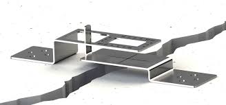

Bolton Perez & Associates used photographer's thumb as scale, not a crack width meter. And a pencil mark instead of a CrackMon. If true, this is very dubious for professionals. Serious tools for monitoring cracks:
I sure hope the final report is better... this was a total waste.

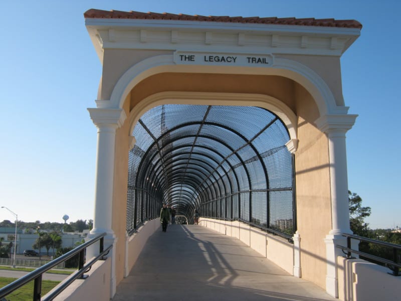

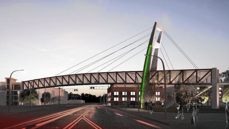

While learning the results and recommendations of the investigation will be interesting, I'd much rather see what they decide to build in place of the failed project.
I think it would be sensible to put up a precast double tee bridge, as is commonly done to provide pedestrian access to properties that are otherwise isolated by new expressways. There seems to be a common or semi-standard design, supported by two or three hammerheads, terminated by spiral ramps or stairs, and completely covered by chain link fence.
That 8 foot tall 'projectile barrier' or whatever they call it in the plans is just silly. FIU no doubt has multiple students of both sexes who _could_ loft a bowling ball over it with ease. ... and at least an equal number of local nonstudents and random miscreants who _would_ do it, for no particular reason.
Mike Halloran
Pembroke Pines, FL, USA
I would hate to be in a wheel chair and use either of those bridges. That's probably why similar designs lost.
