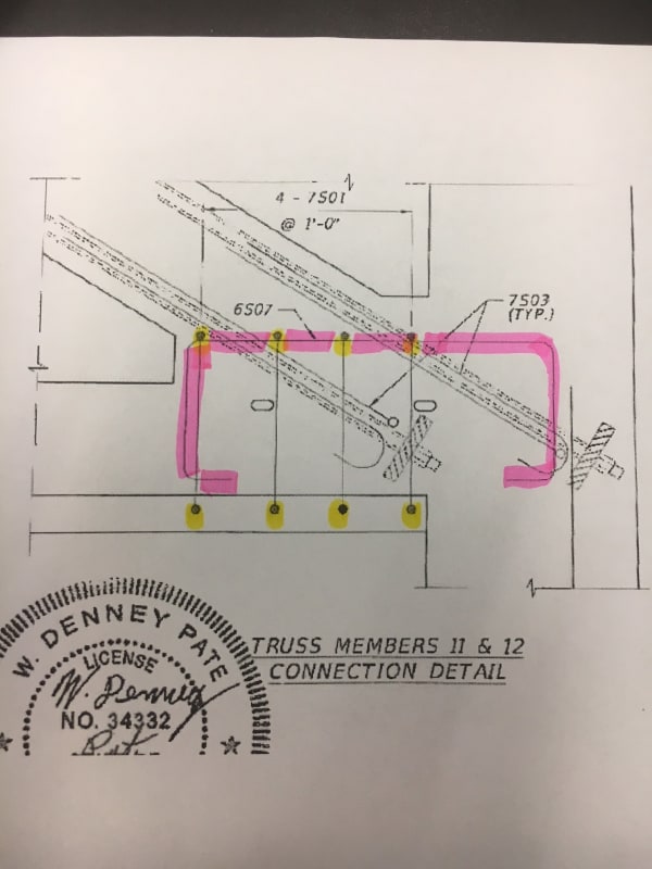

3DDave -- could you perhaps direct me to the post in which the reinforcing steel in the deck is disclosed that would accommodate the shear forces set up by the #11/#12 connection to the deck? I have searched through the VII parts of this blog, and cannot locate anything that fits that description. I'd really appreciate. :)

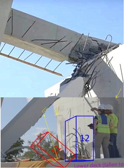

B-46, Pg 71/110 at lower left shows detail for two PVC pipes (labeled 4" I.D. Reinforcement sleeve, through which passes the rod to pier??). There are two on each side - NTSB photos show the deck broke at the outside edge of these PVC pipes. I didn't see such 4" pipes at any other diaphragm connections (there are two pages for each.. labeled Type I at south end of mainspan to Type IV at north end of backspan.. so Type II is at #11/12).
I was searching for deck-reinforcing rebar which epoxybot 21 May 18 18:40 brought up in that photo/angle I'd never seen before... I thought #12 sheared at the deck, but NO! the cold joint held... looks like it broke apart at the top of the (spec'd) 8"x12" anchor plate... looks like ~1.5" concrete behind it, and on 21" wide truss/support, would only have 4.5" on each side of it.
Besides higher stress at #11/12 shown in Toomas's analysis,
, 30 Apr 18 21:20
this area doesn't have much concrete supporting everything that's embedded within it (and an 8" embedded drain pipe below it).
I have some questions about my own montage above.. the duct stayed in the member about halfway down. Will look at it more later. The length matches what's on the ground.
#11 rode up #12 during collapse (can see marks), but ended up east - rebar and PT rod/duct don't look like they "mashed" against 12 as these look about same position as they'd be in the cast member (upper rod's duct is still intact).
I don't think the 1.75" rod "kinked" or bent so much, but was pushed out of the blister as deck fell, as PT rod supported #11 a bit and "eased" it east. At end of Gwideman's loop, #11 is about parallel/resting on deck, and deck is still resting on the pier. Longer slow motion video shows the deck falls after the 10/11/canopy comes down on it - jams against pier, then falls to ground.

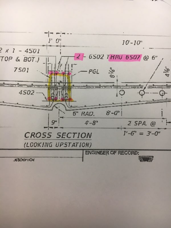

The images below are taken from the reinforcing steel details posted above by 3DDave
They are taken from pages 86 and 87 out of 110.
They clearly show that the shear steel at the connection between #11 and #12 to the deck is totally inadequate. It hardly makes nominal steel requirement. The person who designed this connection was clueless. No wonder the investigation is being held in secret.
