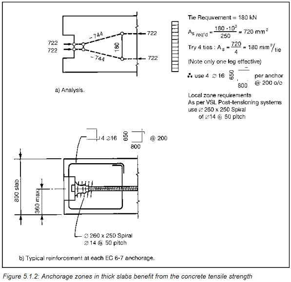

For PT strand anchorages, the manufacturer provides spiral reinforcement directly behind the anchorage. It is still the responsibility of the engineer to check the zone situated further behind the spiral. For threaded bar systems no such spiral is provided by the manufacturer, so it is solely up to the engineer to detail this region.
Those picture represent confinement for the axially applied post-tensioning only. Similar to column ties, which confine the longitudinal bars when they are in compression.
In the Florida bridge truss/frame, there was also a lot of flexure and shear in the joints, and I think that was not accounted for.
That was my next question- so the confinement reinforcement for certain types of PT tendons is defined by the manufacturer of those tendons.
In cases where the confinement reinforcement is (for lack of a better term) 'included' with the PT strand design, how common is it that additional confinement reinforcement is required?
Or, asked another way, how easy is the oversight which appears to have taken place- no additional confinement reinforcement in the 11/12 nodes?

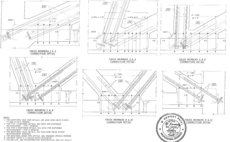

I wouldn't go so far as to say no confinement reinforcement is provided. As far as I can tell, drawing B-61 [ Link] shows reinforcement details at the truss joints. To me it looks identical for all joints (except for truss member 3-4 where there actually is more). This is just a feeling, but I wouldn't expect this to be the case because loads are likely different at every joint: PT, axial, shear, bending. If anyone has been able to find in the design drawings a detail for additional steel called out for PT anchorages at these joints please post.
Understood. I apologize if my questions are causing us to go back over material that's been covered before- but for someone not at all versed in the minutiae of concrete design, this thread is like drinking from a firehose. It's terribly interesting but there's an overwhelming amount of information.
Re: reinforcement schedules shown in the post above:
The reinforcement shown looks to me (a non-concrete reinforcement engineer) to be remarkably light, compared to the references.
Much of it appears to be located in the 'general zone' and beyond (as described in TheGreenLama's reference graphic 2.2), especially at the critical 11/12 node.
Is localized crushing under the PT tendon fittings, where there appears to be almost no confinement reinforcement in the local zone, the potential initial failure mode the structural guys are seeing?
In the case of the upper tendon at #12, only the L-hooked bars appear to pass through the 'local zone' at that tendon's fitting, and based on the references I don't see how those bars provide much confinement since they develop tension (and appear to provide confinement) in only one axis.
When reinforcement schemes are analyzed, are bars loaded in bending considered to provide reinforcement, are are they disregarded?
Hay, I'm a computer scientist, so what do I know, but from what I saw in the drawings, the joint at 1 - 2 had 50% more rebar than 11 - 12. I wish I knew why they beefed up 1 - 2, and why they didn't beef up 11 - 12 at the same time? It's the human factor that throws me.

jgKRI,
I'll take a crack at some of your questions.
1) Reinforcement does look remarkably light and uniform.
2) Crushing should never be an issue as plate size will have been designed by manufacturer to transfer specified design load.
3) Circular anchorages for PT strand transfer load to concrete over a different surface area than the flat plate, thus the need for spiral steel immediately around that type of anchor. In other words, flat plates generally don't require spiral steel immediately behind plates.
4) Overall geometry of concrete section plays a role in how load moves from anchorage into structure. In our case it's not simple.
5) Generally, you'd only consider steel perpendicular to strand/bars to contribute. If it crosses at an angle you might consider a fraction of it to be effective, but there's no hard rule on this.
6) In the 11/12 joint area we also have a very large compressive force from dead load. I haven't quite figured how this impacts PT anchorages. I would think a good practice would be to still address anchorage zone issues regardless of other loads.
SFCharlie said:
...why they didn't beef up 11 - 12 at the same time?
Member 11 was not inline with faux stay, so making it larger would disturb visual design. In another asymmetrical aspect of the design, the deck diaphragm on north end was much smaller than the one on south end.

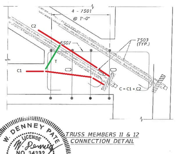

Let me just add one more thing before I'm off for vacation. Looking at the geometry of drawing B-61 more closely (detail shown here), what's to prevent a good portion of the PT force of the bottom PT bar from going into the deck slab instead of diagonal 11? (Excuse me if this has already been talked about before by someone else; maybe chris snyder.) My strut-and-tie diagram is not very good, but I think the result would be to induce a tensile force at the inside corner, potentially resulting in splitting in this area. Reinforcement would need to be detailed to prevent this. Now we don't know if they were in fact stressing or destressing this bar at the time of collapse, but as a general rule the anchor location, geometry, and existing detailing is concerning.

With the concentrated compression loading, due to the differences in stiffness, with post-tensioning you often develop high tensile stresses. This is one of the reasons for the added reinforcing around the anchorages. It's often not for crushing.
