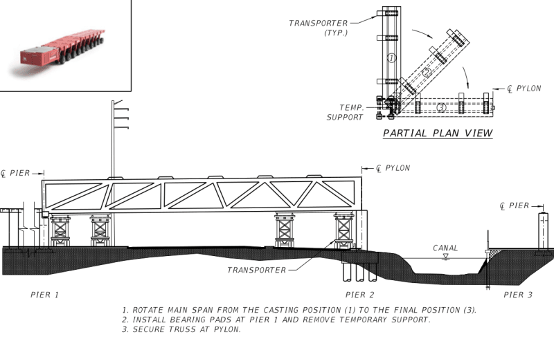

I am just being practical. This bridge cannot be tested at its casting position because when it is transferred its final position the lifting operation can inflict damage after it has passed the load test. The bridge could have been tested if it didn't collapse. However by then who would bother if it works?

It is speculative but not highly because had the bridge been transported as per original design the Member 11 and 2 would always be in compression, have no stress reversal and no need of any PT rod tension adjustment.
It can be argued that the original scheme may be impractical as some transporter wheels must travel onto the unpaved areas adjacent to the abutments. This will cause unwarranted if not uncontrollable settlements or movements of the wheels and endanger the temporary supports of the bridge.
Comparing the original with the actually executed scheme it would be obvious there had been a design change in the temporary work resulting the two end bays to have the ability to withstand as cantilevers not envisaged in the original design. In the original scheme it would be more difficult to manoeuvre the transporters into position, the rigid linkage between the four transporter supports would have to be more substantial(the original 4 separated supports were in the end bolted together to form just 2 supports), the cost has to be higher (unpaved areas to be concreted over, traffic barriers removed and then reinstated) and the worst of all is the longer construction time.

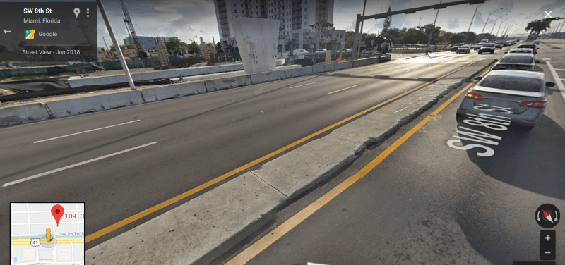

The bottoms of Member 2 and 11 are taper and not intended as support points in the design. Were the two temporary support points structural adequate or suitably strengthened for this purpose? If one looks at the centre divider kerb one may wonder if the design has the dynamic forces considered when the transporters crossed over it.
The Google map does show several newly patched areas at the position where the transporters had to cross over and a long unpatched damaged kerb section possibly sustained during the removal operation of the collapsed bridge.

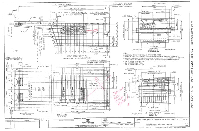

(1) As gte447f said the FDOT engineer has asked many questions about Member 11 specifically on the risk of cracking. The NBC6 timeline indicates on 15 Sept 2016 meeting, or 1.5 years before the collapse, FDOT suggested Member 11 needed to have PT rod to withstand the force when the bridge was lifted. He wrote "Cracking will occur here!" on several drawings. One of them is on the short span a connection similar to Member 11&12 with the deck
The two photos released by NTSB on 9 Aug update have the similar 45 degree cracks spread out as predicted on both sides of Member 11&12. One photo has been rotated to show the 45 degree crack is almost a mirror image of the other side.

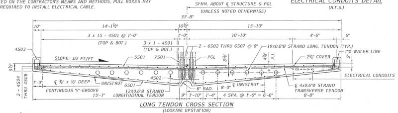

(2) NBC6 has a complete set of the FDOT approved drawings for construction. I post a couple below showing weakness which would be apparent to every reinforced concrete designer. This first depicts the Member 11 having very little concrete continuity vertically with the deck due to the presence of a 8" rainwater pipe.

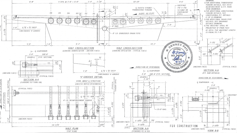

The drawing below depicts on either side of Member 11&12 there were 4 No. of 4" reinforcement tubes and a number of PVC cable ducts. Thus the horizontal continuity of Member 11&12 with the deck will also be compromised. In fact the second NTSB photo shows the crack crosses one of the cable duct.

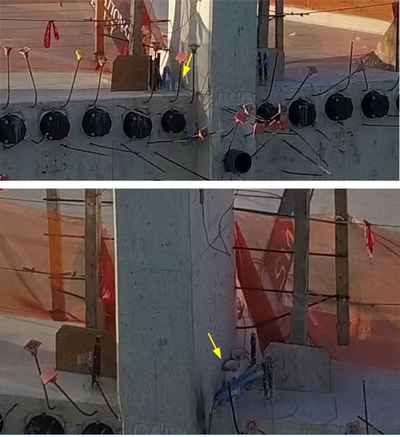

The interference of the embedded items can be seen from the photo below which has been posted previously here. Note that the bridge at that time was being hoisted and had not yet dropped onto the support so the severity of the cracks was not yet serious. Member 11 was in tension then.

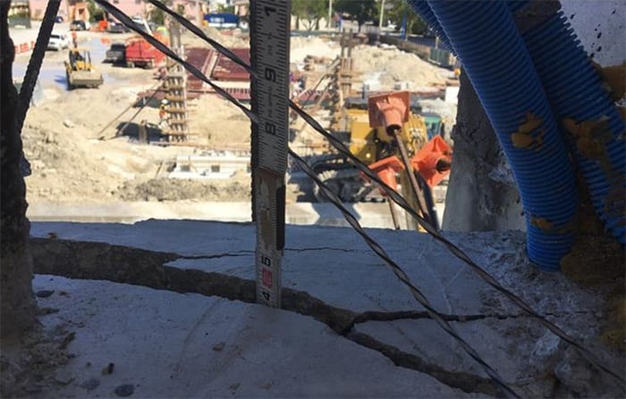

(3) Finally in NBC6 the descriptions of the photos taken by the workman, who fell but survived in the accident, alert me the severity of these cracks which I missed out. The first NTSB photo has been described as "4-inch crack" because the tape managed to dip 4" into the crack!
This photo also used by NTSB in the 9 Aug 18 Update and was described as "6-inch crack" because the crack has swallowed a section of the tape of 6" long.
Any professional engineer, who had access to these photos showing the most critical structural connection of the bridge has cracked and separated to a depth of 4" to 6", and did nothing to halt the construction or traffic deserves what is coming to him/her.
