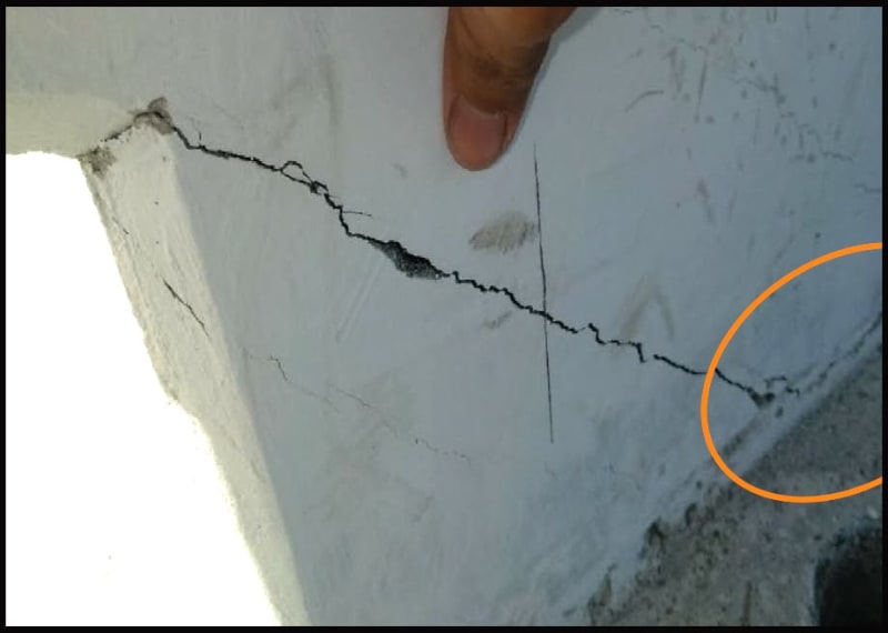

Hindsight is 20/20 but I think if I saw the photos of the initial cracks at the base of #11 and #2, I would go back back to double check my shear friction calculations. After the larger cracks opened up, I don't understand how this was not interpreted as a shear friction issue and that it was very serious. I wonder what the other engineers in the project were thinking. Was it like the Korean airliner crash where the co-pilot was too afraid to speak up to the captain? Were the junior engineers concerned about speaking up? We had shear, shear-friction and punching shear hammered into our heads at university.
saikee119 (Structural) - I can't say that Bolton, Perez and Associates documentation of the cracks was very good. Maybe there are more photos but close ups don't deliver the overall sense of what is taking place. The earliest cracking locations for member 10 and elsewhere were shown on drawings of the main span trusses. That should have been the case for all the documentation. That said, there is a photo from the 2/28/2018 email by MCM to FIGG that suggests, the cold joint at the base of the 11/12 node was already in the process of delaminating.
As OSHA pointed out, though painfully obvious, BP&A failed to identify the cracks as structural. The cracks in the back of the diaphragm, migrating from the base of the 11/12 nose, screamed RUPTURE! It is bad enough to see such cracks but when one side of the crack is no longer in plain with the other side of the crack, it is no longer a case of stress relief but a matter of fatigue. The out of plain concrete is actually hiding where the crack has gone in the depths of the concrete. If you are going to probe the depths of a crack, something more slender than a carpenter's ruler might be something an inspector going to examine cracks, might want to carry.
If you include the debonding of the cold joint in with the cracking at the base of the 11/12 node & rupture cracks in the diaphragm; you have one mode of failure. The other is the ?buckling/shearing/flexural-shear? on the number 11 truss. That too is out of plain. This is the crack that should have told Denny Pate he needed to rethink the re-stressing of number 11. I'm curious to know if the cracking in the truss happened after the the 11/12 node/diaphram cracked.
The photo documentation doesn't establish that the cracks were in fact, getting larger. Were they getting wider or were they elongating or both? There are differences in the photos but the difference is simply the absence of small fragments that have either been removed, settled, etc. FIGG's follow up to the presentation minutes, are probably accurate in this regard, that the discussion indicated only minor changes to the size of the cracks.
If you ever have to go out and examine or document cracks in concrete, take a spray both to wet the concrete. A crack can be longer than just what you see or there might be fine brittle failure or tributary cracks to the side of a larger crack. A rough finish can make the extent of cracking difficult to trace. The trace cracks may mean nothing but they may also highlight the fact that the crack has indeed traveled to the element to which you were primarily concern. Example: You specify epoxy injection of 20ft of crack that looks to be traveling towards a corbel but "looks" to peter out 3 feet from the corbel. 5 years later your replacing the corbel because the tiny crack you didn't see allowed water to get at the rebar. A nice blend of 70% Water & 30% Acetone makes for a good crack chasing fluid. The surface water/acetone flashes off quickly, while the water in the crack defines the crack with enough residence time to snap a photo.

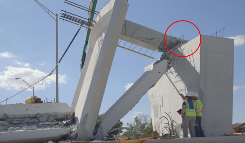

In my mind there was only one possibility and that was that 11 had to be taken out, either by rupturing or detaching from the deck/canopy and passing through to the other side (queue the twilight zone). The cracks in and of themselves do not lead us any further and, of course, the question of how these should have been interpreted is now under the auspices of various authorities and judges.
As I understand it, the first cracks were noticed and photographed immediately upon formwork removal and forwarded one or two days later. Next are the "cracked all to hell" photos upon release of PT rods, and then photos on several days leading up to the meeting, concluding with a verbal clarification that the cracks were getting worse every day and the cracks are more severe when seen in person than the photos convey.
The story they tell is rather simple. The structure settled upon formwork removal, then upon placement and PT bar release, assumed its new equilibrium, releasing the balance of the pent up internal stresses. It can be argued that this status could have been foreseen by astute oversight and monitored.

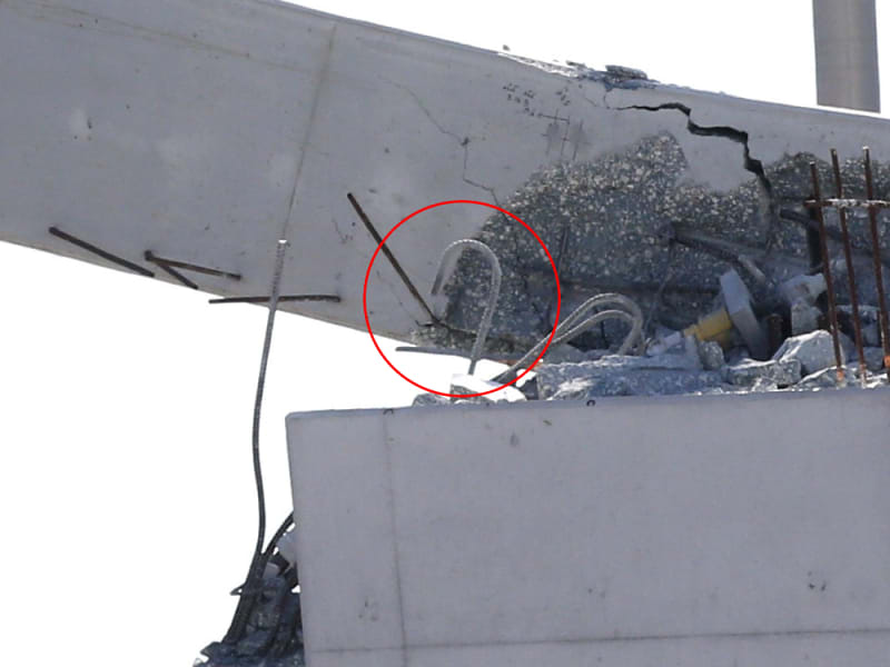

@jrs_87 (Mechanical) and @Tomfh (Structural) - your shear plane and green line drawings are helpful. They follow what I have been thinking but I don't have more to add. I'm not proficient at interpreting the rebar drawings that I've seen to date, maybe shop drawings would help. It would be interesting to identify the exposed rebar in the node and 11. The contortions should also aid in telling the story. I see one hook in 11 that should have followed the lower PT bar and sheared with the cold joint.
Those J-bars look like the ends of the longitudinal bars of #11. They were embeded in the bottom of #12, They stay with the base of #12 and appear to have not being going through the shear plane (the shear plan dipped down at the base of #12).
There are also J-bars with the lower PT rod, which is where I see this one coming from. It's just a question of how close to the plate they were installed.

On the growth of cracks the photos (Fig 24, 25 & 28 of OSHA) later than March 10 (Fig 23 of OSHA) do show small increase in width, especially in Fig 24 whereas Fig 28 & 29 show part of the delaminated edge broke off completely. There is no doubt that the cracks were worsening and not static.
You mentioned the cracks at the back of the diaphragm of the north end where 11/12 is located. If you examine OSHA's Fig 27 & 25 the cracking pattern agrees remarkably well with OSHA's prediction by Fig 78. The cracks occur along the boundary between concrete compressed inward (deck) and concrete pushed outward (11/12).
Personally I find it stunning that the cracked concrete of the diaphragm depicted by Fig 27 and 25 debonded totally from the span with little interference with the horizontal rebar after collapse (Fig 62) which shown is below.

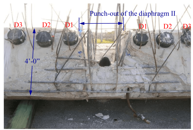

The bottom two horizontal rebar did not break. The two two rebar were not continuous. The neat detachment makes me think perhaps before the collapse 11/12 might have partially separated from the rest of the structure.

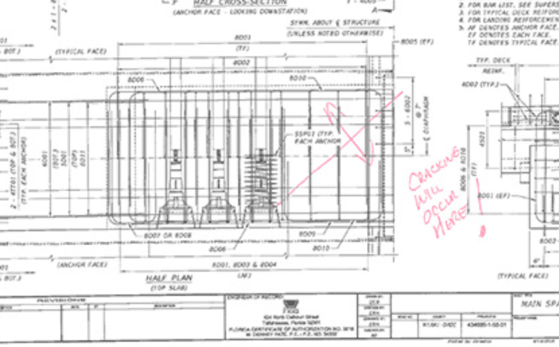

FDOT engineer when previewing the FIGG drawing also marked up the diagonal crack in RED that could occur at the such location but on the short span. FDOT's marked up drawing is depicted below.
Given that FIGG concluded the structure was mistaken to crack there I can’t imagine they’d have be too concerned by someone predicting it would crack there.

Re: J-BARS
I find it interesting that the concrete around the J-Bars is simply gone. Hit them with a garden hose and use them again. No evidence of stress to the bars.
Where is the concrete? It looks like the concrete blew out like a hand grenade.(Maybe it was terrorists?)
If this is the way 8500 psi Titanium DiOxide concrete works there needs to be a LOT of confinement reinforcing used.
Please comment - I think this is gonna prove critical in this case. Does anyone have experience with concrete and aggregates like this? Is it common in FDOT structures?
Thanks,
Look like it was all broken off during the collapse. It doesn't look like these bars would have been working too hard? They were all above the green line?

Have you considered why the slab survived under 11 while everything else blew out?
The deck PT cables prevented such a failure. The deck couldn't punch out that far back. The crack had to sneak around the cables via the horizontal interface between 11 and the deck, and then it fanned out once it could get around the cables.
