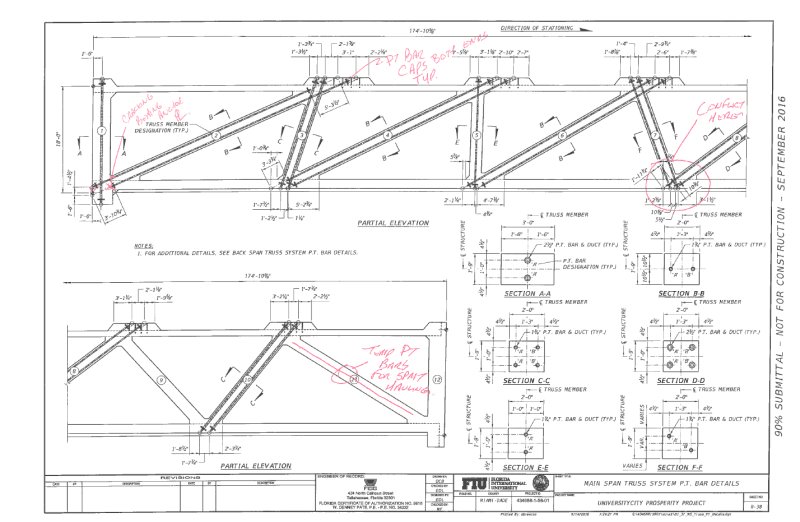

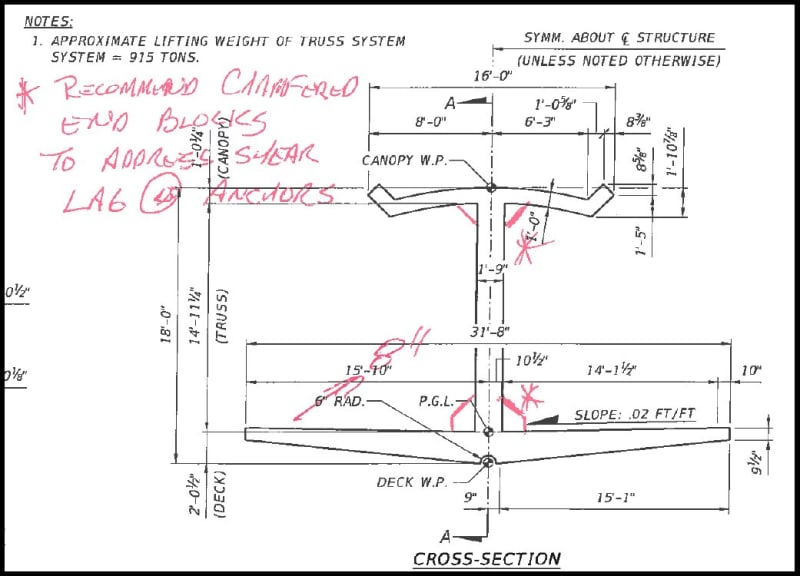

Here is one of Tom Andres last mark ups suggesting extended chamfers around the base of the node. (Ignore the lack of a diaphragm in the drawing. The notes on the drawing were positioned between a congested drawing of the diaphragm & the one shown, which he marked up for convenience.)

Do you think to chamfers were not considered due to the complexity of formwork required?

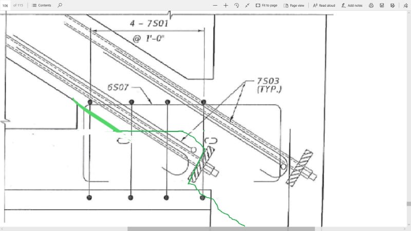

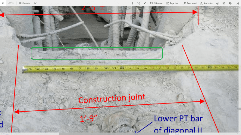

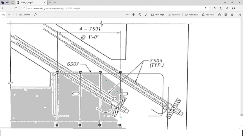

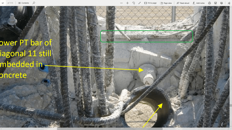

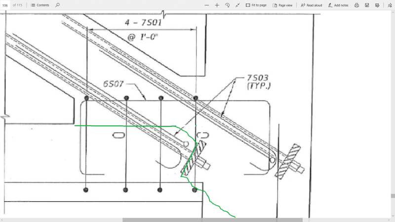

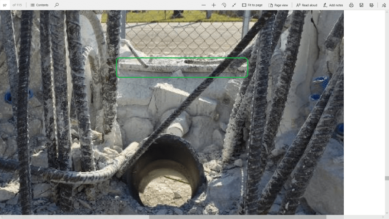

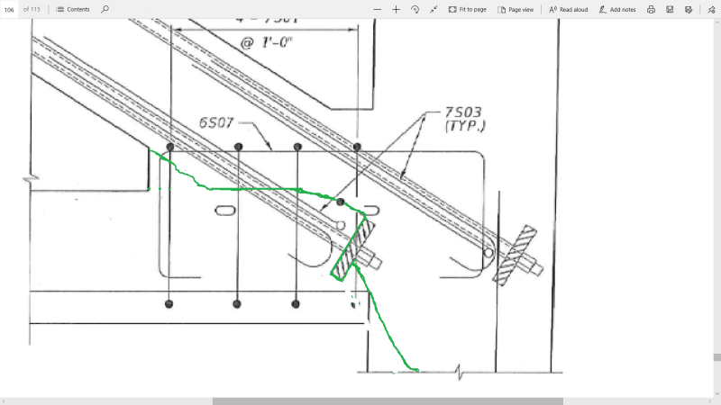

Please improve crude green line in first image or point to previous better one. I can see line needs improvement, need help or more time. The steel rule may provide scale. This is an interesting profile to me that I have not seen before. My goal is to see a crosshatch of all remaining concrete. Also in the drawing where is the rebar shown in photo 2, 3, 4? And what is it's function?
Jrs said:
.Please improve crude green line in first image or point to previous better one
Quick adjustment:
The triangular wedge was there at moment of failure, although may have been subsequently shaved off during collapse.
I also think the green line should cross through the PT anchor plate, not run below it. The PT anchor appears to have dug in, hence it remaining in the deck.

I also note that the FDOT engineer has marked up many drawings to convey his concerns including the locations of diagonal cracks now appeared remarkably similar in the doomed structure.
The information from FDOT is truly outstanding. I have the highest admiration of his in depth foresight of the problematic areas of the bridge and regard his contribution to the bridge as exemplary from his official position. I just hope his effort will not be misused by the legal people as excuse for contributing the collapse.
The one I got in mind is the suggestion to have the PT bars inside Member 11 which does not have any in the original design.
The tensioning, de-tensioning and then re-tensioning of the PT bars in Member 11 can be a hot subject for debating the root cause of the cracks.

Anyone care to help refine this? I have not yet reconciled deck level with PT bar and rebar position.
or
