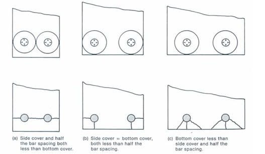

saikee said:
I think we can agree that in tension zone the rebar need to be gripped by the concrete to develop the full material stress in steel. I am not sure such adhesion between concrete and steel can be classified as the concrete tension.
It is tension. So called "adhesion" between the concrete and the bar depends fundamentally on concrete in tension. That is why concrete splits when a bar anchorage fails.
It's why you increase the anchorage length - to dilute the concrete tension to below acceptable limits.
"Adhesion" and concrete in tension are one and the same. Draw a Mohr's circle and you will see. The pure shear force has a corresponding tensile component. There's no way around it.
Likewise a concrete element in shear (e.g. a slab) has internal tensile forces which carry the load. They are there. Real tensile stresses/strains which carry your load back to the supports.
Don't kid yourself - you rely on concrete in tension all the time.

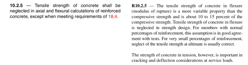

We should not have to argue something fundamental and published in the design reinforced concrete code. The one below is from ACI 318. This has never been changed between various national codes and is applicable in both elastic to limit state designs.
Yes, you must ignore concrete tensile forces passing thru a flexural or axial cross section. In those cases you cannot rely on tensile forces perpendicular to the potential failure plane to resist the flexural or axial load.
I'm referring to all the other tensile forces we rely upon. Concrete tension as a result of shear load. Concrete tension when developing stress in a bar. Concrete tension when relying on shear friction (which may end up breaking out of the back of your bridge deck if you're not careful). Etc.
