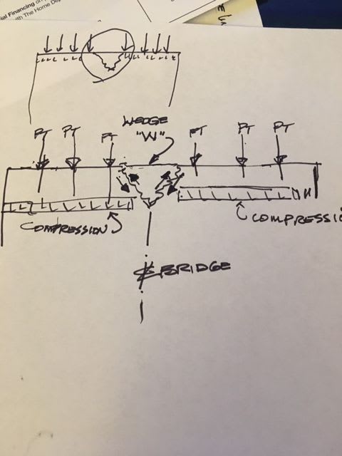

It seems to me that unstressed zones across the end of the deck create a bit of a problem. For instance, the "wedge" W in the sketch is not compressed but the adjacent concrete, particularly near the spirally reinforced anchors of the PT, is in compression. It seems there should be a transfer of shear across the sides of the wedge, where I have shown the little arrows.
This shear would be additive to any loads on the top of the wedge wedge which try to push the wedge out the end of the deck, right?
Are those shear forces from the "shear lag" of the PT forces enough to require consideration in the design?
Did they contribute to this failure? Can anyone do an FE analysis to evaluate this? It may not be significant, but I think it exists.
There is also a top-to-bottom shear lag present because the PT is near the top and the deck is 2 feet thick. That could add to the shear somewhere in the xone between the PT rods in member 11.
Thanks,
Vance

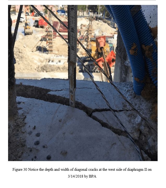

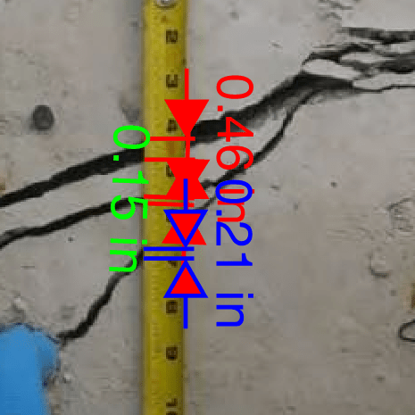

NO! That wedge/cone had punched out and was an inch wide crack! It's the failure itself. It's where the concrete has let go of itself. See here:
There is certainly no transfer after the crack is an inch wide. I was referring to a stress induced by the less than uniform compression created by the PT forces only and before any loads were placed on the structure. I was curious about the intensity of the pre-failure shear stress and I do not have a method to determine that stress. If it is anything significant the demand for reinforcing would be even greater.
What is interesting about that photo is the tape seems to be inserted right over the PT "D1" location - about 8-1/2 inches from the face of 12. The deck must have been delaminating at that time because the PT anchorage appears intact in OSHA photo 61-62-63 series.
Also the final outcome was already determined when that photo was taken.
Ahh, sorry.
With everyone (particularly FIGG) adding up shear capacities AFTER the deadly cracking had occurred I mistakenly assumed you were doing the same thing.
As for the shear strength along your 45 degree wedge, you could calculated it if you wanted. It will be a be slightly stronger than the flatter wedge that actually developed. The PT clamping force isn't really doing much for you though in terms of holding the wedge in. The crack went straight around the PT.
All is cool. Communicating this way is great but easily mis-interpreted. And I am far from good at typing and precise descriptions.
I am thinking about a condition like standing on a foam mattress with your feet maybe 18" apart. The foam will not be flat between your ankles - it will billow upward relative to the bottom of your feet. It will be lower than it was before you stood on the mattress, so there is some force pulling it down - trying to compress the unstressed part. That is not a particularly good analogy because there is relatively good tension available in the surface of the mattress which will help compress the 'billowing' zone, and the force is not only shear. Maybe a mattress with individual pocketed coils is a better example. I think we had one of those sometime in the years past.
The answer hides behind the elasticity in compression and shear, the dimensions, and the loads applied. I am too old to even start such an analysis.
I would like to see the result of such an experiment. Eg your sketch, pull the wedge out with the PT load on, and then repeat with the PT load off. Compare the results. How would that PT force affect the wedge failure? Would you get more "shear force" developing like in your sketch?
It's related to another topic of debate we have in our office regarding what the force does at a PT live end. How does it enter the concrete?, and at what angle?, and what sort of stress patterns develop in the concrete?

I have been trying to determine how much the 11/12 node moved horizontally and finally decided the wall thickness of the schedule 40 pipe was a good visual gauge. At .216 inches for a 3 inch pipe, the horizontal movement looks to have been at least 1/2 an inch in photos.
epoxybot said:
I'm beginning to wonder if Denny Pate didn't realize this and thought that by retensioning 11, he could recapture the shear lag set free when 11 was detensioned. It would kind of explain Pate's state of mind, believing he could fix it.
He seemed to realise though that he needed to strap the node to the next node?
Yes at least 1/2 inch. I read ~0.8 inch, ~20mm

Re: the Wedge and PT anchors
As you know, the compressive stress is quite high under PT anchorages, especially with a bugle and several strands. Even single strand anchorages at slab edges need a pair of rebars just inside the anchor zone.
I do not have a specific recommendation except to urge caution with PT. The PT loads leave the structure "alive".
With regard to the Wedge I tried to sketch, in my mind the wedge is not directly under compression but the concrete within the influence of the PT anchor forces is compressed. So to distribute compression to the wedge there would be diagonal tension across the diagonals of the wedge. Perhaps the strains are not great and can be accommodated without cracking. Maybe it can be checked with the "strutt and tie" concept, with struts just inside the inclined sides and a tie across the formed edge. And maybe a #6 rebar would solve it. Maybe I am unnecessarily concerned.
Thank you for responding. If you can see (visualize) strains, deflections, and load paths you have the skills most necessary in structures. Just do not ignore what those skills are telling you. And I don't think you are likely to do that.
