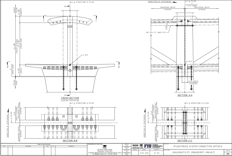

Could someone identify the elements/parts in the closure strip over the Pylon which will provide 2000 kips of tension tie between the north and main spans?
The above drawing shows the two spans would be eventually bolted together horizontally just below the roof. Each span also has its set of holding down bolts firmly fixed to the piers.
I believe there are also a couple of post tension cables as shown in Section C-C to tie the canopy portions together.
These are the old drawings as the "holding down bolts" moved right next to member 12.
Also these bolts are pretty puny - barely 1" diam with not much bearing surface. If this bridge wanted to do anything / move anywhere those bolts are not going to hold it together, especially when the bolts are at canopy level and the forces at deck level.
And there is a 3" "CIP" joint. That doesn't sound like a great idea.
saikee119 said:
,3DDave, & LittleInch
Thank you - that is about what I found - and I do not see anything that could come close to 2000 kips capacity there.
I am haunted by the suspicion that the designers thought the fake pipe stays were working components with the weight of the structure on them and the horizontal components of their tension forces would pull these two bridge spans together over the pylon with enough force to contain any blowout.
Of course that concept overlooks the period when the main span must support its own weight until the back span is complete.
Maybe that was just the best story they could conjure in a hurry.
