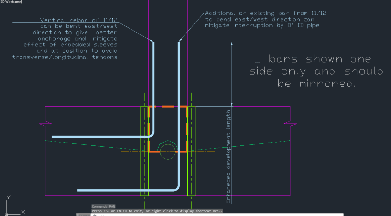

I believe most of us are quite clear about the failure but a few still talk about the lack of provision on the code, validity of using shear friction, guidance of joint selection/preparation etc as though the designer was confused.
What we had here is a simple connection failure. Had this been steel bridge and the members are structural steel the separation failure would be the inadequate welding or bolts to connect them together.
Since this is a reinforced concrete bridge so a connection failure is just the rebar inadequate or embedded to insufficient depth on either side of the joint or not enough concrete surrounding the rebar to develop the maximum steel stress. The photos have given the clues and confirmation. The OSHA report has declared the margin by which it was deficient.
A seasoned RC designer would be disturbed by the failed joint when seeing :
(1) The steel reinforcement is meant to connect the deck, 11 and 12 together so the design should have bar between deck with 11, 11 with 12 and 12 with deck. It did. However for such a thin deck logically some bar should be bent sideways (or use L bar instead of straight bar) to link the east, west as well as the north/south sides of the deck. There were no bar to link the east and west sides at all. The reason is the thin deck had been stressed by tendons in both directions leaving very little space for such purpose.
(2) The deck has a substantial diaphragm at the end. This 2' wide by 4' deep diaphragm potentially can provide enough rigidity for the connection if enough steel bars were provided between 11/12 with the diaphragm. Using some L bars instead of all straight bar would have a large part of the diaphragm to participate in the joint resistance. Again no such bar from 11/12 were placed to link the east and west directions of the diaphragm.
(3) Not using L bar is NOT a design shortcoming and so cannot be blamed for the bridge collapse. However the straight bar arrangement, straight in direction only as bars could have hooks or small L at the ends that are totally within the member cross section, was compromised by the four vertical sleeves and on horizontal pipe. These embedded items occupied 60% of the vertical and 40% horizontal bonding areas of 11/12 with the diaphragm. These embedded items also took away the possibility of passing rebar through this vital area. Had L bar been used the capacity reduction from these embedded items could have been mitigated because the lengths of the two Ls can be lengthened to allow for interior sections affected by the embedded items. Also L bars are effective when placed on top and below the horizontal pipe as depicted below.
We can all get wiser after the event but my point is the problem isn't high-tech but just down to simple steel reinforcement arrangements to anticipate points of weakness.

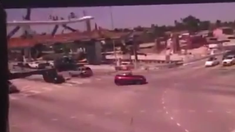

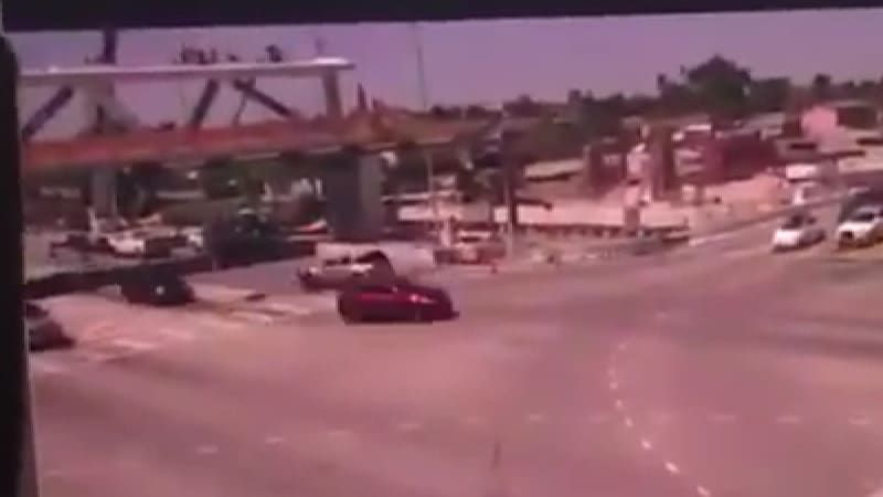

ADD: This video was analyzed quite a bit way back in Part 1, but here is my contribution.
EDIT: Added frame 049 and edited for clarity.
I created a series of 9 cropped and stabilized images from the traffic cam video that Miami Herald reporter Monique O. Madan posted on her Twitter account. The images can be downloaded as a single ZIP file using this link. The image names are numbered according to the frame number of the phone video.
Of interest: two consecutive traffic-cam frames (phone video frames 049 and 057) show that both the canopy and deck were cracked and falling while the canopy above member 12 hasn't dropped significantly (this was also observed in frames 76-77-78 of the truck-cam video, as noted in my post of 22 Jun 19 22:31):
The methodology I used is as follows:
[ol 1]
[li]Use VirtualDub to crop a 640x360 section of the original 720x1280 video, resize it by a factor of 400% using nearest neighbor algorithm to 2560x1440, and export a numbered image sequence. As noted in my post of 22 Jun 19 22:31, the nearest neighbor algorithm minimizes enlargement artifacts by duplicating existing pixels instead of interpolating in-between pixels.[/li]
[li]Select the 9 "best" consecutive frames of the traffic cam footage. This was difficult because the phone was not held steady, a person to the left was moving into and out of view, and the frame-rate of the monitor and phone were out of sync, causing subtle scan-line artifacts. In a few cases two traffic-cam frames were melded to create double-exposed or half-and-half spliced images, so I decided to not post a cropped video.[/li]
[li]Use IrfanView to incrementally crop the edges of the images so the final 1600x900 versions were aligned. None of the images were rotated for better alignment.[/li]
[/ol]
ADD: Here is a cropped version of the video - I'm pretty sure it used the same source.
It sure looks like 12 is flexing significantly. I've been thinking for a while that the concrete was much tougher than I gave it credit for.
MikeW7 said:
which shows that both the canopy and deck were cracked and falling before member 12 was pushed off.
I would argue this conveys imprecise understanding. It is totally expected that canopy and deck would move before you see any movement at base of 12. All it takes for deck and canopy to move as shown is for compression in 11 to no longer counterbalance tension in 10. Member 12 Node 11/12 does not need to be kicked out for this to happen. Member 11 only needs to be displaced or crushed shorter in the order of millimeters, and that is not visible on camera. A computer animation of collapse with millisecond by millisecond forces would make this point clear.
