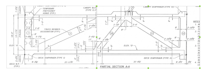

The neighboring compression in the concrete may be different near each rod, but the extension of each rod should be the same for the same applied tension. Since the amount of concrete the rods pass through is majority in the diagonal even the differences in the deck area are small contributors; possibly a few percent.
One thing I've been wondering: Why did both ends of the bridge not crack similarly? And can anything be learned from the fact that they didn't?
Up to a point, it seems they did. On Feb. 6, 2018, Bolton Perez & Associates performed a visual inspection of cracks on diagonals 3 and 10 after PT bars tendons No 2 and No 11 were stressed. They stated, "We believe, this first stressing operation has temporarily created tension on members No 3 & No 10; thus, creating cross sectional cracks transferring the tension loads to the steel on these members." (p. 1, FIU Pedestrian Bridge / BT-904 Crack Inspection Report). The OSHA report then indicates that on Feb. 26, after hearing a loud popping sound when the shoring under the span was removed and it was self-supporting, "The employee from the TSG and one of the employees from the MCM walked over the bridge and noticed cracks at the bases of diagonal 2 and 11." (p. 24).
Thus, up to a point, the span ends seemed to be responding similarly to stresses. However, after the move and then the de-tensioning of 2 and 11, that clearly wasn't the case, with only the north end developing progressively larger and, frankly, scary cracks. Is it clear why? Was it because diagonal 2 was much beefier than diagonal 11, with different geometry and maybe more rebar? Or because the deck ends were different, with the north end less reinforced? Or because the north end was moved much farther, over a bumpy median and was also cantilevered farther from the supports? Or because the south end of the span was designed as the actual end of a bridge, and the north "end" was intended to be a temporary intermediate construction phase? Or some combination? Or something else?
I apologize if the comparison of the two end responses has been addressed earlier, or if the question is just plain dumb. I'm not an engineer but I worked with engineers and obtained environmental clearance for many federally funded bridges, so they got used to me asking dumb questions!

@saikee119 - Thanks for your response. Modelling unconventional use of rebar might be unconventional or just darn near impossible. I've been thinking out loud and trying to incorporate what I see or don't see into a better understanding of the collapse. My model may not be perfect but it is a work in progress and I welcome anyone to critique what I put out. I'm learning a lot from these threads.
I accept your analysis of the shear planes wholeheartedly because it moves past a lot of what obviously wasn't happening, shear planes that weren't working as such. This allows for more freedom to consider why the bridge would creep for almost a week (if not from the very time the scaffolding was removed) without collapsing. As I looked closer, I noticed that even your concept of plane B, which is perfectly sensible, may have been an illusion. That is not to dismiss your work, but to further embrace it. If it turns out that the design of the north end of the bridge is just an illusion, so be it if that is where the evidence leads. Key design elements are absent and those that are present are pressed into unconventional service ... for a time. I'm hard pressed to accept simple answers, especially in complex circumstances. OSHA's explanation, though it maybe perfectly valid, does not seem fully developed and that opens the door for speculation or preferably a fuller analysis of the matter.
My earlier analysis with a torque element and the door closer was an idea for an explanation of the slow motion train wreck. If all of the conventional door stops are removed, it seems to me that what we are left with is one or two feet of the diaphragm and 12 fully and coherently bonded, with the rest of the structural elements free (cough) to move and straining under loads they were never meant to carry. I did not suggest an ultimate failure mode because once a run away condition is described, the final collapse is a moot point. I could be wrong.
One thing I forgot is that when the north end of the slab slipped off of the pylon, it seems to have sheared the two hold down rods. That would knock a bunch of concrete off of the bottom of the diaphragm.
Anyway, thanks again and I look forward to all of the posts.

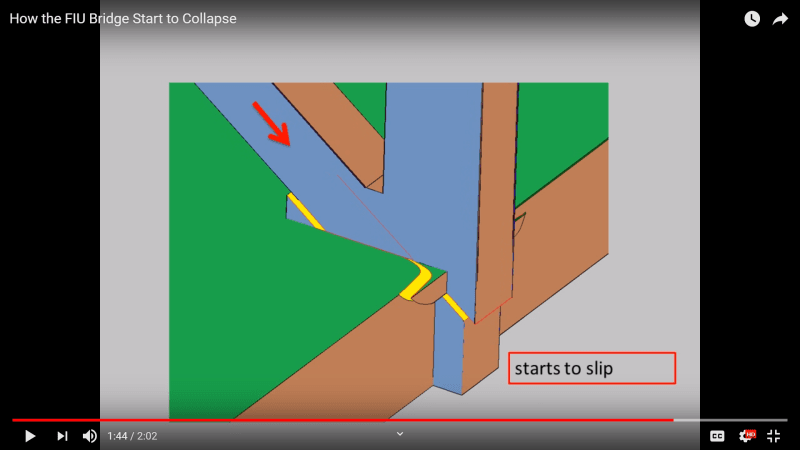

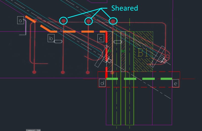

Wetlander (Specifier/Regulator),
The point why the north end crack and not the south end has been raised before in this forum.
The answer was south end has a stronger joint. Although its vertical column is only 5% larger but the 3' diagonal is 50% larger casting with the same deck. There are more rebar and some of them could be placed in more strategic locations than the north end. The diagonal load on the south end is higher though.
jrs_87 (Mechanical),

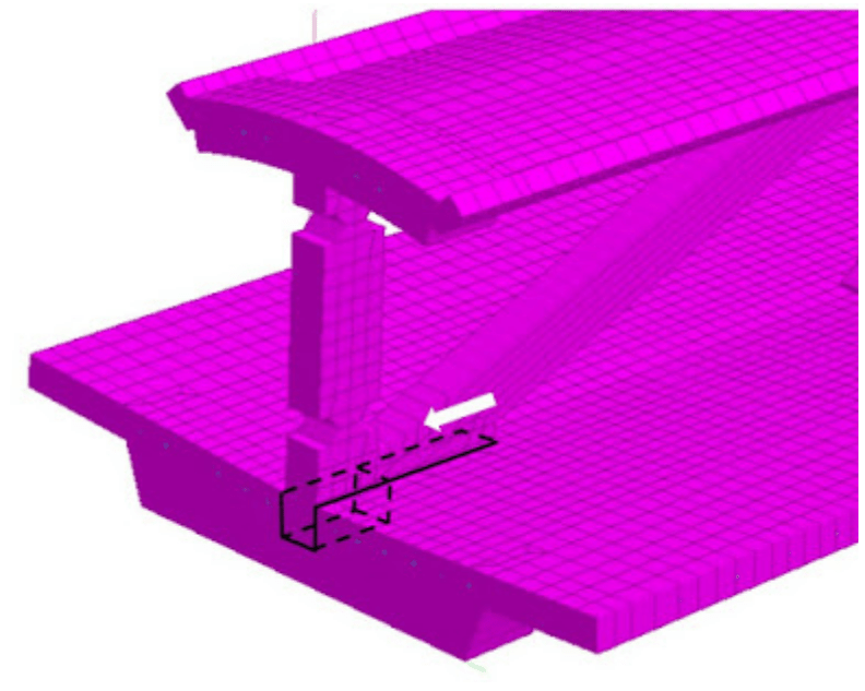

Thanks for the link. The link has this diagram.
which is what I have predicted and shown in the CAD figures. The above 3D diagram is on the south and not the north end.
I think people slowly realize the deck was pulling away with the force equal to the horizontal component of the diagonal member axial compression and the connection surface wasn't generous. especially at the north end.
saikee119 (Structural)30 Jun 19 10:25
Saikee, I'm glad for that image too. Link below is for an old animation that is good in another way. Now, what we need is a true-to-life translucent solid model that can be rotated, sectioned, and animated. Ability to highlight separation interface would be a plus.
Hopefully, precisely how the PT bar tension reversals affected the area will soon be satisfactorily explained.
Source: 1:44 mark (please read screamdoctor comment below video)
I don't think the entire node slid together as shown. North face of 12 and diaphragm cracked and flexed at first while holding 11 back. The discrepancy of displacement accounted for by internal crushing and rotation.

Bottom of Pg. 84 of the OSHA Report: As a result of the blow-out, three #7 shear reinforcements at the construction joint of diagonal 11 and the deck were sheared but the southernmost shear reinforcement remained intact.
It would have been nice to see a photo showing the full CJ contact surface, after the large debris had been removed. The southern most rebar was supposedly in the crack "separated" chamfer in the 11/12 node.
Something to be considered, the inspectors for Bolton Perez and Associates, Inc., were hired for their knowledge and experience in oversight of the new work. When cracking became a concern, someone experienced in making assessments of cracking in concrete should have been sent out to access the work, even if it meant contacting a third party. If your firm doesn't do remedial work, then they need to recognize when they are out of their depth and get a qualified opinion.

I've been following this discussion since shortly after the bridge collapsed. Impressive work, gentlemen!
I would have like the investigator to study carefully the first set of photos to arrive at the probable cause. He/she then returns the next day to concentrate on the selected sections/portions, clear debris to get to the bottom. He should return as many times as needed to capture all the important information before the site is cleared.
I am amazed at no photo available to show the east side of the diagonal 11 after the collapse. It had a massive longitudinal crack.
Sheared off rebar was described by OSHA but without photos showing what happened after the debris and dust were cleared to show the naked steel. Shots should be taken to cover the full extent of the CJ.
The true cause of the collapse would be self evident if there are sufficient photos showing each remaining rebar to allow its bar mark to be identified accurately.
It is quite possible OSHA has access to a lot more photos and published only few good ones with the report. In the digital era I myself often take 10 times more photos than needed for a report.
