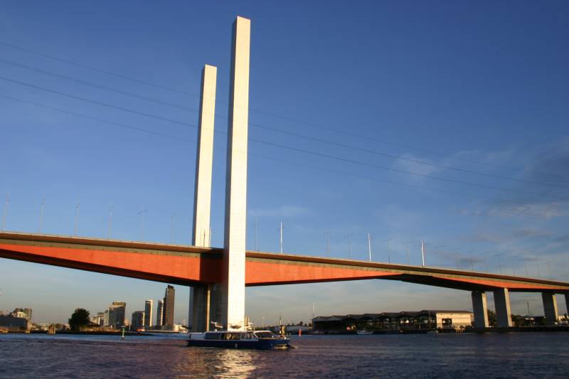

The faux pylon and stays were tacky from the start, but in light of the collapse and the loss of life they seem a particularly unfortunate choice. I'd guess that functional stays and pylons would have been much more expensive, but suppose the faux counterparts had been omitted in favor of more effort and material in the primary structure. It can't have been a trivial matter to design the stays and pylons given that wind loading would control, so there might have been a substantial trade-off in favor of artistic factors.
I agree with their tackiness. In our built environment there is often a role for function and style to go together. But it becomes particularly clumsy when you have items that are fake engineering solutions. Either make the engineering beatiful or add some superfluous form to the structure. But when superfluous form that attempts to mimic engineer is just bad architecture.
This bridge is the same:
I agree those towers are silly. Even my wife said when we first saw it, "What are those poles for?"
For those who don't know, that is the Bolte Bridge in Melbourne.
Interesting towers. At least they give ships an idea where one pier is while still far enough off for that information to be useful.
They should add some vertical windmills to the towers. At least it make more sense. Nice laminar air flow over the water. My personal aesthetic is to make the architectural components functional. However, I also think aesthetics are very important. I find completely utilitarian urban landscapes very depressing.
The pylon and stays are essentially a form of sculpture and artwork. We pay for public artwork and this really no different. That doesn't mean all public artwork projects are successful.
