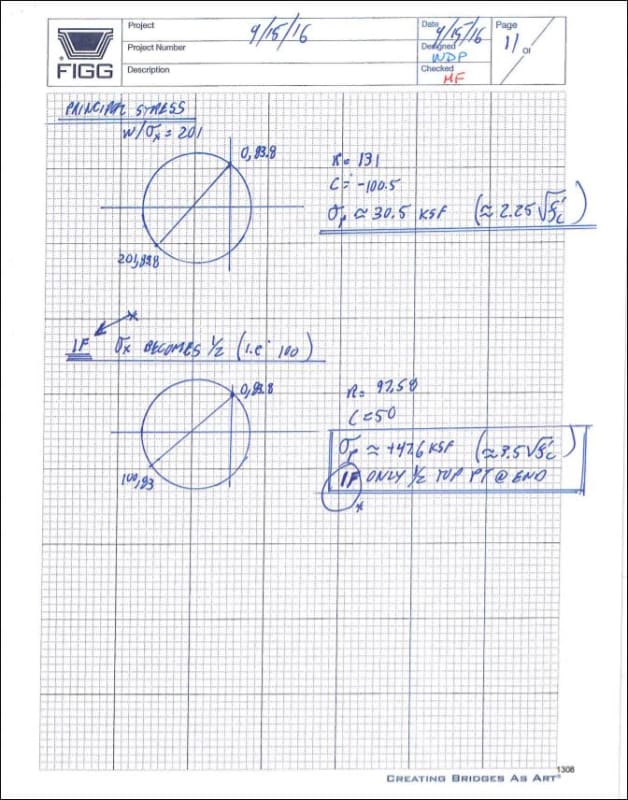

NTSB Meeting - staff reporting - 49:00 or so
Showing 4 diagrams which represent the 4 analyses made by FIGG.
Note the "Fixed Pylon Mainspan Only" - shows the main span only with no back span. It also shows the Pylon cast full height and the faux stays in place. This can explain the terribly low shear results at node 11/12.
Have always wondered how the shear at the top of the deck could be so low at 11/12.
In the model they show, the stays are NOT faux - they will be found ( I am betting here ) to have considerable tension and are holding up a lot of the bridge weight.
This is a good idea - check the maximum load that could happen to the stays and pylon in bending.
It is a terrible idea to use for design of the main span of the bridge which must be self supporting for months without any contribution from the pylon and stays.

I think the "Fixed Pylon" analysis may have modeled fixed anchors with no dependence on pylon bending. I can't read the input. Do not know how to find pieces or nodes.
The back span pipes would have provided relief from moment in the pylon. Not all, but a significant amount.
Modeling the pylon for bending cantilevered 90 feet or whatever without stays to the north span would be unrealistic because the bending would have released tension in the south stays and reported lower loads than the stayed full length condition.
The "Fixed Pylon" model is not a realistic condition but it simulates worst case conditions for the pipe "stays" and maybe the pylon, and should draw load to the north end of the main span (pylon) because of the fixity.
EDIT I have to wonder if it was modeled with no dead load and stays in place - as if it had shores in place until the pipe stays were tightened. That would be impractical and unrealistic, because the structure will have dead load deflections in place when the pipe stays are installed. So realistically, only live load and creep will load the pipe stays. But the load reported for 11/12 sliding is too great for Live Load factored and adjusted for simple fixity ( that sounds like a contradiction ) at the pylon.

That's true after the bridge is complete - the analysis was for only the span and the pylon if I've understood what was written here.
"Note the "Fixed Pylon Mainspan Only" - shows the main span only with no back span. It also shows the Pylon cast full height and the faux stays in place. This can explain the terribly low shear results at node 11/12."
978kips shear demand at the node!? Where is the sanity in that. A first year engineer should be able to tell you that doesn't make sense given the unfactored dead weight alone.

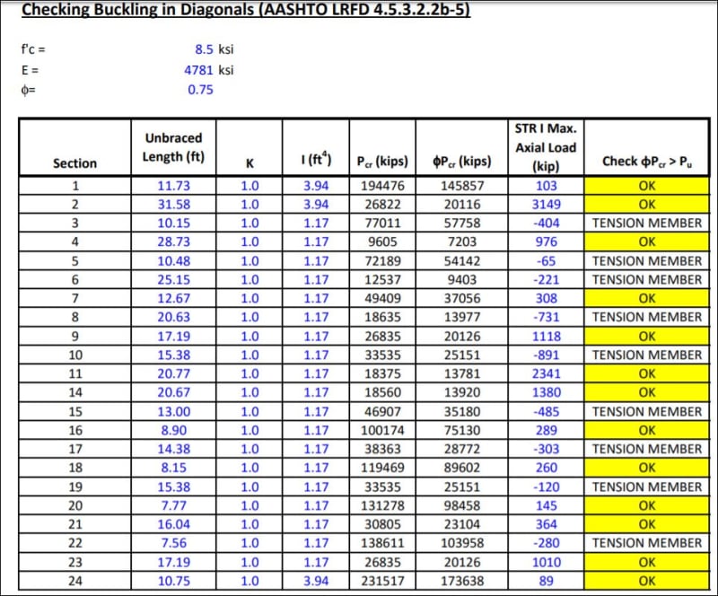

What is Pcr in concrete column buckling?
Help me, group. I am trying to find why there is a Pcr for a 21X24 concrete column that results in a stress of 36 ksi. Scan the attached pic from FIGG calcs pdf sheet 1128. They are checking buckling.
However they are doing it, member 11 gets a Pcr = 18375 kips. Yes - it says 18,375 KIPS.
That is 18375000/(21x24)= 36,468 psi. What kind of value is that? The concrete blew up at 8500 psi -
Does that mean the concrete can be stressed to that value before buckling is an issue?
If that is the case, it just does not look like a number that should be generated. Some analysis guy might use that for a divisor.
For whatever load case this might be, the axial load in member 11 is reported to be 2341 kips factored.
Pcr is the Euler buckling load which is simply = π2EI/L2 - it has nothing to do with material strength.
If you substitute in FIGG's values for Member 11 of: E = 4781 ksi; I = 1.17 ft4; and L = 20.77 ft, I calc Pcr = 18,430 kips.
The load case is STRENGTH I.

Vance Wiley (Structural)30 Oct 19 05:43
Thanks for the post.
Now we know of another place where we have a number for the #11 strut force in FIGG calcs. It can be used as areference despite the fact that may contain a large live load instead of the small construction load and it may refer to the completed structure. Using a 32° angle, the Strength 1 load of 2341 kips gives us a shear load of 1985 kips vs the 987 kips used in the connection evaluation.
FIGG had calculated adequate numbers in their analysis but they were never used. THIS IS NUTs!!!!
