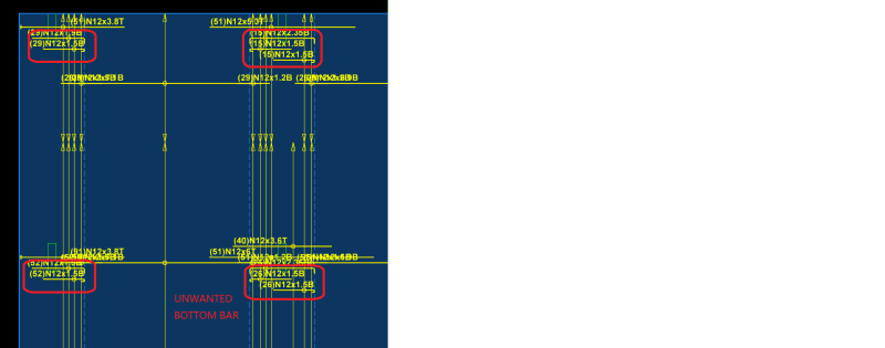

Hi all, I have question in regard to modeling band beams in Ram Concept.
Basic Info:
8.5m x 8.5m grid with 2400mm*500mm (D) running in longitude direction.
Band beams are defined as standard beam element with 'meshed as slab' option unticked while slab is defined as one way slab.
Longitude column strip is set to be T-Beam with 'design column strip for column + middle strip resultants' selected. Latitude design strip is set to be one way slab rectangle.
Questions
I want to design slab together with band beams in Ram Concept (strength and service including long term deflection).
The reinforcement plan in Ram Concept produce 'unwanted' latitude bottom reinforce in band beam area (refer below pic 1). I understand that from analysis results there will be moment in that area in that direction which is why reinforcement is produced. However, I want the band beam to be design as 'one way' without transverse bars detailed as below (pic 2). (no even ligs unless the concrete shear capacity fail). So what do I do in Ram Concept to achieve what I want?
pic 1 : Unwanted latitude bottom bar in band beam
pic 2: actual detail I want to design for slab-to-beam
Thank you.
Below is the layout plan.
I have also circled the 'unwanted' latitude bottom bar in band beam as below

Hi hokie66, this is in regard to Ram Concept but I think it applies to other FEA packages. I am not sure which part is nonsensical to you, can I kindly ask you to elaborate? I am not relying on the software to make reinforcement sections. What I want to do here is I want to design it in a traditional way: band beam supporting one way slab without any bottom transverse bars in band beams. However as I assign the slab as a whole there will be bending moment across band beam which will force the Ram Concept to place bottom transverse bars across the band beams so I am wondering what changes (if possible) can I make in Ram Concept before analysis and design. I am using it to check the long term deflection which can not be done by hand (at least not when the structure becomes more complex) and the way I design it (not limit to these transverse bars) will affect the results I think?

There is bending moment across the band beam, but in the bottom, it is in compression. No reinforcement required, except some support bars to keep all your longitudinal bars in position. But I should defer to others, as I have never used a finite element package in the design of concrete slabs.
Yeah. You are right. Forgive my stupidity on this. Wonder why Ram Concept still produce bottom bars in these areas then. I do think of one scenario when there are way stronger supports paralleling to band beams on both sides of them then there might be some positive moment across band beams but this is not the case here/.
Those bars are being added to fulfill minimum steel requirements for the larger cross sectional area of the beam. Increase the support width for the one-way slab strips so the first and last design sections occur at the faces of the band beams. Also make sure torsion for the design strips is not set to "none" unless you have defined both the slab and beams to be "no torsion", there is a chapter in the manual on the available options.

To verify why those bars are there go to the bottom reinforcement design status plan and in the options, eye ball button, check the box for controlling criteria, the governing code section will be added to the bar tag.

Defined as a beam or not doesn't matter for the slab strip. Assuming your slab design strips are the latitude strips, if you go into the strip properties I'm guessing they are setup with the design system as one-way slab and not beam. If you have not defined the support width to be equal to or wider than the "beam" then you are getting a design section inside the beam perimeter which has the depth of the beam, increasing the cross sectional area thus increasing the minimum steel requirement. The default behavior for slabs is to place minimum steel on the bottom face and the strips in this direction are set to follow the slab design rules.
You are seeing multiple sets of short bottom bars because of the cross section trimming, where the program gradual steps the effective section depth along areas of soffit changes in successive design segments.
Audit the cross section and step thru the report it goes thru the programs design process and gives you the cross section dimensions being used for design.

Okay. Now this make sense to me. Just expected the latitude design strip would recognize where beam is and not apply the design rule for slab in that area. Thanks you very much.
