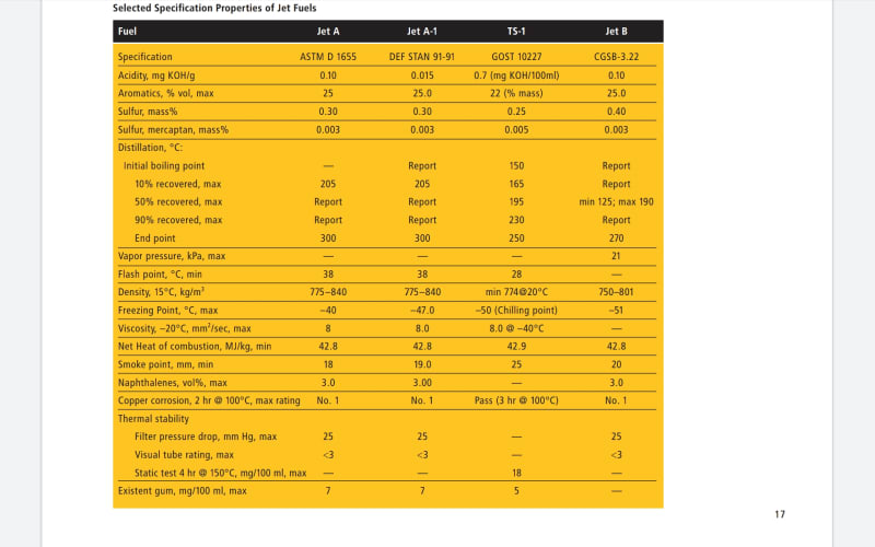

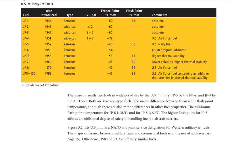

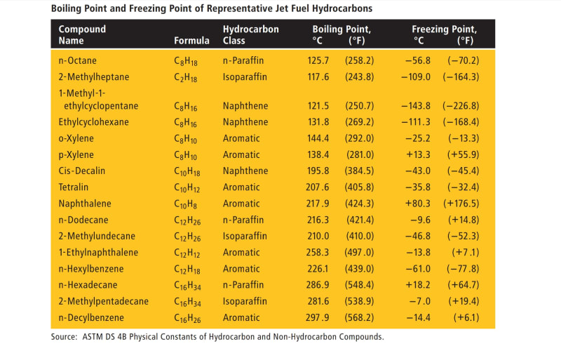

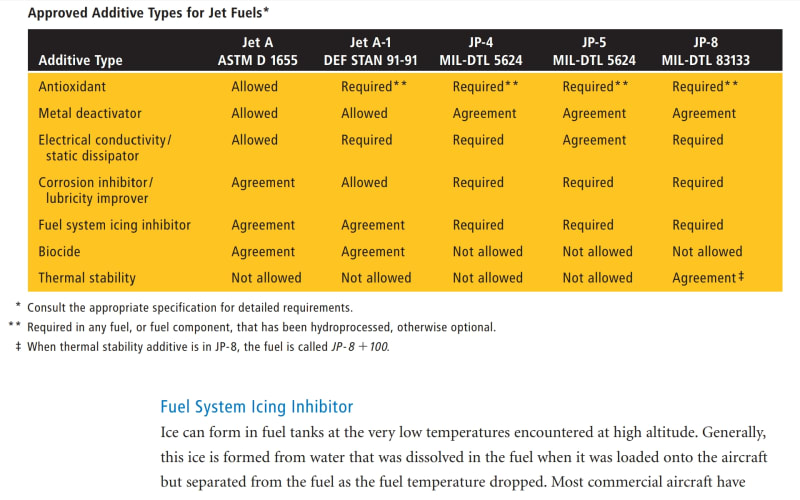

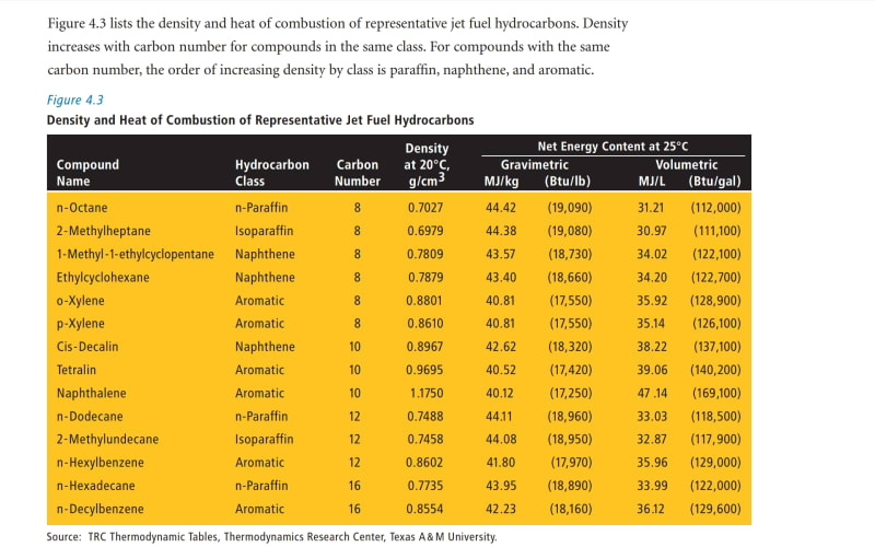

I thought we were talking about what the US Navy might be storing-transporting for themselves and perhaps others. What they burn is not the issue and Sparten is correct, there's a wide blend that includes significant hazardous components across the continuous range of specific gravities making up them all. All the JPs are basically the same, except for their various additives and Jbase is sometimes almost gasoline and sometimes almost diesel. If its not lite enough to be JP yet, we blend in more gasoline until it is. Too lite, add diesel. The rest of the spec is storage, handling, contaminate related more to quality control issues rather than its specific gravity.
All of the different "flavours" of mil fuel that have been talked about.
I would say none of them you would want to wash in or drink.
I must admit though I never really understood the difference between kerosene and diesel.
I know the turbine fuels don't have lubricants in them. But pretty sure that doesn't make them anymore digestible.
