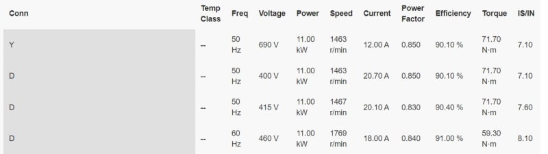

Why do you think this is happening? Originally this Servo press was designed to be installed in a country that uses 50 Hz. However, the motor seems to be ok to run at 60 Hz according to the name plate
And the datasheet for this motor. Could it have something to do with us using 410 VAC? Or perhaps the settings on the soft starter?

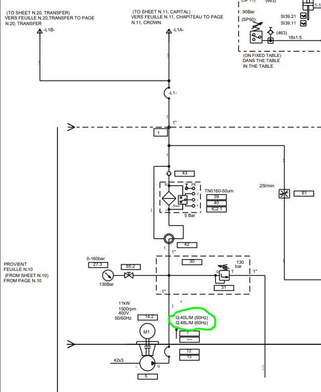

One difference is that you have 20% more flow from the pump since the motors rpm is 1765 instead of 1463 which mean you will have a higher back pressure in the hydraulic system too, especially if the oil is cold, but since it trips after restart it's probably not a problem with cold oil.
If the pump or the system have any kind of pressure reduction valve maybe it isn't large enough to handle the extra flow?
Hard to say without a hydraulic drawing.
I think if you can measure the pressure in the luberivations system at startup and also the start current that might tell you if this is the problem.

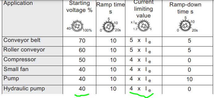

According to the manuel 13.2.2 the Current limiting should be 4 and Starting voltage: 40% but of course it's just a recommendation.

It looks like the system is made to be able to handle both 50Hz and 60Hz running.

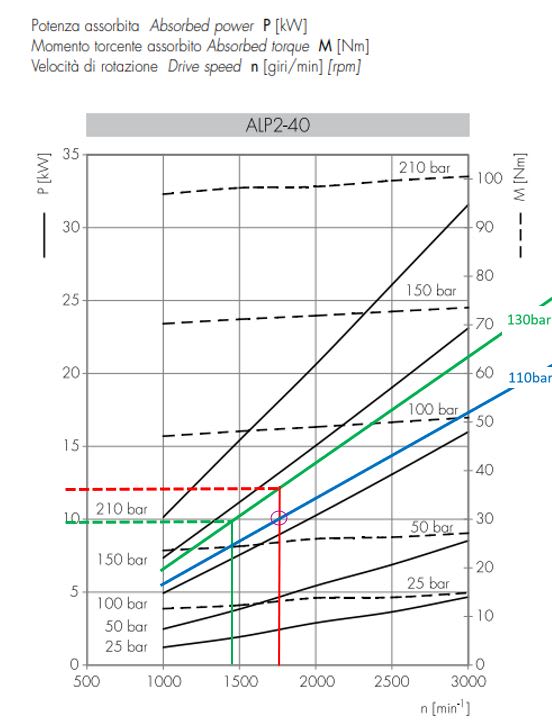

Pump pos 5 ALP2-D-40 MARZOCCHI
But according to the pump manufacturer the absorbed power at 130 bar is around 10kW at ca.1476 rpm.
But as high as 12kW at ca 1765 rpm, meaning the motor is running at max at all times if the pressure is at 130 bar which you also show on your amperemeter in the photo 21.11Amp.
Even though the motor should run at max 18.8 A at 11 kW.
I would start by measuring all the pressures to see so that everything is set right.
You should have 60 bar at measure point 32.8
And no more then 130 bar at measure point 27.3 not even at startup.
And if you bypass the filter at pos 42 the pressure drop should be less then 5 bars at manometer 27.3 otherwise your filter is full and the filter guard is not working right.
But I think your main problem is that the the pressure limiter should be set to 110 bar or something like that so that the power outtake is in line with the motor power.
You should ask the press manufacturer if there will be a problem if you set the pressure limiter pos 31 to ca 100 - 110 bar.

It seems strange that the motor nameplate shows higher max current at 50 Hz than at 60 Hz.
Intuition says that there will be more cooling at 60 Hz to possibly allow a slightly higher current at 60 Hz speed.

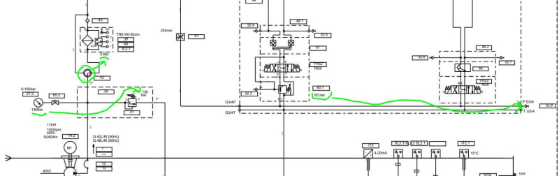

In the last attachment that I just uploaded, the pressure in picture 4 has to be showing 1750 psi and it will not climb until we turn off the overload button noted in picture 5, which dumps the back pressure so it can rise. (at least that is what the press operator told me), and this is an unconventional thing he does to get the pressure to rise so he can reset all the lube faults and get the pressure reading to start showing in the screen on picture 3 under the collum Real.
I wish I understood more about the hydraulics. For now, I will spot measure all the pressure points Redsnake suggested and compile a report and send it to ARISA and Nidec.

His setting is 50%, 40% was suggested in the Siemens manual for hydraulic pumps.
Maybe setting it up to 55%-60%
Maybe even shortening the ramptime a bit.
And the setting for Motor current was 25A should only be ca. 18 A
Another funny thing is that according to ABB there is no values for 60hz 415 Volt
Only for 460 volt.
At 60Hz 460 volt the motor can deliver 59.30 Nm I am guessing it is the same at 410 Volt.
The pump needs around 63 Nm to be able to deliver 130 bar.
At 50 Hz the motor will give 71.70 Nm which is enough.
Still think the max pressure will have to come down for this to work.

So why is the torque the same for all 50Hz applications on this motor?
NAFO Sergeant Anna Gr 69th Sniffing Brigade
What if I run a separate feed just for this motor? A 480-volt feed to the top of the motor starter that feeds the soft starter. "Would the difference of 20 VAC be a problem?" It is not Delta, so there is no wild leg.
Of course, after I first verify the pressure readings and if the manufacture agrees, then change the settings from 130 bar to 110 bar.
By the way, it is not a servo motor.
"So why is the torque the same for all 50Hz applications on this motor?"
Because Power ∝ Speed x Torque. Since the power and speed (or Hz) remain the same, torque remains the same. That table merely shows how the motor can be configured for different supply voltages for the same speed (or Hz) and KW.
