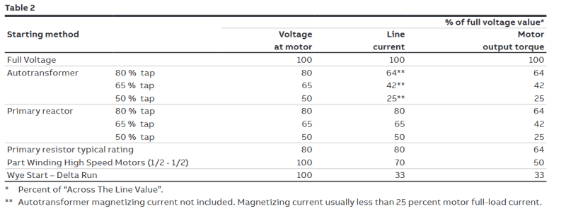

Low voltage hint: Look at this table from the Cowern papers to see the effect of low voltage on starting torque:
The motor is being fed with 410 Volts at 60 Hz.
It should be fed with 480 Volts at 60 Hz.
410 Volts is 85% of 480 Volts.
The torque may be expected to be .852 of rated torque or 73% of rated torque.
The starting torque of a design "B" motor (the most common design) is about 150% of rated torque.
73% of that is 109% of rated torque.
The pull in torque may be as low as 120% of rated torque.
At the reduced voltage the pull in torque may be expected to be about 88% of rated torque.
A positive displacement pump starting against back pressure is basically a constant torque load.
That marginal 109% torque will be further reduced by the soft starter.
If the motor even starts to turn it may be unable to get past pull-up RPM before the soft starter nears the end of the start-up ramp.
By that time the I2T of the locked rotor will be at or close to the trip setting.

Still periodically tripping the soft starter. Nidec & Arisa are not working on it, onsite and remotely. I believe we need to do one of 2 things, use a VFD or bring in 480 VAC and tune the soft starter or replace it with another one with a higher volt/amp capacity. I do not believe they will be able to tune this one.
The basics of frequency conversion: Keep the Volts per Hertz ratio the same.
You have increased the frequency in the ratio of 60Hz:50Hz or 6/5
You should increase the voltage in the same ratio.
6/5 x 400 Volts = 480 Volts.
With 480 Volts you will have the same torque as produced at 400 Volts, 50 Hertz.
By the way, the HP also changes with the change in frequency and voltage.
With the same V/Hz ratio (480 Volts at 60 Hz) the motor will produce the same torque but turn 6/5 times faster.
When you supply the motor with 480 Volts, you probably won't have to worry about hydraulic circuits nor pressure settings.
