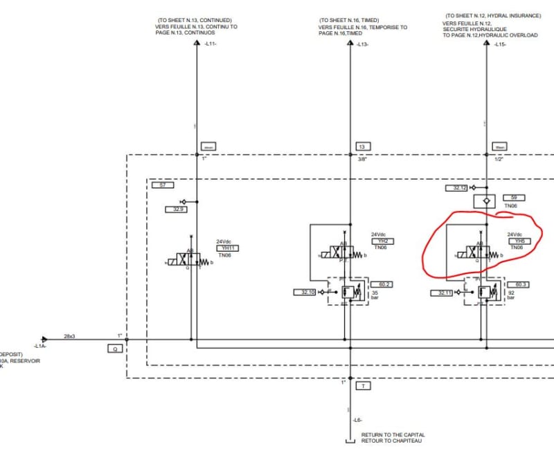

Well this overload system I didn't see that it was connected to the same pump as the lubrication.

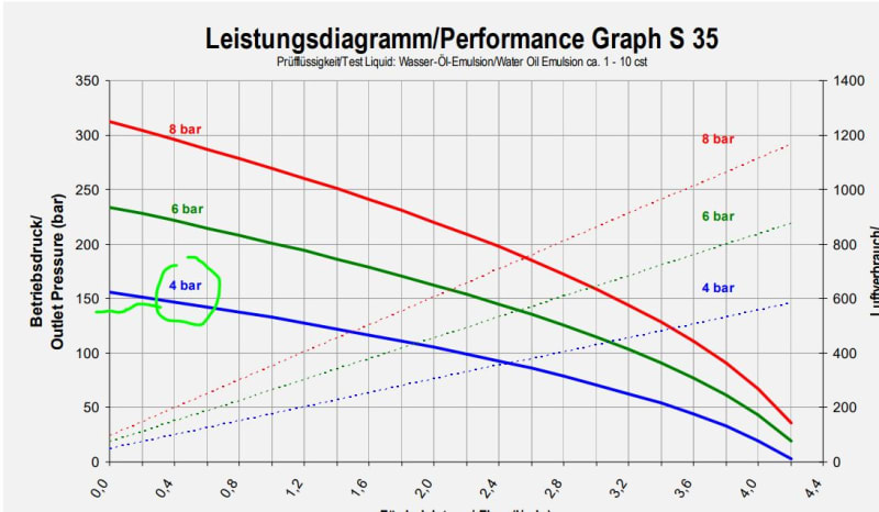

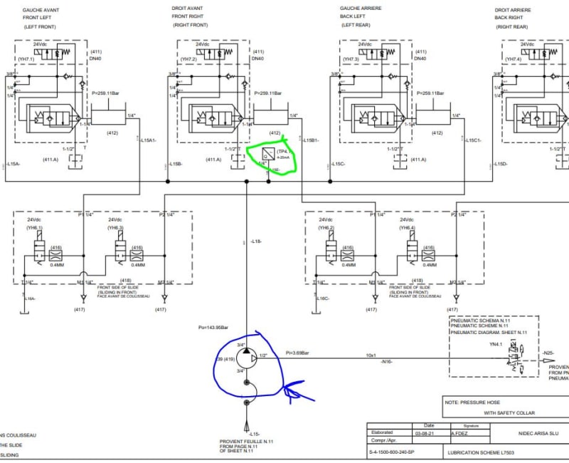

Looking at the hydraulic drawings I can't see a good reason why the soft starter doesn't not trip if you turn of the overload system, unless you have to little oil in the system all together and the cylinders re drained back to tank when you turn it off, but then you should have other fault messages.
The 1750 psi (120bar) the operator says he needs that is shown here (green)
does not come from the 11kW pump but is produced by the maximator pump here (blue)..

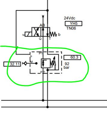

Now I am guessing since I do not have the PLC code or the electrical drawings, my guess is that when you turn of the overload till valve is closed meaning you do provide oil to the overload system, whether or not any oil is drained out of it and back to the tank I don't know?
It still doesn't explain your problem with the tripping of the soft starter and why it doesn't with the overload system off.
At first startup and if the overload cylinders are empty it will ofcourse take a bit longer to fill them up and then oil needs to be shared with the lubrication distributors and it will take a bit longer to get a signal back from all of them that they are functioning and ready.
But this in itself should not make the soft starter tripp.

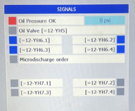

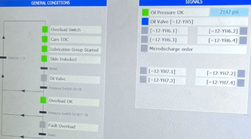

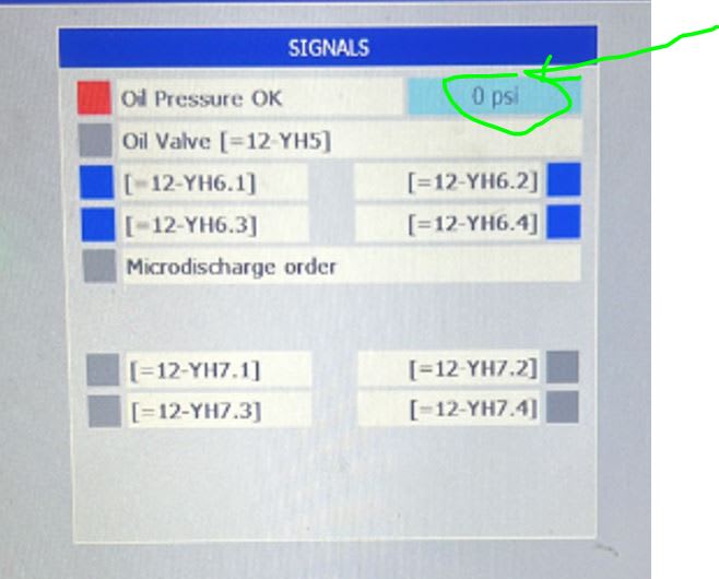

I have attached a picture of the actual after reseting by the OL switch, that in turn dumpted the back pressure, then the overload on the soft starter would not trip. They were able to bring the press up after that.
 https://files.engineering.com/getfile.aspx?folder=bb6ad835-6541-424e-b7d1-3c85bb4bd2cf&file=Screen_shot_of_pressure.docx
A combination of low voltage and starting against back pressure.
That is a recipe for overload trips.
An analogy may be a domestic refrigerator that will not start against back pressure but will trip the thermal protection repeatedly until the back pressure bleeds off.
An added line of code to dump accumulator pressure before starting may be part of the solution.

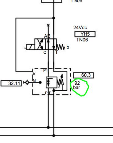

Hmm not sure I actually understand what you mean by "reseting by the OL switch" is the OL switch this one?
From the general condition chain you need the following (Of Course without PLc code or El circuit drawings I am "guessing")
Overload switch In ON position.
The cam/ram in Top Dead Center (TDC)
Reply from all lubrication distributors that they have received oil usually done with induktiv sensors felling the main piston going up from the oil pressure.
The ram needs to be unlocked.
Then when all this is okey there might be two options..
Either it is the PLC that sets the oil valve =12-YH5 when the above the conditions are met.
Or the operator are supposed to push the Reset button seems less lightly though..
After this point the "Oil Pressure OK" value should show ca 1335 psi (92bar)
And keep on increasing up to the value set to say "Oil Pressure OK" 2147 psi (148 bar) or whatever is set in the PLC,

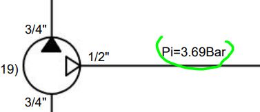

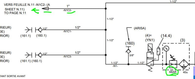

But this increase from 92 bar to > 148 bar is done by the Maximator and it needs air pressure to do it.
According to drawing 3.68 bar which seems correct if you truly have that.
Hmmmmmmmm... I think I see why this is happening......

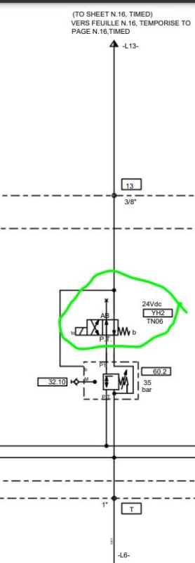

In this picture the valves have emptied the overload cylinders.
So when you start the pump again they need to be filed up, as long as the the flow have somewhere to go the pressure increase will next to nothing much lower than 92 bar at pos 60.3 if it takes longer to fill up the cylinders and start pressure than it takes to start the pump the soft starter wont tripp.
Another way of solving this at least until a permanent solution for the root cause is fixed would be to set this valve YH2 for the ram balancing cylinder to 1 for 10 seconds when the pump is started the the back pressure would only be 35 bar.
It might not be right but I think it would work.

And yes, the over load switch is the one you showed the picture of. After setting it to the off position for 20 seconds and then back to the on position, they was able to run the pumps and group lubrication circuits without tripping any overloads, hense, the OL switch dumpted the back pressure.

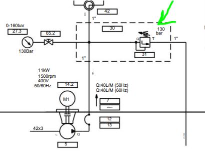

By the way, the back pressure reguator is set to 121 bar, not 130 bar according to ARISA's drawings.

I do not think you will have a problem with the lubrication if you turn the pressure down until you get around 18 Amps on the motor.
The function that requires most pressure is the overload system and that is at most 92 bar so you can't go lower than that.
Or actually you could if needed, the maximator would still build the same pressure but it would just take longer.
But I don't think you need to go that low.
The pump have a flow of 48 liter/min at 60Hz
All the lubrication distributors together needs 2.166 liter/min.
300 cc/min *6 + 240cc/min + 58cc/min + 68cc/min.
So you will still have more than 45 liters/minutes for all other functions and that is still 5 liters more than the total if you had, had a 50Hz system.
