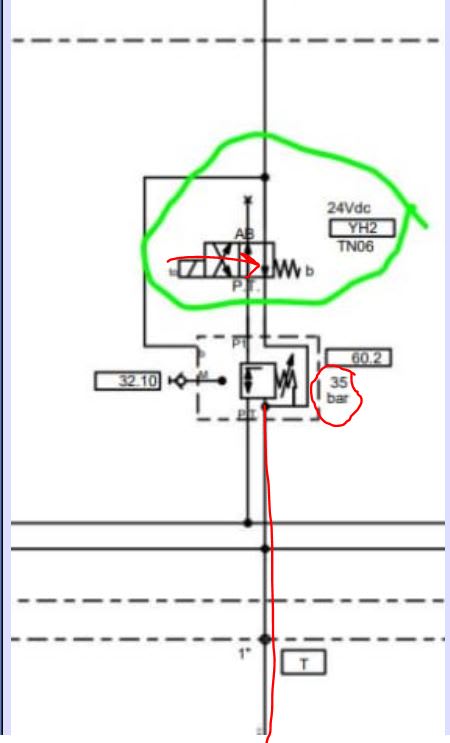

Well this dumping of the back pressure via the overload cylinders, even if it can be done it's time consuming and takes energi to have to fill them up again every time.
They should really never be dumped unless the ram can't turn in bottom dead center.
They are there to protect the rods and mechanic of the press if there are double sheets or the wrong die is inserted.
It would be much more effective to allow the YH2 to be set while the motor is starting then the back pressure would only be 35 bar and the balancing cylinder only takes 68cc/min so 10 seconds more or less wouldn't be a problem.

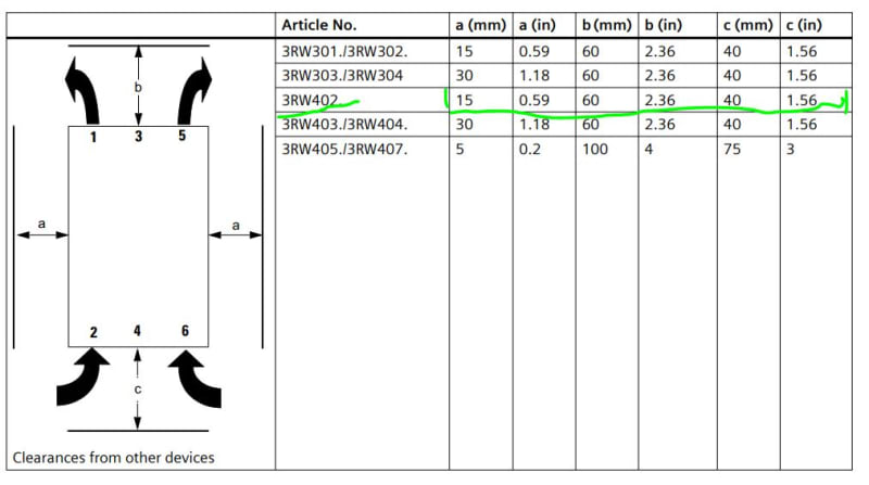

And also according to the Sirius manual you might need to give the softstarter a bit more space, don't really think this will solve the problem all together but it would be nicer for the starter.
With this soft starter you can't start the motor more than 5 times in an hour, when you where testing this new settings could it be that you didn't wait euomough between the starts to allow the soft starter and motor to cool down and that might have made it tripp?

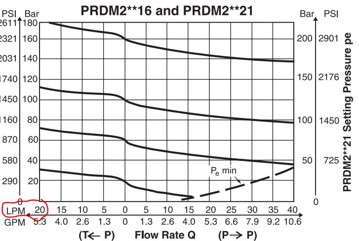

In this system you have 4 pressure reducers.
1. pos 30 (130 bar) now 105 bar it is there only to prevent the motor or pump, in this case the motor to overheat or draw to much current, it is like a hydraulic safety valve, isch..
2. pos 60.1 (60 bar) for the table looking it is only at 60 bar when you want to drive the table out when doing die change.
3. pos 60.2 (35 bar) for the lubrication of the balancing cylinder.
The reason for reducing pressure here is not to press the lubrication oil pass the cylinder gasket that separates the piston and piston rod from the lubrication side and into the pneumatic cylinder filling it up with oil.
4. pos 60.3 (92 bar) overload cylinder system, this system only needs to be re-pressurized after a overload tripp when the cylinders are empty, as I said before the maximator will pump up the pressure higher depending on the settings in the PLC, if this pressure on this pressure reducer would be lower the same effect can be reached by increasing the air pressure to the maximator or with the same airpressuree it will just take longer.
For the lubrication that does not have pressure reducers as I said the amount needed in total is 2.166 liter/min.
That is why I say it's a bit misleading to call this a lubrication pump when it gives 48 liter/min.
I have a lubrication pump in our 800 ton hydraulic press.
It's really tiny and cute only 0,18 kW max 0,12 l/m but we only use 0,003 l/M the back pressure is set to 35 bar but it only works between 12-25 bar.
But as I said the pressure only need to be so high that it can push the oil to the highest point which in this case is about 8-10 meters.
And since the reducer for the balancing cylinder is set to 35 bar without having seen the press my assumption is that it is lubricated at the top which is most likely the highest point of the press.
Which means that 35 bars is enough to get the oil to all distributors.

Lets say the pump is running and you want to change the die.
To do that you need to drive the ram down to unlock it and then the overoad system needs to be ok.
If it is not then it needs to build the right pressure and you would have 92 bars in the lubrication system after that is done the ram can go down and to make one or two strokes with the ram the amount of oil that is already there on the balancing cylinder from the lubrication would be enough even if it doesn't start.
Then the die cart cylinders are raised and the pressure will be 60 bar until you have driven the table out and then back in again.
Ram down lock the die and the back up again.
So what would the pressure look like.
105->92->105-> (35 or 105)-> 60-> 105.
At production the same thing overload okey to drive ram down, lubrication okey (in my opinion) 35 bars would be enough.
105 -> 92 (if needed)-> 35 bar (in my opinion) if the 2HY isn't set all the time during production the pressure will be 105 bar and will only go down to 35 bar when lubrication is needed for the balancing cylinder.
But I can't see why it shouldn't be lubricated constantly during production.
Ours are.
I still think you should look at the the conditions for setting 2HY.
There is never a need for the system to work at 105 bar (130 bar) the max is 92 bar when the overload system needs to increase the pressure which should be "never" unless it has tripped.
So in my opinion the back pressure should be 35 bar as long as a die change is not going on or the overload has tripped.

The reason it is not necessary is that while starting the motor neither the lubrication or the overload system or any other function this pump supplies is needed in the press.
So starting it against 35 bar back pressure is okay and will not damage the press.
After startup, before running production the lubrication need to be ok (35 bar should do it).
And after unlocking the ram the overload should be ok.
But if that need to be re-pressurized I would say there is something wrong with it, internal leakages or something.
But even if pressure there needs to be 92 bar for re-pressurized after start up it should not be a problem after the motor have started.
After that during ordinary production 35 bar should be enough for the lubrication.
The pressure reducer PRDM2BB21SVG15 even if fully open it can only drain 20 liters/ minutes so there would still be 28 liters per minutes left.
At 35 bar their with be more left.
And at die change 60 bars will be needed but there is no need for lubrication.
In theory this system motor(pump) should never run at 105 bars only max 92 bars at short intervals.

When it came too starting the pump with 35 bar backpressure.
The only thing I disagreed with was changing the SS to a contactor and the reason for it is that, if this press had been sold in EU then making this change would render the manufacturer to make a new CE declaration.
It would be almost impossible to get the manufacturer to do that.
Doing it yourself, would mean, apart from all the work, that you would take on all the responsibility for the guarantee and safety for the press.

Motors develop torque that is proportional to the square of the applied voltage. This means that if 410 is applied (and rated is 460), then the motor only produces (410/460)^2 * whatever the rated torque is for that speed point. In effect, the reduced voltage applied results in THE ENTIRE STARTING CURVE being 79% of the "expected" value, until the voltage is brought up to the correct operating value (i.e. 460 V).
The system has backpressure - it is how hydraulic systems are consistently operated (for the reasons given by RedSnake!). How much backpressure is present can be adjusted through judicious application of valving and oil viscosity. If the motor does not develop enough torque to overcome the load (i.e. the back pressure), it will continue to attempt to do so by ratcheting up the current draw from the starter. Eventually, either the backpressure is overcome and things go on about their normal lives, or the protection elements kick in and stop the process (in this case either on instantaneous overcurrent or on short time overcurrent - which is really current vs time).
The starter(s) are doing their job correctly, and the motor is trying to do its job correctly too. The system parameters (backpressure, current limits, "start time", etc.) are wrong for what the motor can actually accomplish - or the protection is set too close to running values to allow the start sequence.
The big question is that when supplying 410 to the Schneider device, what voltage(s) appear at the terminals of the Siemens device and the motor itself? At the beginning of this discussion, I assumed that 410 appeared at the motor terminals as well, but I could be wrong. If it's lower, the developed torque is also lower and the motor (driving the pump) less likely to overcome the existing backpressure.
