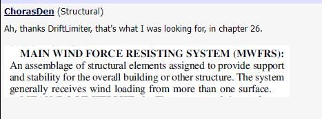

This question seems to come up on this forum in one form or another about every 6 months. Lexpatrie has it right in that yes, you need a complete load path. I also agree that the C&C load is a local load applicable to each component individually. MWFRS is applicable per ASCE 7-16 to members that support/resist (2) or more surfaces. I would consider the connections from stud to foundation to meet this requirement, and thus, I'd design for MWFRS.

I agree with you, I will however point out that the truss design industry as a whole designs their uplift connectors for MWFRS loads instead of C&C loads. They hang their hat on the phrasing of Chorasdens code snip referring to the 'more than one surface'.

I think the code writing folks and the code reading folks have gotten this MWFRS vs. C&C all confused, trying to use terms about how many surfaces or elements are receiving wind pressures, etc.
If you stand back and think about it - the MWFRS and C&C are both simply from the same WIND. The wind doesn't know whether it is one or the other - it's just wind.
The code properly identifies that, for small effective areas, variability in pressures can be high - with small-area peaks and valleys such that a single nail might "feel" 50 psf wind pressure while the entire plywood sheathing panel sees a bit less...and the wall studs sees even less because the peaks get averaged down by the valleys in the variable pressure distributions.
To me - C&C always controls if your element - whatever it is - has less than 700 sf. effective area.
If an interior column and footing of a single story steel framed building has less than 700 sf. roof area (26 x 26 ft. bays) then that footing is indeed going to see a statistically higher (C&C) wind.
Simply rationalizing that the footing should be MWFRS because it is "separated" from the outer skin to me, isn't rational. The wind pressure that statistically occurs on an element is a real thing and doesn't know that it shouldn't occur because that element has several pieces between it and the outer cladding.
