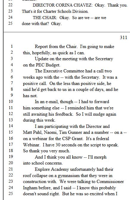

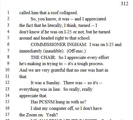

Zero discussion about investigating the roof collapse during the NM Public Education Commission public meeting that was held April 19th, eleven days after the event. Collapse was only mentioned in passing.
Link
