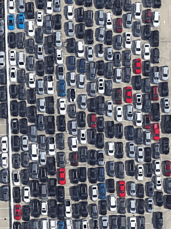

Google Earth of the ATL rental car parking garage. I presume they took this into account during the design phase...
I didn't see parking like that until I visited NYC...codes don't really cover them - they'd be subject to unique loading criteria decided by the building official and SEOR.
Working in the auto industry has sent me to garages like that in quite a few cities. Our internal garages often have sections solid with rows of forgotten development/executive/museum/other vehicles, crashed/certification/other vehicles that cant move for legal purposes, and production holding lot (shipping) overflow. There's also a surprising number of external fleets like rental companies and some cabbies where drivers simply need a type of vehicle, not a specific vehicle so most can be blocked in. A bad but likely true joke is that horns werent connected to key fobs for the public's benefit, its often the only method in a sea of the same make, model, & color on our lots.
I'd have assumed that all garages were designed for solid occupancy to simplify regulating their use if nothing else. I've seen plenty of "max occupancy" signs for warm bodies but dont recall ever seeing one for cars. I've also supplied static tire/skid/other pressure loads so vehicles and equipment could be placed for trade shows and marketing photo-ops and normally hear concern about damaging floor/roof coverings, not collapsing the structure itself. OTOH, smarter folks probably make a habit of running that math before calling me.

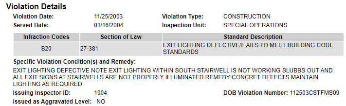

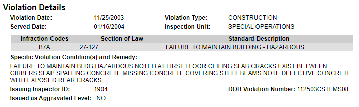

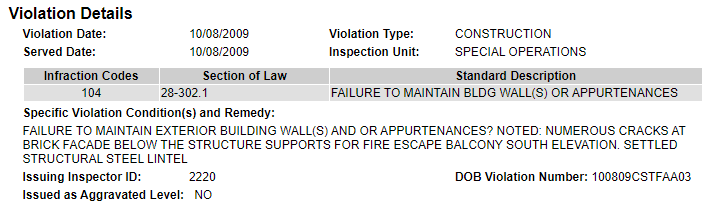

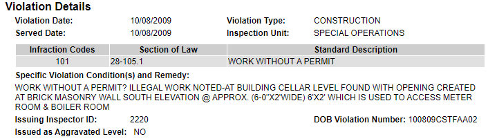

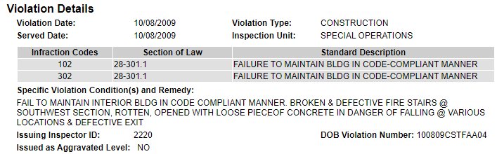

bones206 said:
Some of the violations related to the structure:
For those who can't access:
Also, there don't seem to be any permits for any work that would have been required to remedy these issues.
I think we can all agree that everything is pointing towards lack of maintenance. Was it overloaded compared to the original design loads? Probably not. Current codes? Also probably not. Was it overloaded for the actual condition of the structure? Maybe.
