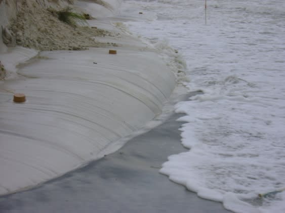

Not only are manufacturers raising the price of the 8' boom in violation of Florida laws on price gouging it is the new Copper. Florida has some very strict price gouging laws. I don't know what the limits are but the pantiles get tough very quick. Ask some of the gas stations after the last Hurricanes.
It got real interesting today when a 500 gal Al Tote Bin washed up on the beach at Panama City Beach, Florida and no one in the forty or are so emergency people knew what it was. It had a BP sticker attached so it is being treated as a hazardous waste. It very well could be sanitary waste.
There was another good one today at Gulf Shores Alabama where tons of oil washed upon the white sands, ugly and sad. There were several people in hazmat suits. the heat index was 106°F. One of the reporters ask the guy in charge whio was dressed in a white suit and straw hat what was going on. He said they were sampling this material to see if it was oil and also determine where it came from.
The also tried one of the brand new $87,00 beach cleaners to remove the oil and it clogged up in about 5 minutes. The official comment was that the oil was too sticky.
