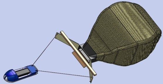

The linked drawing provided is basically what I understood. While this would no doubt be quite an Engineering and fabrication undertaking, If the principle were to work, this very large and no doubt in practice heavy type cap could have an advantage of maybe intercepting not only that oil we all see on the clips coming out of the cut-off riser BOP, but maybe also some that might be seeping inside the larger 36"? casing on the seabed, or maybe even some distance outside same through the soil (by the inner containment vessel, recovery piping extending from the top of the shut-off valve, or even outer vaccum drawing or internal pressure relieving annulus/vacuum piping). I believe there are folks, however, who could quite readily fabricate steel tubes and reinforcements many meters/feet in diameter with even many inches thick walls, and welded together as high as necessary to clear.

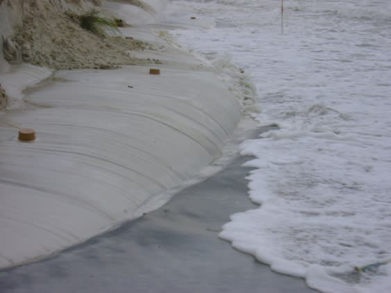

I went over to the beach to see this material demonstrated. it works as described and is relatively inexpensive. It is a Urethane fabric and has the ability to host some super microbes that start immediately start to work on the oil.
X-Tech Fabric
