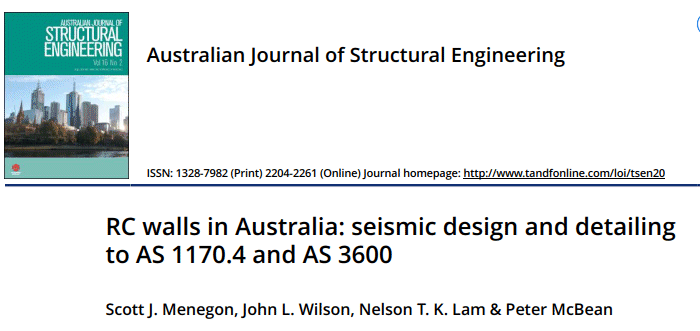

So just to be clear, you believe the correct interpretation of 11.7.4 requires all walls designed as columns that are over 50MPa must be restrained to 14.5.4. In other words 11.7.4(a) cannot be used, even though not clearly stated.
Moving to 14.5.4, this clause in intended for an IMRF ie mu=3. Is this still applicable if mu is 1 or mu is 2. The reference from 11.7.4 places no qualifications. Should the reference simply say the provisions of Section 14 for columns be considered (which they obviously should be anyway).
You can have, say, 2500x250 65MPa blade column which doesn’t pick up much in plane moment if the core is much bigger, say 9000x9000. It may satisfy 11.7.4 or may not using mu=1. This would allow no ties or normal ties (at 250 centres) depending on load, if the first part of 11.7.4 is used and since it is Ok with mu=1, Section 14 has few requirements. If the last paragraph is used and no exemption is allowed for mu=1, then you need closed ties (not 90/135 hooks) at 125 centres for the full wall height.
There are big cost differences depending on how the clauses are read.
You will have to wait until the amendment is out. I cannot preempt what will be finally decided.
I am just pointing out that the 10.7.3 limits on special confinement in their current form are not really applicable for earthquake situations where there is a lot of plastic response required after the "nominal" elastic design load is reached. So the "nominal" elastic design load cannot be used to determine when special confinement is required.
