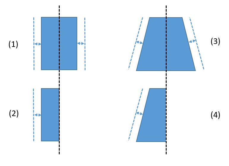

See the below. Each of these shows uniform offset normal to the true profile. The section line between 1 and 2 (as well as 3 and 4) shows that if you consider the uniform offset of half of a width shaped FOS it is the same as the uniform offset of a planar feature. The same is true of a tapered feature.
As far as showing this unlimited uniform offset which prevents a conical feature being contained by/containing a conical boundary one could utilize an expanding clamp such as machined into an "external" conical shape to mate with a similar "internal" conical feature on a sample part. The clamp can be infinitely expanded and will never reach a point where it is captured by the mating part. This "expansion" is the same as the aforementioned uniform offset.
Tolerance zones are centered about axis and center planes or uniformly distributed about the true geometric form. Boundaries and envelopes are not tolerance zones.
Your sketches (in planar graphic space) appear to be equating an offset planar surface in a single "normal" vector, and the same for a cylindrical or conical surface. Cylindrical and conical surfaces have normal vectors in 360 degrees about an axis. With that in view the cylindrical surface is far more similar to a conical surface. Where I see nothing in themselves (cylindrical and conical surfaces) having similarities to a planar surface.
I have know idea what you believe about threaded holes including their conical surface countersinks being located with tolerance of location controls for FOS(s). Screw threads by definition have a rigid helical structure wrapped around a cylindrical or conical surface. Now what ? regarding an AME especially when the tolerance of location is measured relative to the "imaginary" simulated pitch cylinder.
The sketches can be extruded normal to the surface shown (in and out of the screen/page) to represent a planar tapered feature or revolved around an axis to represent a cone. My statements are no less valid.

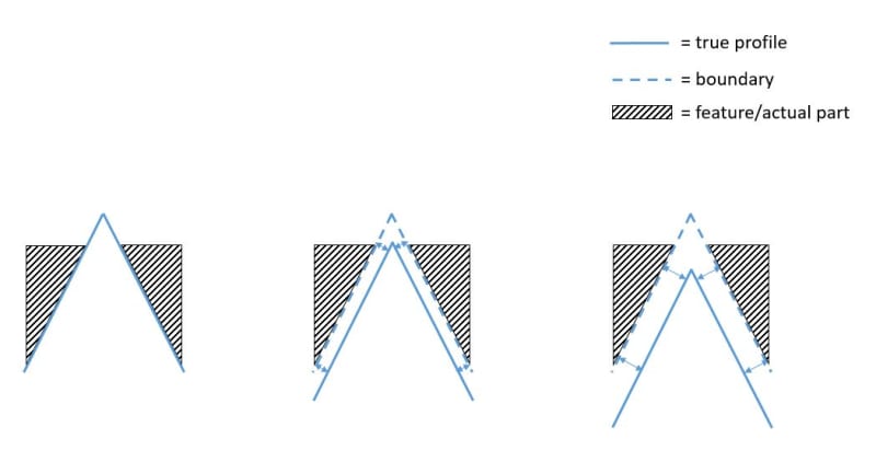

I am confused about your graphic showing 3 participants of a simulation process: true profile, boundary and feature/actual part. I always imagine 2 participants: boundary (envelope simulator) and the actual feature.
https://www.eng-tips.com/viewthread.cfm?qid=448819)[/URL]]Using these definitions, the conical feature (with or without the flat surface at the tip) is certainly not a feature of size. If you imagine the true profile starts out roughly aligned with the actual feature and an offset envelope progresses toward the material, it never reaches a point where it can't progress further. The feature just gets pushed away from the true profile.
I'm not sure where your confusion is. This has quite literally been in the discussion since I first introduced the referenced thread. The uniform offset that has been discussed is the normal distance between the true profile and an envelope which contacts the feature. I have mentioned this concept repeatedly. Yes the true profile is a theoretical reference for the uniform offset of the envelope of interest - we discuss the connection between theoretical and physical all the time - physical/theoretical datum feature simulators, theoretical datums, datum reference frame (three theoretical mutually orthogonal planes), virtual condition, etc.. I'm not sure why this particular theoretical boundary could not be discussed in the same context.
For an RMB datum feature the simulator moves normal to the true profile uniformly offset a measurable distance from the true profile as in 4-31(a)
For a datum feature denoted [BSC] the simulator is coincident with the true profile as in 4-31(b)
I don't see an issue here discussing true profile in relation to the simulation process.

Perhaps I shouldn't use the term "true profile" for this, but I was hoping to avoid inventing new terms.
Perhaps we could even expand the question to "does a feature, or collection of features, defined with non-basic (directly toleranced or +/- dimensions) have a true profile?"
The concept of "cylinder of unspecified diameter" could be extended to other features or collections of features. The implications of the unspecified aspect(s) of the geometry would need to be considered for each case though.

]I think it is useful in certain circumstances (this being one of them) to think of the true profile as being a cylinder of unspecified diameter.[/b] ISO 1101:2017 takes this approach in allowing the application of profile tolerances to such features, although only with the OZ modifier (analogous to the dynamic profile modifier of ASME Y14.5-2018).
This is kind of along the lines of what I was thinking, I am in full agreement. I have no issue with this or with using the term "true profile" - I see no need to invent a new term, and I think it fits well within the construct of the existing Y14.5 standard/definitions as well as can be used to address cases which are not directly covered by the text/figures in the standard.
Contrary to some of the assertions above, I think that MMB/LMB can be explained in terms of the true profile and not the other way around or MMB/LMB being an independent "boundary" in its own right. Could we not define MMB as the offset from the true profile, within the feature's tolerance zone, which results in the maximum material or something similar? This is why without location constraint for a conical/tapered or planar feature MMB does not make sense as the amount and direction of offset from the true profile which results in the maximum material is undefined.
Also as far as "unspecified" would you say that the true profile could be anything between the applicable toleranced dimension? Ie: if there is a cylindrical feature of 30+/-0.5 the diameter of the true profile could be anything between 29.5 and 30.5 ?
but reading this paragraph please notice that as I said earlier in my post from 19 Nov 19 04:36 ("...dictate the "normal direction" of relative movement between part and simulator prior to contact") it only sets the direction of "progression":
I would say instead that MMB "only" sets a limit (direction and amount) to the amount the simulator may be offset from the true profile which results in the Maximum Material within the feature's tolerance zone. This is supported by the text. It doesn't prevent discussion of MMB as a part of the simulation process the same as it doesn't for the true profile - I'm not sure why you are so quick to dismiss true profile for similar reasons.

Since true profile only directs an offset, the distances from it are irrelevant during simulation, and as I've been trying to explain, "unlimited offset" from true profile doesn't really tell anything about the feature. The only offset that may be meaningful as a distance is offset from the MMB (as para 4.11.4 confirms by the bolded section of the quote above). When the datum feature simulator makes "maximum possible contact" (quoting the standard) with the feature it will not be at an infinite offset from the MMB.
Maximum possible contact is a can of worms that I don't think is worth opening. Its referenced many times in the standard and I think may be one of the most poorly, ambiguously, and frustratingly defined terms in the whole standard. I think its best mostly to ignore it and instead focus on the behavior of a UAME (or potential UAME) which can be defined in concrete terms - maximum expansion/contraction/offset of the envelope.
Ignoring the fact that it isn't defined even for simple features of size specified without basic dimensions, the reasons why I suggest to replace your use of "true profile" in the context of UAME simulation with an MMC/MMB boundary are:
a. True profile is not a boundary and has no defined location in space relative to part, simulator, etc.
b. MMB/MMC boundary as an origin of simulator progression (assuming such origin is necessary) never results in an unlimited amount of offset from the origin during a simulation. If I'm not mistaken, the unlimited offset is what you find to be the failing factor in UAME simulation for a conical feature. As far as I'm concerned, the amount (and at some cases direction - I will address this below) of offset doesn't affect anything and shouldn't even be considered; if the true profile of an external, +/- toleranced cylinder is a cylinder of unspecified diameter as you and pylfrm suggest, then this diameter can as well be infinite and so is the amount of contraction/offset from true profile during simulation. Does the process fail? No, because it doesn't matter. As for direction - the direction of offset/contraction for a cylinder should be radial (relative to the simulator axis). The direction of progression of a conical simulator can be radial (contracting clamp) or axial (fixed simulator) and in both of these cases, it effectively would be in a normal direction to the theoretical conical surfaces. There are probably some nuances that I don't consider here but I don't think there is a purpose in analyzing all this - the simulation process has little room for failure.
chez311 said:
The same is obviously true of a fixed simulator - if you set a part with a conical feature on it you can also simply just remove it
... Or, you can simply just keep it in place. The only reasonable justification for "simulation impossible" would be an inability to "set a part with a conical feature on it" in the first place. As long as it's set, it contains/being contained.
chez311 said:
If this behavior satisfies your definition of containment then you must also say a single planar feature is also a FOS. I don't see how you could say otherwise.
A planar feature can not surround or be surrounded by a counterpart with opposed points, and can not have size dimensions associated with it.
It absolutely does.

If a profile tolerance controls "form or combinations of size, form, orientation, and location of a feature(s) relative to a true profile" then the true profile must be constrained in location/orientation relative to the DRF.
MMB/MMC boundary is just one end of the limit of possible offset from the true profile. Sometimes that limit does not exist - as is the case with a conical/tapered or planar primary datum feature. As I mentioned already there is no MMB/MMC limit of a conical/tapered feature which is not location constrained.
I wouldn't say unspecified = infinite. If the diameter of a cylindrical feature is toleranced 30+/-0.5 the way I would interpret it is that the diameter of the true profile can be anything between 29.5 and 30.5 and the amount of offset from the true profile anything between 0 and 0.5, noting of course that the feature must still fall within the stated tolerance.
Thats not what I said. I did not say it is impossible to simulate - I said that the feature does not contain or is contained by the simulator. Obviously a fixed conical simulator does the job of primary datum feature simulation just fine - however it is not a FOS and is not simulating the UAME.
If your definition of containment is "as long as it's set, it contains/being contained" what features do you imagine don't satisfy that - besides a single planar feature (due to your aforementioned not associated with a size dimension)? Is everything except a planar feature a FOS? I'm hard pressed to think of a shape that wouldn't satisfy that. Not to mention the fact that I obviously don't agree with your definition of containment.
I think it's best to leave it as completely unspecified. Do you see some potential benefit in what you propose though?
