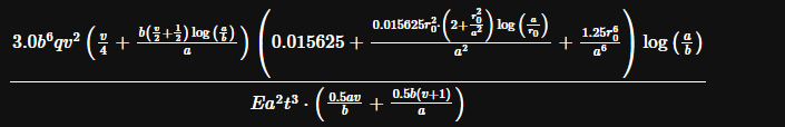

Having joined a new company, I've been tasked to "standardise" a batch of old spreadsheets that are frequently reused. Absolutely nothing give references for the calculations embedded and I'm working to change that. I've managed to track down most of them, but have run into a wall relating to deflection of an orifice plate with a horrendous bit of excel that simplifies to this:
[delta]y = Axial deflection of plate inner edge
[delta]P = Differential pressure
Dpipe = Pipe ID, used as the fixed edge of the plate
Dplate = Plate constant/flexural rigidity
dn = Orifice ID
The values for this are essentially the same as using Roark's 7th Ed Table 11.2 Case 2e (for the range where it's practical to real-world circumstances), but I can't find where this much more compact equation comes from - any pointers?
Edit: Define [delta]y
And so that someone else can feel my pain, here's the original excel formula:
G24 = Differential Pressure Head [m] (itself calculated from differential pressure)
1000 = Density [kg/m3] (unlinked to the variable input for fluid density)
C15 = Plate Thickness [mm]
C17 = Pipe ID [mm]
G27 = Orifice ID [mm]
G32 = Young's Modulus [GPa]
G33 = Poisson's Ratio
Noting that "Diameter Ratio = C17/G27" is one of the first things that they've calculated...
I put Roark Table 11.2 Case 2e through Sympy and got this:
Not even close to your simplified expression.
To make Excel a bit easier on the eyes, using alt-Enter will force a line break without entering the formula, so the formula can be formatted a bit nicer.

I am trying to figure out the origin of this equation that, for a select range of values, happens to give a good approximation to Case 2e.

I'm comparing your equation above to Case 2e, Table 24 in the 5th Edition of Roark, annular plate, fixed outside, free inside, with uniform load. I assume that's the same case you're looking at.
Comparing the two, the curves cross each other, and if you're near the intersection, the formula above is "close", but that seems to be more or less accidental.
So, possibilities:
-Flat out error, for reasons unknown. Maybe they started typing the Roark's solution as one long formula and left off 90% of it.
-Some other more-approximate method, maybe energy methods, maybe a cantilever tapered-beam solution (although that should approach the Roark solution for larger holes, but the equation above is more in error for large holes).
-Maybe somebody tried to approximate the Roark solution. Note that the ln term only varies slightly, so setting ln(Dpipe/dn)= constant simplifies the whole mess somewhat, but doesn't drop out to that equation, either.
