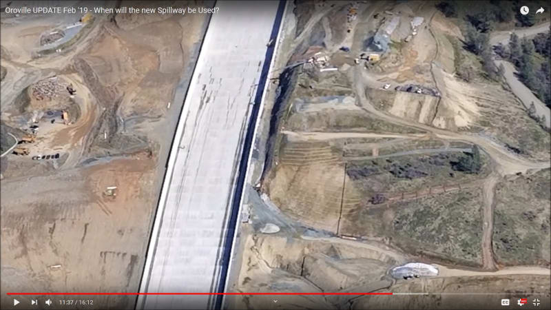

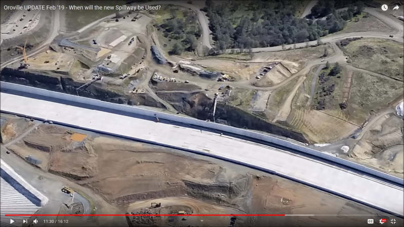

I'm not one to fuel conspiracies but..., these are screen grabs fro Juan Browne's Feb. 19 update. Keep in mind that in the week prior, the West Coast was hit by a Pineapple Express and some areas received up to 8 inches of rain.
Backfilling operations were in progress and you can see a man-lift inside the spillway at the same elevation as the water streaks.
1)
2)
3)

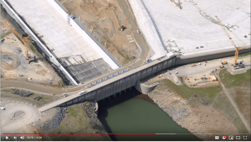

Here's a screenshot from the video that EdStainless posted on 19 March. It was taken by Juan Browne on 14 March and clearly shows that the water level in the reservoir had reached the front face of the spillway gates and it also shows that indeed there was leakage from those gates.

epoxybot: There is water running down the spillway. It's been posted that the gates are leaking a nominal amount of water which runs down the spillway, most likely traveling along the surface in a serious of small channels from the expansion joints, and periodically expressing itself as streaks where the channels' capacity is exceeded and the water starts to run along the surface.
As I understand it, there are people who are claiming that is that the phreatic water from the upstream face of the dam is forcing water to seep through the embankment; then forcing its way through the drainage system under the spillway (which must be overwhelmed or has already failed in its entirety); then finally forcing its way through cracks in the concrete before trickling down the spillway. Is that even possible?
What is your theory about the streaks?

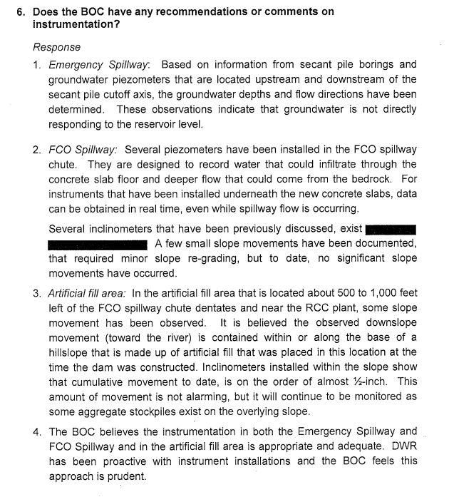

HAve gpr, grnd penetrating radar, probes of soils under spillway been done in lieu of piez. sensors?
With NO piez. it would seem prudent to have regularly scheduled GPR runs to highlite any voids before they grow large enough to be a huge problem.
With NO piezometers working, no one knows what is going on around dam. For 1B in funds WE could not find money to replace these critical sensors???.

The Board of Consultants previously addressed the issue of piezometers in the spillway. Numerous ones were installed as part of the reconstruction:
(see excerpt below from page 9).
An independent board of consultants was engaged and has monitored every step taken during the recovery. There's lots of great detail in their reports:
See page 9:

Here is a picture from earlier in the thread which shows pretty clearly how the water is flowing down the spillway from the gates.... then into horizontal expansion joints... then flowing down in a different location after traversing laterally across the joint.
Full size:
The picture shows there are different preferential flow paths for small amounts of water to flow down the spillway. This is influenced by things like lateral and longitudinal slope, and expansion joint width. Even simple things like a piece of aggregate in the joint can influence where the water expresses itself on the surface of the spillway. Some areas are narrow concentrated flows of greater depth, where others are wider and more dispersed. None of this seems really unusual to me.
FACTS:
[ol 1]
[li]The spillway gates are not designed to be watertight;[/li]
[li]The spillway gates are under hydraulic head right now;[/li]
[li]The spillway gates are known to be leaking which provides a ready source of water at the top of the spillway;[/li]
[li]Water flows downhill;[/li]
[li]The water leaking from the spillway gates is flowing down the spillway.[/li]
[/ol]
CONCLUSION: The spillway is wet in places.

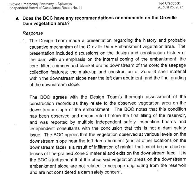

Not to sound like a broken record, but the Independent board of consultants ALSO addressed the issue of the "Green Spot", in the same report I linked you to earlier, see below.

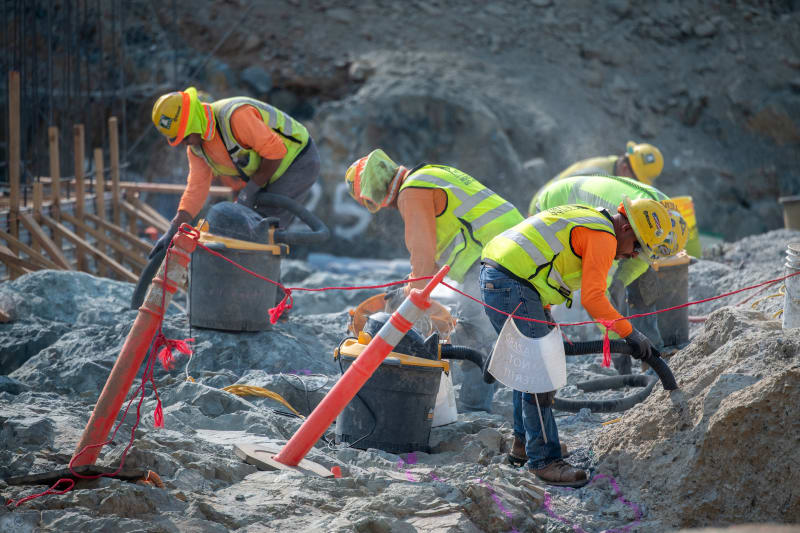

Further, the Dam is an earthen Dam, constructed in a 'valley' The spillway was constructed on the side of the hill adjacent. There is no 'compacted' material under the spillway, in fact, during the reconstruction they cleaned the foundations down to the bedrock by hand, with pressurized water, buckets and even shop vacs, see below for a picture from among 100's taken during the reconstruction.
They started investigating the failure and planning repairs with on site work while the dam was still full, so how would they have missed a major seepage path that surfaced under the spillway?
