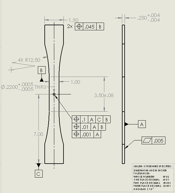

I have a part with a symmetric line down the middle as shown in attached picture.
Assuming I am using current ASME standards, having the dimension labeled 1(red) and the dimensions 2 and 3 would be over constraining the part correct?
Is having only the dimension labeled 1 and not having dimensions 2 and 3 an acceptable way to dimension the part?
What about having only dimensions 2 and 3 and not 1, similar to how dimension 4 is being used?
As a semi related bonus question, if I put in a center line, does that imply the part is supposed to be symmetrical about that line in all views or just in the view with the center line? Can I use a center line on a part that is not completely symmetrical about that axis in the given view as long as the non symmetrical features are obvious?
I have tried looking these up, but I cant find exactly what I want in ASME Y14.5 or a good example on google, sorry if this is obvious and I have just missed it.

You've moved the datum feature symbol away from the dimension line. That changes the meaning of it. Datum feature B is now the right edge of the necked down part. If you look at your previous drawing you had the datum feature symbol in line with the dimension line. That makes the datum the centerplane of the necked down part. You're still on the right track and it looks better but A little more refining needs to be done. Do you happen to have a copy of a GD&T standard available? There's a right way to indicate more tolerance in one direction than the other and this isn't it. A verbal explanation will take a lot so I'm hoping I can just point you to the page.

I have a copy of ASME Y14.5M-2009 I can use if that works?
The tip about having the datum on the dimension is very helpful, didn't even occur to me.

Updated again based on the datum location and tolerance refinement, which I assume is what Powerhound was referring to?
Hopefully I am starting to get this down better :/.
Just another update in case anyone finds this thread later on.
The little suction cup for B is supposed to be on the surface and the handle of the plunger aligned with the dimension it applies to. I would also suggest adding a diameter symbol to the position controls; since it is one hole the last tolerance of position to A is likely to be argued should be a perpendicularity.
Also, don't align datum C with the 7.00 dimension; it makes it looks like the dimension is for a datum reference.
