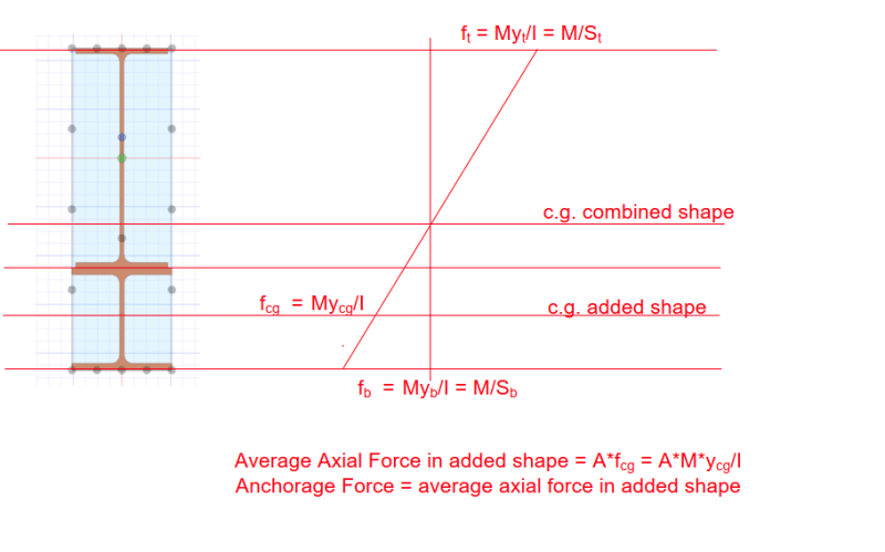

I'm working on a steel beam reinforcement consisting of a new W-shaped beam welded below an existing W-shaped girder, which looks like this:
I'm trying to determine the anchorage force and extension required for partial reinforcement. According to my reference below from the Canadian Steel Handbook, the formula provided consist of the area of the reinforcement times the distance from the centroid of the reinforcement to the centroid of the entire combined section, which is the same variable (Q) used in shear flow calculations. My question is, would this formula still apply to my W-shaped reinforcement? Or is it limited to cover plates?
I'm concerned that there's an implicit assumption that the plate has uniform stress if assumed to be thin, and with the W-shaped reinforcement, there is a considerable stress distribution across the depth of the section. Any thoughts on this? Thanks.

I agree shear flow is not limited to cover plates and yes it's VQ/I, but the anchorage force formula provided in my reference is MQ/I.
Do you think there is still no difference and the anchorage force formula is also applicable to W-shaped reinforcements considering that the cover plate is a relatively flat element, and the W-shaped reinforcement has depth in it?
The anchorage force is equal to the total axial force in the reinforcing member, MQ/I. See below.

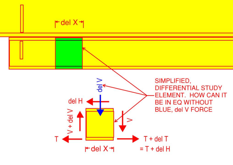

If you deny the existence of the force shown in blue below, then how would you put the differential element back into equilibrium with respect to vertical force? For convenience, I've pretended that all of the flexural tension resides in the lower flange. I don't believe that compromises the argument but, if I'm wrong, I'll be grateful to hear about it.
Upon further consideration, I believe KootK has a valid point. The lower beam carries a portion of the total shear. Since it does not extend to the support, it needs stiffeners to carry its reaction into the upper beam. In the absence of stiffeners, the reaction would need to be carried by flange bending.

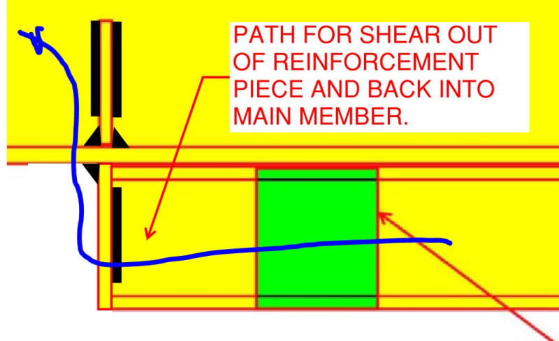

There needs to be shear in the reinforcement piece regardless of whether or not the original beam is adequate for shear on its own. And, since the shear in the reinforcement has to get in and out of that piece somehow, then I feel that the flange bending & weld tension issues exist regardless of the shear capacity of the original beam.
Do you know how to quantify the length of this "transition zone" such that its capacity can be evaluated? I don't other than to maybe ballpark it as 2X the depth of the reinforcing piece or something like that. Given that uncertainty, just throwing in a stiffener set to make sure that the issue is resolved convincingly seems entirely reasonable to me.

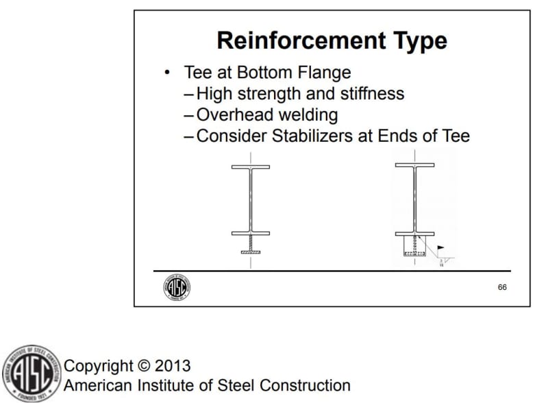

I typically throw in a stiffener to serve as a stabilizer as shown below, independent of the issue that we're discussing here and simply as a matter of good practice. The fact that the stiffener can also act to relieve cross flange bending is effectively just a negligible cost bonus.
To clarify for OP, if he's still around, this is really what I'd be aiming for.

1) The MQ/I welds at the ends of the reinforcing certainly feel like a concentrated moment in the way that you've suggested. However, the welds between the ends are normally introducing additional shear as well which implies a shear force that is varying along the length of the member. And that returns us to my differential element FBD.
2) In any normal built up beam, I feel that this logic chain applies:
a) One requires the new, low flange force to vary along the length of the beam.
b) [a] dictates that the reinforcing member horizontal shear increases along the length of the beam.
c) dictates that the reinforcing member vertical shear increases along the length of the beam since vertical and horizontal shear are everywhere and always complimentary.
The flange force will vary under constant shear. Varying shear isn't needed.
Regarding the del_V in the free body diagram, and assuming you're talking about a location away from the end of the reinforcement (away from the disturbed region), the balancing force is the external load that causes the del_V, or rather the portion of the external load that is supported by the reinforcement since del_V is defined over the reinforcement depth only. The welds need to transfer this if you don't assume direct bearing by the main beam on the reinforcement. I would design the welds for this.

Whether one wants additional stiffeners or not, I can't see much logic in omitting the stiffeners at the ends. Those stiffeners have awesomely direct load transfer from the reinforcing web straight into the existing beam web, sans flange bending. Stiffeners located anywhere else would involve some reliance on flange bending around the stiffeners and non-uniform stresses in the welds.
At long last, I now agree that KootK is correct. Under uniform load, horizontal shear from the flange welds causes the lower beam to curve upward (tension on top). But the beam curves downward, so some of the applied load is acting directly on the lower beam (through the upper beam). Reactions at each end must be transferred to the upper beam by stiffener plates.
