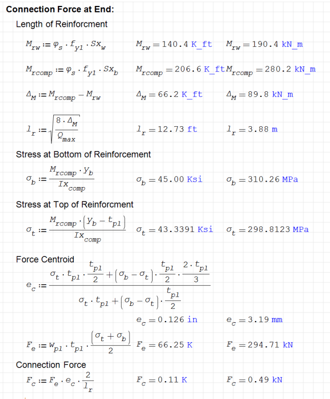

Hello,
I'm working on a steel beam reinforcement consisting of a new W-shaped beam welded below an existing W-shaped girder, which looks like this:
I'm trying to determine the anchorage force and extension required for partial reinforcement. According to my reference below from the Canadian Steel Handbook, the formula provided consist of the area of the reinforcement times the distance from the centroid of the reinforcement to the centroid of the entire combined section, which is the same variable (Q) used in shear flow calculations. My question is, would this formula still apply to my W-shaped reinforcement? Or is it limited to cover plates?
I'm concerned that there's an implicit assumption that the plate has uniform stress if assumed to be thin, and with the W-shaped reinforcement, there is a considerable stress distribution across the depth of the section. Any thoughts on this? Thanks.

You'll probably kick yourself at how close you were to the simplified form. In your 8Apr 20:04 post, replace Q/Ar with y_crc (distance between composite section centroid and reinforcement centroid) then rearrange the Srb terms to Srb(y_cbc - y_crc) = Srb.y_cbr = Ir.

Firstly, KootK alerted me to the fact that there was a reaction of the reinforcing beam which had to be taken by a hanger from the original beam. I didn't see it for a long time, but he was right.
Secondly, even after I did see it, I calculated only part of the reaction, namely the reaction from the axial force component, neglecting the moment component. Eventually, I could see that my answer was wrong because the reaction of the two beams did not add up to the reaction of the composite beam.
KootK came up with the correct answer, but steveh49 provided a simplification which I am embarrassed to admit, I missed entirely, namely:
Vreinf / Vtotal = (Ir + Qr * Cr) / Ic
Ir = I of reinforcement about own centroid
Qr = Q of reinforcement when considered as part of composite section (the usual Q value)
Cr = distance from centroid of reinforcement to interface with the main section
Ic = I of the composite section
It is beautiful in its simplicity.
So, thank you KootK and Steveh49.
BA
