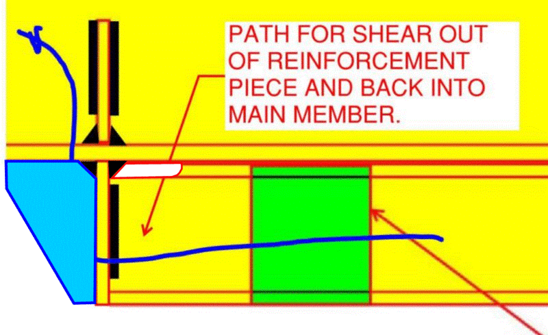

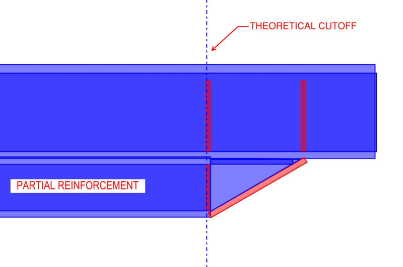

I'm working on a steel beam reinforcement consisting of a new W-shaped beam welded below an existing W-shaped girder, which looks like this:
I'm trying to determine the anchorage force and extension required for partial reinforcement. According to my reference below from the Canadian Steel Handbook, the formula provided consist of the area of the reinforcement times the distance from the centroid of the reinforcement to the centroid of the entire combined section, which is the same variable (Q) used in shear flow calculations. My question is, would this formula still apply to my W-shaped reinforcement? Or is it limited to cover plates?
I'm concerned that there's an implicit assumption that the plate has uniform stress if assumed to be thin, and with the W-shaped reinforcement, there is a considerable stress distribution across the depth of the section. Any thoughts on this? Thanks.
I agree with the end stiffeners and was going to point out that they should be at the end of the reinforcement rather than where first drawn but you got in with the current detail first. I also thought my local code had a requirement not to rely on mixed bearing/weld connections but that doesn't seem to be the case. I would then only have the end stiffener; I think that a little flange flexibility will avoid excessive compatibility stresses. It is still the case that any varying reinforcement shear is caused by varying overall shear and not varying moment; and that the disturbed zone is a different beast than the interior which I thought wasn't coming out in the discussion.
The stiffeners at the ends makes sense to me as they provide stability and load transfer of the vertical shear component in the reinforcing beam back into the existing girder. I would have to design for those stiffeners in addition to the anchorage forces from the horizontal shear flow. Thanks guys I appreciate the help.[bigsmile]

I agree, the transition surely is a disturbed region. What do you propose for dealing with that? My thinking has been:
1) Do the stiffener as proposed so that, at worst, you might rupture some welds at the end of the reinforcement but not rip the thing clean off.
2) Design the MQ/I welds to also perform the "hanger" job at the end of the beam so reduce the odds of rupturing any welds. Luckily, this will naturally be a location of concentrated welding.
3) As you said, hope that flange flexibility helps to relive any stresses arising from compatibility. This would tend to be more true further from the stiffener I think.

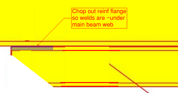

Edit: Or maybe chop out most of the reinf top flange width at the end, do away with the stiffeners, and just have web-to-web welds for a length aka the reinf section is an inverted tee at the end.
steve49h said:
I'm in the happy territory of knowing this is over-thinking but also under-thinking at the same time.
That would be a pretty great detail from an engineer's perspective. I'd also thought of partial coping as an attractive solution. Of course, as is probably the case with most engineers, I'd back off in practice to just the stiffener for fear of being considered -- and possibly truly being -- ridiculous.

Which leads me to this detail. Less welding overall (replaced by gas cutting), no additional overhead welding, doesn't look ridiculous. The reason for going down this track is I'm still not sure whether the concentrated force that transverse stiffeners enable doesn't also have a downside. This structure matches the increase in section properties to the St Venant principle so there isn't any tendency for weld forces to deviate from weld capacity. Maybe St Venant means we don't need to cut out the lower left corner of the reinforcement.

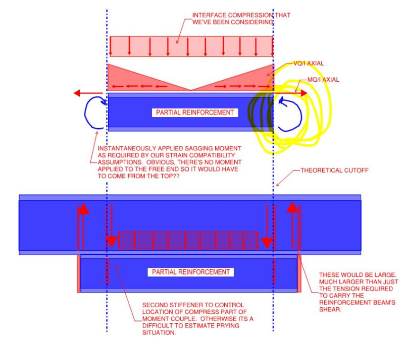

I'm beginning to think that we've been missing something important here. For the general case of partial reinforcement, I feel that a free body diagram of the reinforcing piece ought to include end moments as shown in my first sketch below. My second sketch shows a possible detailing arrangement to suit such a model.
And then, of course, the next logical step would be something like this which starts to look like what any bridge engineer or PEMB designer would surely suggest for a variable cross section member...
Koot, that moment is what I've been trying to address. The stress in the reinforcement can be thought of as a moment and axial force superimposed. As per BA, the flange welds introduce the axial force in a way that opposes the required moment so increase the concentrated moment. I don't know whether the couple will be too close with consequent weld-popping forces unless we make it be further apart or the stress development more gradual. And trying to do it without the second stiffener as a challenge.
Ahhh... Now I see the genius of your first detail. The back end stiffener does the moment job. Given that MQ/I and these end moments both dissipate towards the supports, I feel like it's generally a good idea to just run the reinforcement as near to the supports as spatial constraints will allow.

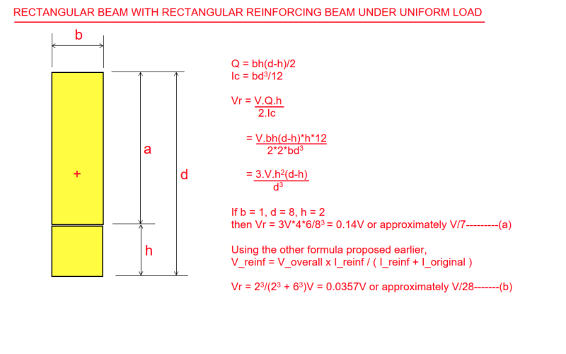

Tension from weld to reinf. beam = T = V*Q/Ic *L/2 *i2 = V.Q.L/4Ic
For uniform load on composite beam,
Mr = T.h/2 = V.Q.L.h/8Ic @ midspan varying to zero at supports (parabolic shape)
To balance Mr, we need Wr acting down on lower beam, which it gets from the upper beam bearing on it.
Wr*L/8 = V.Q.L.h/8Ic
Wr = V.Q.h/Ic
Vr = Wr/2 = V.Q.h/2Ic---------------------------------------------------(1)
Vr is reaction each end carried by stiffeners into upper beam.
Wr is total (virtual) load acting on reinf. beam
V is applied shear on composite beam @ each end of reinf. beam
Q is statical moment of reinf. beam.
h is height of reinf. beam.
Ic is moment of inertia of composite section.
BA
Following is a comparison between two proposed methods of calculating the stiffener reactions, assuming uniform load on the composite beam.
BA
