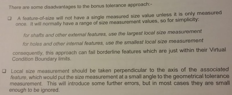

I do have some excerpts from different ISO books and ISO standards. In one of this excerpts it is stated --see below: The local size measurement is relative to the geometrical measurement subject to a small angle. And it is stated that this will introduce some further errors, BUT those errors are small to be ignored.
In the OP's case, I said to myself that the difference is too large (relativelly) for 90.170 to be considered local size, hence I concluded (wrongfully or not) must be UAME size. That was my thought process and even now I do not know if it's fully vetted.

As you know Actual Local Size is a veritable rats nest. You're asking about the math standard, it should be noted that the current Y14.5.1-1994 makes no mention of Actual Local Size - only the swept spheres interpretation. Only in the unreleased Y14.5.1-20xx draft is there any mention of Actual Local Size.
What book is that from? I guess its an ASME based book, right? If so, the author is clearly referring to the verbiage in Y14.5 since only there does it mention bonus tolerance is related to Actual Local Size, as I noted Y14.5.1-1994 makes no mention of it at all and the calculations for resolved geometry (axis) interpretation therefore do not utilize it - they only use the UAME and RAME size. Even in Y14.5.1-20xx draft the calculations for resolved geometry (axis) interpretation are unchanged from 1994, they do not utilize Actual Local Size - the only one calculation that would have to utilize it would be for MMC straightness, yet no resolved geometry (axis) interpretation is provided in the 20xx (surface interpretation only). Y14.5.1-1994 fig 5-2 is tangentially related to this, it simply shows how the resolved geometry (axis) interpretation can pass a feature while the surface interpretation will fail the same feature due to orientation error.
Additionally, the book suggests Actual Local Size should be taken perpendicular to the "axis of the associated feature" - I'm not exactly sure what they mean by this (UAME axis perhaps?) however any time we talk about an axis it is a perfectly straight ideal theoretical line. From my understanding Actual Local Size should be taken normal to the Actual Size Spine (essentially a tangent continuous DML - this is explicitly state in Y14.5.1-20xx draft and suggested in Y14.5 with figures such as Y14.5-2009 fig 1-1) which is an imperfect feature. Hypothetically I guess there could be some additional errors if we utilized Actual Local Size for bonus tolerance calculation since the largest/smallest Actual Local Size for external/internal features respectively could potentially be different than the UAME size.

No, the book is an ISO book. I am trying to understand how the "no bonus" in ISO works with "bonus" / resolved axis interpretation provided by ASME.
I think even in ISO there is no bonus tolerance and this approach is not documented in any ISO official standards, the concept is widely used across the industry.
I would like to understand, in depth, its usage and implications for the measurements and how this "bonus tolerance" concept is a close approximation of the MMVC requirement.
What means "close"? How close? etc.
For this particular example, for hole -internal feature
Bonus tolerance = measured size- MMS
what is the measured size? How this size is measured in ISO?
Those are my basic questions

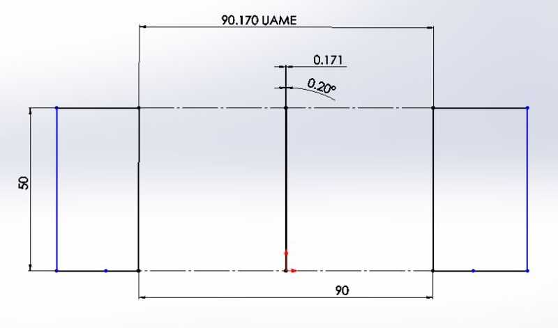

Lets take a similar case to the OP where the UAME = 90.170 and MMVC = 90.000 but instead we now have 0.171 axis orientation error. Since this is greater than the deviation allowed by the bonus tolerance (90.170-90.000 = 0.170) by 0.001 the feature would fail. However, if we measure it according to the surface we can see that your RAME = 90.000 and it does not violate your virtual condition, so it would pass.
Now in this case, and most cases, the difference is minimal (out by 0.001) as the axis is only inclined by 0.2 degrees but as the amount of axis inclination increases the difference between the two increases as well.

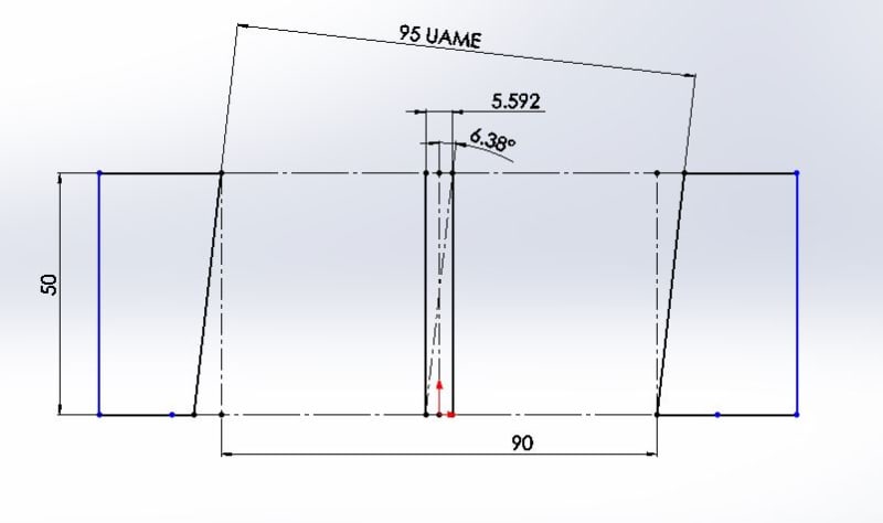

As before, its very difficult to see whats happening so I didn't include the snapshots. Below are two snapshots, the first is what I described in (17 Jul 20 17:36) with UAME = 90.170 and orientation error = 0.001 the second is the exaggerated case with UAME = 95.000 and orientation error = 5.592 so you can see whats going on. As the axis increases in inclination the difference becomes equally exaggerated. Neither of which violates your virtual condition (lets assume the size tolerance would allow the amount of variation shown in both cases).
where you draw the line?
I would draw it at whatever precision your measurement equipment can reliably measure down to (actually you may have to make a decision including measurement uncertainty too). If a feature violates your virtual condition by 0.0001mm it is nonconforming. I was merely showing the difference between the two interpretations. You asked "how close" and the answer is, for very small angles of inclinations "very close, almost imperceptibly close" and for very large angles "not very close at all".
