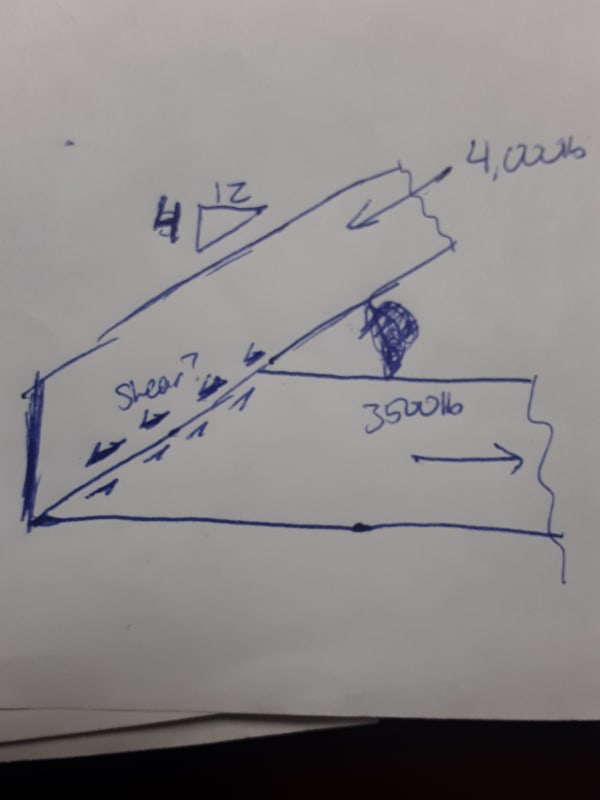

Alright I am hoping someone can help me with some basic mechanics of materials, maybe I am just overthinking this but I can not decide the proper way to tabulate the shear stress. The attached image shows two members which will be fastened with a plate (much like the heel joint of a truss or rafter) I am trying to determine the shear forces that would act on such a plate. You have a member in compression at an angle and a member in tension along the horizontal plane. My question is this, how do you determine the "shear stress" the plate would experience acting along the joint between the two members? My thought is either you consider each force individually assuming that the plate is cantilevered from the other member or is it additive where you assume the plate experiences shear from both members simultaneously?

I'm not seeing your plate in the sketch. What kind of members are they? How/where are they supported?
As phamENG stated, we need to know how this is supported. As it is sketched, the node is not in equilibrium, and the members will simply move and rotate. How it is supported will determine which force is being transferred to which member and which force is being transferred directly into the (non existent) support.

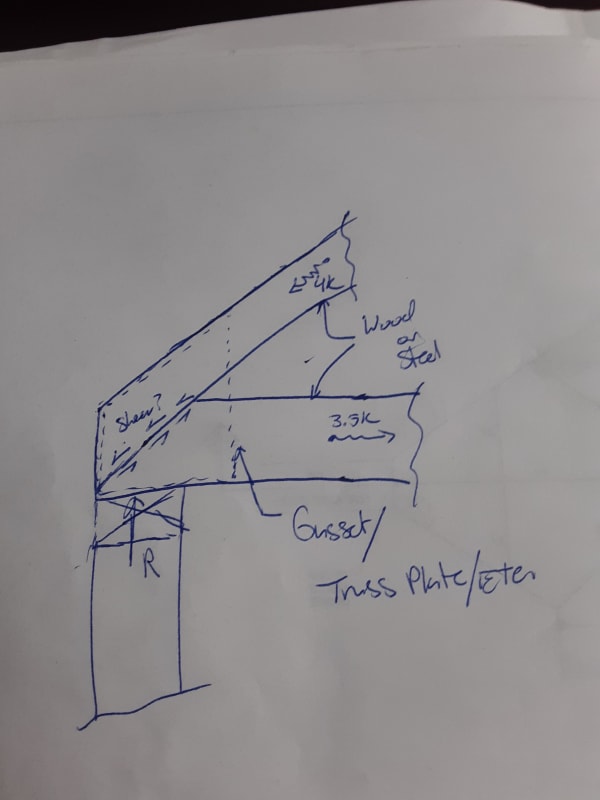

My apologies, I have attached a better sketch. To answer your questions, the support is at the end of the horizontal member. This was a general question in regards to the mechanics of it which is why I did not provide a material (I have seen this scenario with both wood and steel) but if it helps lets assume that they are dimensional (2x4) lumber.

Just look at the forces acting on one side of the joint and determine the resultant in the direction you are looking for. The easiest way to get this is just to look at the top chord as it is already in the correct direction and is the only force. The shear in the joint is 4k.

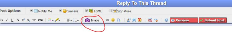

Also, you can embed pictures in the post by using the image button - this helps everyone reviewing the post by removing the need to download a separate file.
Note that the joint is not in equilibrium. Do a check on the tension chord member, T (3.5k) = C*cos θ, in which C = compression chord force = 4k. Once the equilibrium is reached, assume the compression force is correct, then the shear force in the joint is as pointed out by dauwerda.

Another hint, check the angle between the chords, θ = cos[sup]-1[/sup](3.5/4), see what you got. Does it agrees with your original sketch with 4(V):12(H) slope?

Edit: Not the normal assumption for that sketch, but, if the joint was hung from above, then you would have 3.5k going across that weld or gusset, not 4k. And, that was your exact question. Another way of thinking of it is, which member force are you trying to drag across that joint?
