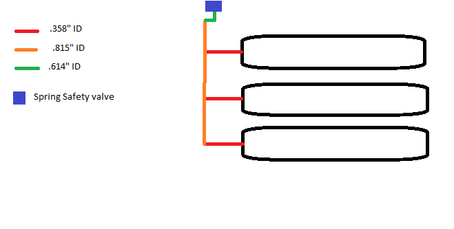

Good morning,
I am working on verifying a pressure relief system for NG cylinders with a Spring loaded safety device set to 5000 psi. I may be over thinking this but the jist of the problem I am having is that the piping leading to the safety valve is of 3 different sizes.
.358" ID for an equivalent of 1.5 feet off of 1 cylinder to a manifold that is .815" ID for equivalent of 10.5 feet to a reducing elbow that is .614" ID for an equivalent of 5.5 feet.
I am having trouble understanding the effects of the different piping size and what it would essentially do to the pressure drop from the cylinder to the safety device. My thought is to determine the combined volume, pressure drop and temperature of the inlet gas of the 3 smaller ID tubes. Use that as the starting pressure and temp for the manifold tube and calculate the pressure drop of that tube to the next reduction, and continue to the safety valve.
I attached a simple diagram of how the gas is traveling.
What are the depressurization conditions? If you start with tanks at 5000 psig and set your relief at 5000 psig, you will not ever get any flow moving to the relief valve.
First you need to set the relief capacity that you need, apparently to keep all the the tanks at pressure lower than their allowable overpressure.
As an example (all numbers made up).
You need to know the allowable overpressure of the tank. If its 10% higher than allowable working pressure of 5000, that would be 5500 psig in the tank, You now have a differential pressure to drive flow.
So you set the relief at 5000 and you would get that 500 psi pressure differential when and if the tanks reached 5500 psig and you can now calculate the flow rates in your assumed pipe lengths and diameters. Initially assume that 1/3rd of the flow comes from each tank and they total Q1, your flow at the relief valve.
Knowing the total flow at the relief valve, take a guess at the amount of the flow rates in each pipe segment, such that they all sum to the Q1 value. Calculate the pressure drop in each pipe segment.
Now start at the relief valve pressure of 5000 psig and work towards the tanks, adding each pressure drop in each pipe segment. When you reach the tanks, you must have a value not greater than 5500 psig. If you get a value greater than 5500 psig, you have too much pressure drop and you must increase your pipe diameter(s), in one or more, or maybe even all of the pipe segments. If your value is less than 5500 psig, that's just perfectly fine, but maybe some of the pipe segments can have smaller diameters. Your choice if you want to try to make them smaller.
Just keep on adjusting diameters and adding pressure drops until you get a number for tank pressure less than 5500.
When you are happy with that number, you know the flow rate that your piping will do to allow you to keep your tanks at less than 5500 psig. That's your relief capacity.
Only one more thing to do. You must verify that your tanks will not exceed that relief capacity.
That depends on what's causing the overpressure.
If you are filling the tank battery with a compressor at 100 ft3/minute, and that flow rate is higher than your relief capacity, you have to reduce your vompressor flow, or increase your relief capacity to at least equal the compressors flow rate.
If you have a fire and it heats the tanks up to 400 degrees in 5 minutes, you must calculate a reduction of the amount of gas in the tanks that you will need to keep the pressure below 5500 psig at say 70F + 400 = 470°F. Once you know the volume reduction, you can assume you must discharge that volume through the relief valve in the 5minutes it takes to get hot. Your relief capacity must be higher than that fire case discharge flow rate.
Finally size your relief valve for the biggest flow rate of all your safety condition scenarios at whatever your set pressure turns out to be. There are often other limitations that I have not mentioned, backpressure limits, if your relief valve goes into other piping, or if it goes directly to atmosphere,
so ... That's just the basics on how to solve this type of problem.

I usually start at the end of the line and work backwards. You know the flow and can first assume it is split evenly among the three cylinders and that the relief valve pops at 5000 psi. Then perform pressure drop back to each cylinder. Pressure drop of any of the 3 paths cannot exceed 3% of set pressure or larger pipe sizes are needed.
Since 10% over pressure is used to size relief valve then the actual maximum pressure at relief valve inlet will be 5500 psig. At higher 5500 psig pressure at inlet of relief valve then smaller pressure drop will be present than when 5000 psig was present therefore using 5000 psig as starting point and working backwards is conservative worst case to calculate pressure drop by 3% rule.

This is apparently a closed system; relief flow is happening from tanks without any inflow into the tanks from other piping. My systems usually have a (nearly) constant pressure source, like when a compressor is filling the tanks while the relief valve is flowing. Here I just realized that, without that compressor, like the fire case, relief flow exits the tanks and the tank pressure is being reduced as that gas volume leaves the tanks. The reducing tank pressure will reduce the total pressure drop from tanks to valve, which in turn, reduces the relief flow rate. The tank pressure is not constant. Without calculating the actual rate of pressure drop and the tank pressure at all values of time from 0 to the end of the 5 minute heat up time, and while trying to keep the design of the relief system on the conservative side, let's make an assumption that simplifies the calculations. Let's calculate the pipe diameters using the lowest tank pressure, when the relief valve has finished flowing and all that fire gas volume has exited the tank. (Neglecting Z).
INITIAL CONDITIONS
Tank vol = 10,000 ft3 each = 30,000 ft3 total of all tanks
Initial tank condition is 5000psig at 70°F.
Initial gas volume is 30,000 ft3 at 5000 psig
Initial gas volume SCF = 30,000 x (5000+15)/15 = 10.03MM SCF
Find Molar quantity (1m of gas at stp = 379ft3)
Initial lb-moles = 10.03MM/379ft3/lb-mole = 26,464 lb-moles
HOT CONĎITIONS (Find P2)
Final tank condition is 470°F
P2 = P1 x V1 / T1 x T2 / V2
V1=V2
P2 = P1 / T1 x T2 = 5015 / (460+70) x (460+470) = 8800 psia
Check the molar quantity
m =P V /R/T
m= 8800psia x 30,000ft3 / 10.72 /930°R = 26464 lb-moles
VENTING OF GAS
Reducing the pressure to the relief valve set pressure
Requires Venting of gas, but how much?
What amount of gas at 470°F has a pressure equal to
Relief Set Pressure = 5000psig
P V = m RT
m=P V /R/T
m= 5015 x 30,000/R/(460+470)
R = 10.72
m = 161,774/R
final tanks contents = 15,199 moles
How much gas needs to be vented?
26,464-15199 = 11,350 lb-moles
11,350 m x 379ft3/m = 4,301,650 SCF
Whoa! That's a lot of flow in 5 minutes. My 5m heat time was too short.
Let's say it takes an hour to reach 480°F
So that vent flow rate now will be 4.3 MMSCFH
Now we decide what our final tank pressure should be when the vent closes. Can we say 5250 psia. We could go to 5500psig, but I want to see what happens if we don't use max., if we pick a lower pressure. So we would have a minimum dP on the relief piping of 5250-5000.= 250psi Remembering that the Max could be 5000 and the relief flow that much higher.
So, finally we arrive at a pipe design flow of 4.3 MM SCFH with a 250 psi pressure drop. Flowing Temperature of the gas is 470°F. Max pressure rating needed is 5500 psig.
So, now when that flow rate starts reducing, say at a tank pressure of say 5249, the pressure in the relief piping will start to build up again to current tank pressure and the relief will open and it will make a few sputters as flow slows down. Seems that the relief piping will see some pressure cycling as the flow eventually reduces to 0 and the final tank pressure reaches almost exactly equal to the relief valve setting.
I never really thought about the depressuring process at a level of detail before.
Interesting to see why the relief valve chatters as flow rate fillaly stops.
Is all that making sense?

This is a simplification but should get you close enough to determine if the inlet DP for the relief is ok, which is what it sounds like the goal is: treat the three red branches as three resistances in parallel. Develop a flow resistance factor (K) for each segment, add the total equivalent resistance of the three parallel red branches to the others in series to get a total resistance factor. With a total equivalent K you can solve for DP using the rated flow of the relief valve.
K_tot = K_green + K_orange + 1/(1/K_red + 1/K_red + 1/K_red)

@1503-44 I meant the parallel K factors I described is a simplification. The way I read it OP is asking about pressure drop not relief sizing.
GBT, that is correct, basically to verify that the drop though the inlet side of the PRD was no more than 3% compared to the MAWP indicating lack of flow which could cause chatter or cause too much build up in the vessels under fire conditions where it can't relieve fast enough.

I am used to sizing a relief valve and piping as follows:
Set pressure is MAWP of vessel. Actual relieving pressure is 1.1 times the set pressure to allow for overpressure/accumulation.
Determine pressure drop from vessel to relief valve such that pressure drop does not exceed 3% of set pressure. At 5000 psi this would be 150 psi allowable pressure drop.
When the relief valve initially pops it will be at set pressure (5000 psig). Assuming the maximum design flowrate used to size the relief valve is being relieved, when the valve initially pops only 90% of flow will pass through the valve and 10% (and steadily decreasing amount) remainng in vessel that increases the pressure of the vessel until the pressure at the relief valve inlet reaches 5500 psig (not the pressure in the tank). However per API 520 if you stay below 3% pressure drop you can ignore the added pressure in the protected vessel due to the 3% or less drop.
Therefore if you calculate the 3% pressure drop based on an inlet pressure to the relief valve at 5000 psig, when the relief valve inlet pressure is 5500 psig then the pressure drop will be less than 3% since pressure loss decreases at higher pressures with a gas. So if you pass the 3% rule at lower pressure than at any higher pressure you will also pass.
Note that for a large vessel it will take some time for the pressure to reach maximum deisgn relieving pressure of 1.1 times set pressure (considering a 10% net flow remains in the tank and decreases as time goes on). Could be very long and it may not happen at all since the excess flow may go back to normal for some reason before the pressure actually gets up to 1.1 set pressure. So the valve will chatter in the meantime.
