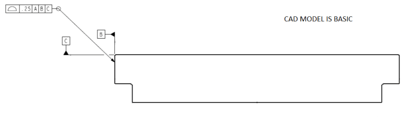

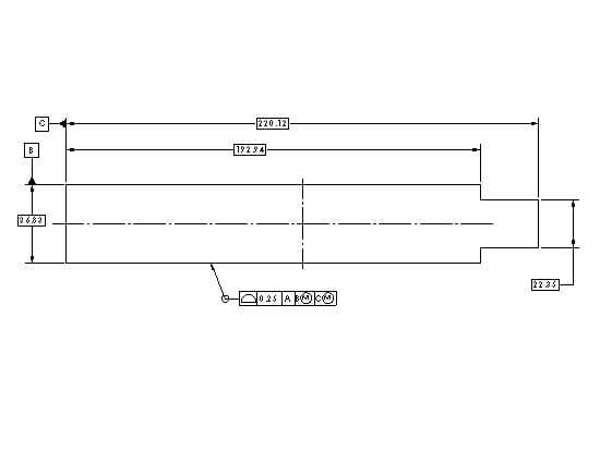

I'm hoping someone can help me answer the correct meaning of the Profile of a Surface call out is on this drawing. We have two individuals with differing opinions and I would like to understand the true intention.
The part has an overall dimension of 220.12. The side surface (B) has Profile of a Surface of 0.25 mm.
Does this mean that the overall dimension would be +/- 0.5 mm or +/- 0.25 mm?
Thank you in advance for the help.

Can you provide a reference from Y14.5 that states (or illustrates) that directly toleranced dimensions can include dimensions "controlled by a FCF" ? I don't like to nit-pick on wording and terminology (well, actually, I do), but here is what Y14.5-2009 actually states in Section 2.2:
DIRECT TOLERANCING METHODS
(a) Limit Dimensioning. The high limit ...
(b) Plus and Minus Tolerancing. The dimension is ...
(c) Geometric Tolerances Directly Applied to Features. See sections 5 through 9.
I would say that (c) does not open the door to surfaces controlled by profile tolerances with basic dimensions becoming features of size. A geometric tolerance applied to a feature is not an example of a directly toleranced dimension. The geometric tolerance applies to the feature, not to the dimension. I would also say that basic dimensions are not controlled by the FCF. Basic dimensions are theoretically exact, with no tolerance. So the 220.12 and 36.83 width and height are not directly toleranced dimensions.
Regarding the self-referencing FCF, the effect of only half the profile tolerance being available only applies when the datum feature is a single planar surface. If the 4 features were part of B and C as you say, then the entire profile tolerance would be available. This is best illlustrated with a couple of sketches.

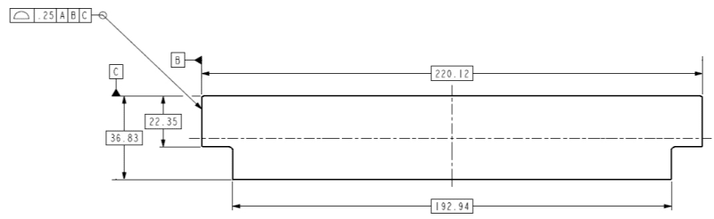

Here are a couple of slightly edited versions of the OP drawing, where the theoretically exact geometry is the same but the explicit indications are different. Would B and C be features of size in either of these cases?

Someone has pointed out that this all would be simpler if the profile had been based on datum feature[ ]A, only. The other datum features do not matter unless there are other features on this thing not shown on the sketch.
Your first sketch is just a repeat of the OP's sketch. Datums[ ]B and[ ]C are based on features that vary in size. The fixture that picks up datum feature[ ]B must account for the size variation, and it must locate the part left/right as well as in rotation. I am glad this is not my problem. If this were my part perhaps with holes in it, I would use the holes as my datums features[ ]B and[ ]C.
Above, I have modified the OP's sketch. I have made the proportions more manageable for inspection, and I have added conditions to the features of size. You can now build an inspection fixture, although, unfortunately, the part no longer works.[ ][smile]
My biggest problem is not that the datum features are self referencing. I would strongly prefer an FOS datum feature to be very much more accurate than the features I must inspect. If datum feature[ ]B were a dowel hole and feature[ ]C were a slot, both within [±]0.01mm, fixturing and inspecting this part would be easy.

The generally accepted result is that only half of the profile tolerance zone is available for the datum feature.
Evan, I don't know if that's true for the profile example at hand, because the datum is created from the centerplane as derived from the high points of the two sides (AME). For an earlier thread that CH brought into this discussion, I would agree with your statement, because that was using surface-derived datums. But here, you could have a datum CP derived from the AME, and then dial back out according to the prescribed basic dimension, and still have some hight points or low points within the full range of the profile tolerance.

In the first alternative drawing, I moved the basic dimensions so that they are no longer in line with the datum feature labels. This should mean that each datum feature is a single planar surface.

I think that we're generally in agreement on the effects of the self-referencing profile tolerance and the generally accepted result. But this isn't obvious from the one partial statement that you quoted! The sentence actually started with "I believe that the case of the single planar datum feature has been addressed". Also, in the next post I restated that the halving effect only applies to single planar datum features, and for width features the entire tolerance is available. So I think that we're on the same page with that.
Regarding the self-referencing secondary datum feature hole, I would say that this is somewhat misleading but not meaningless. Pylfrm is correct that the datum is established using a RAME but the position zone controls the axis of the UAME. The end result is that the position tolerance controls the orientation of the hole with respect to the datum A plane. I would recommend that perpendicularity be specified in this case, but the position tolerance still has meaning.
