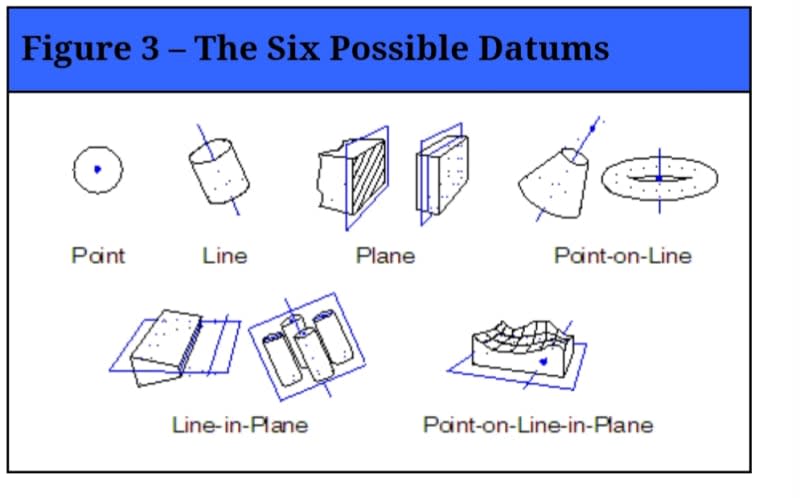

Except for a spine (curve), I think a line is mainly meant to be part of "a combination thereof" ("thereof" refers to "theoretically exact point, axis, line, plane"). An example for a line as a component of a datum could be the line from "line in plane" or "point on line in plane" from Bill Tandler's selection of datums.

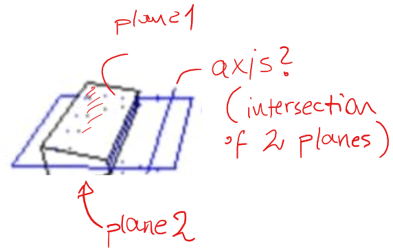

In that 'line-in-plane' example with the wedge, I would still call it an axis, rather than a line, because it is the intersection axis of the the 2 planes (actually 3 planes: 2 wedge planes and the symmetry plane).
So to me, all datums come down to plane, axis, and point (and of course combination thereof), or even just planes since axis and point can be broken into planes.

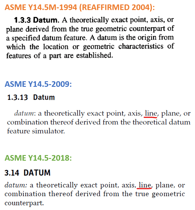

In my opinion, the word "line" should be removed from the definition of a datum in the standard.
Tarator,
What about the "point on line in plane" example? Is the line there also an axis?
That is not part of the standard. The standard does not include a reference to Tandler's post as an authority.
Yes, the line there is also an axis. That's my point, there is no difference. Maybe I can re-formulate the question:
Could we call "line-in-plane" "axis-in-plane", and "point-on-line-in-plane" "point-on-axis-in-plane" instead? What does the term "line" add to the definition of a datum in the standard (2009 and 2018)?

" A datum line that is not an axis is a line used as a datum, but doesn't fit the above condition."
I searched the standards and cannot find that definition. What paragraph is that in?

Also, "line" is not defined by itself as a datum. Page, paragraph, 2009 or 2018, seems to be missing.
"Line is listed as a type of datum in the datum definition in the definitions section. "
Listed <> defined.
There is no "special type" in the standard.
It is up to a standard to provide an unambiguous definition, an explanation, and an example to ensure a uniform use and interpretation.
Failing to do all three leaves the term just a sound you make in your head.
