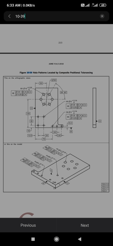

2) Since position tolerance can be used for perpendicularity control, I have used position tolerance.
Where does it say that? Which paragraph? Please advise.
In my opinion: "7.2 POSITIONAL TOLERANCING Position is the location of one or more features of size relative to one another or to one or more datums."
In many examples I have seen, flat surface as datum A and TP applied with dia 0.1 for hole axis.
As per standard also TP controls orientation.
ASME Y 14.5:2018
Correct me if I am wrong.
GD&T as per ASME Y14.5:2018.
General tolerance in title block in accordance with ISO 2768
There is no "hole axis" but "holes axes" !! (singular versus plural)
In the example you show from the standard there are multiple holes, but in your case it is only one hole (singular hole). Big difference.
Position is required if you want to control the mutual relationship between the HOLES!!
I am asking again, ISO or ASME?
