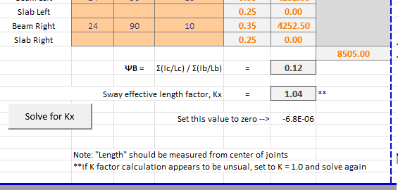

"Automation" of Column Alignment Chart
MacGruber22
Jan 30, 2014
802
Has anyone ever tried turning the alignment chart into an excel spreadsheet that allows direct calculation rather than graphically drawing a line between ΨA, ΨB, and K?
RAM concrete does not automatically account for p-delta in concrete columns. This necessitates a hand calc check on whether columns are sway or not, and then hand calc to determine K.
-Mac
here it is in Python, have only done minimal testing:
Python:
import math
def K_Sway(k, Ga, Gb):
    AISC_C_A_7_2 = (((Ga * Gb * math.pow(math.pi / k, 2)) - 36) / (6 * (Ga + Gb))) - (
        (math.pi / k) / math.tan(math.pi / k)
    return AISC_C_A_7_2
def K_NonSway(k, Ga, Gb):
    AISC_C_A_7_1 = (
        (((Ga * Gb) / 4.0) * math.pow(math.pi / k, 2))
        + (((Ga + Gb) / 2) * (1 - ((math.pi / k) / math.tan(math.pi / k))))
        + ((2 * math.tan(math.pi / (2 * k))) / (math.pi / k))
        - 1
    return AISC_C_A_7_1
def solve_K(Ga, Gb, Sway=True, tol=1e-6, imax=100):
    if Sway:
        ka = 1
        kb = 1e20
        f = K_Sway
    else:
        ka = 0.5
        kb = 1.0
        f = K_NonSway
    fa = f(ka, Ga, Gb)
    error = 1
    esterror = 1
    kc = ka
    i = 0
    while abs(error) >= tol and i <= imax:
        kclast = kc
        kc = (ka + kb) / 2
        fc = f(kc, Ga, Gb)
        if kc != 0:
            esterror = abs((kc - kclast) / kc) * 100
        if esterror < abs(fc):
            error = fc
        else:
            error = esterror
        test = fa * fc
        if test < 0:
            kb = kc
        elif test > 0:
            ka = kc
            fa = fc
        else:
            error = 0
        i += 1
    return {"k": kc, "estimated error": esterror, "k_func error": fc, "iterations": i}
# ACI Column ####
b = 20
h = 28
A = b * h
Ix = b * h * h * h * (1 / 12)
Iy = h * b * b * b * (1 / 12)
rx = math.sqrt(Ix / A)
ry = math.sqrt(Iy / A)
fc = 5000
Ec = 57000 * math.sqrt(fc)
Lc = (20 - 2) * 12
EILcx = ((Ec * Ix) / Lc) * 0.7
EILcy = ((Ec * Iy) / Lc) * 0.7
# Base Joint - Foundation
# AISC Chapter C Commentary
# Pinned Foundation
Gbx = 10
Gby = 10
# Fixed Foundation
# Gbx = 1.0
# Gby = 1.0
# Top Joint
# Framing Perp. to h
bwt = 28.5 * 12
hwt = 12
Lwt = 30 * 12
Iwt = bwt * hwt * hwt * hwt * (1 / 12) * 0.25
fcwt = 5000
Ecwt = 57000 * math.sqrt(fcwt)
bet = 28.5 * 12
het = 12
Let = 30 * 12
Iet = bet * het * het * het * (1 / 12) * 0.25
fcet = 5000
Ecet = 57000 * math.sqrt(fcet)
EILbxt = ((Ecwt * Iwt) / Lwt) + ((Ecet * Iet) / Let)
Gax = EILcx / EILbxt
# Top Joint
# Framing Perp. to b
bnt = 28.5 * 12
hnt = 12
Lnt = 30 * 12
Int = bnt * hnt * hnt * hnt * (1 / 12) * 0.25
fcnt = 5000
Ecnt = 57000 * math.sqrt(fcnt)
bst = 28.5 * 12
hst = 12
Lst = 30 * 12
Ist = bst * hst * hst * hst * (1 / 12) * 0.25
fcst = 5000
Ecst = 57000 * math.sqrt(fcst)
EILbyt = ((Ecnt * Int) / Lnt) + ((Ecst * Ist) / Lst)
Gay = EILcy / EILbyt
kx = solve_K(Gax, Gbx)
kx_nonsway = solve_K(Gax, Gbx, Sway=False)
ky = solve_K(Gay, Gby)
ky_nonsway = solve_K(Gay, Gby, Sway=False)
klrx = kx["k"] * Lc * (1 / rx)
klrx_nonsway = kx_nonsway["k"] * Lc * (1 / rx)
klry = ky["k"] * Lc * (1 / ry)
klry_nonsway = ky_nonsway["k"] * Lc * (1 / ry)
Pu = 542
m1x = 0
m2x = 91.6
m1y = 0
m2y = 26
bdns = 0.505
EIxeff = 0.4 * Ec * Ix * (1 / (1 + bdns))
Pcx = (((math.pi**2) * EIxeff) / (kx["k"] * Lc) ** 2) * (1 / 1000)
Pcx_nonsway = (((math.pi**2) * EIxeff) / (kx_nonsway["k"] * Lc) ** 2) * (1 / 1000)
cmx = 0.6 - (0.4 * (m1x / m2x))
deltax = cmx / (1 - (Pu / (0.75 * Pcx)))
deltax_nonsway = cmx / (1 - (Pu / (0.75 * Pcx_nonsway)))
m2xmin = Pu * (0.6 + (0.03 * b)) * (1 / 12)
m2xmag = max(m2x, m2xmin)
mcx = max(deltax, 1) * m2xmag
mcx_nonsway = max(deltax_nonsway, 1) * m2xmag
EIyeff = 0.4 * Ec * Iy * (1 / (1 + bdns))
Pcy = (((math.pi**2) * EIyeff) / (ky["k"] * Lc) ** 2) * (1 / 1000)
Pcy_nonsway = (((math.pi**2) * EIyeff) / (ky_nonsway["k"] * Lc) ** 2) * (1 / 1000)
cmy = 0.6 - (0.4 * (m1y / m2y))
deltay = cmy / (1 - (Pu / (0.75 * Pcy)))
deltay_nonsway = cmy / (1 - (Pu / (0.75 * Pcy_nonsway)))
m2ymin = Pu * (0.6 + (0.03 * b)) * (1 / 12)
m2ymag = max(m2y, m2ymin)
mcy = max(deltay, 1) * m2ymag
mcy_nonsway = max(deltay_nonsway, 1) * m2ymag
Hey that is great! I will test it out.
-Mac
If excel is your thing, you can use this VBA code. The varibles used here are just Ga and Gb and picking whether you use sidesway inhibited or sway equations.
The formulae for these are from AISC Commentary Page 16.1-240 (14th edition)
Public Sub K()
Dim Ga, Gb, K As Single
Dim Frame As String
Frame = Range("AE25")
Ga = Range("AG11")
Gb = Range("AG40")
If Frame = "Y" Then GoTo 10
For K = 1 To 20 Step 0.01
If (Ga * Gb * (3.14159 / K) ^ 2 - 36) / (6 * (Ga + Gb)) - (3.14159 / K) / Tan(3.14159 / K) < 0 Then
Range("N24") = K
GoTo 20
End If
Next K
10 For K = 0.5 To 1 Step 0.01
If (Ga * Gb * 3.14159 ^ 2) / (4 * K ^ 2) + (Ga + Gb) * (1 - (3.14159 / K) / (Tan(3.14159 / K))) / 2 + 2 * Tan(3.14159 / (2 * K)) / (3.14159 / K) < 1 Then
Range("N24") = K
GoTo 20
End If
Next K
20 End Sub
DuMonteil published some simplified equations way back when, as I recall (for Steel), and if you were going to go all iterative or goal seek on it, you could use those formulas as a seed value. (See 1992 3Q Engineering Journal).
Referenced here:
slick, is that excel macro just running 2000 times and presuming convergence?
Thanks. I did find the chart equation. I had presumed it was more of a complicated step function. I was lazy and added a goal seek macro and button. Sometimes the solution is out of bounds, but resetting K to 1 gets it back to a reasonable re-solution.
-Mac
I like the VBA option. Just need to be careful that adding commentary to the code will change the "Go To" line.
-Mac
The easiest way I know of is to provide a guess for k, then let Excel's Goal Seek function (Data/What-if-Analysis/Goal Seek) solve for k.
SF2607 - Yeah, a good guess keeps the algorithm in bounds.
-Mac
MacGruber22 - That's the easy part, right? k is going to be between 0.7 and 2.5. I always guess 1.0 and it converges pretty quickly. I set the number of iterations to 100. If I have several of these, I get impatient and change that to 10. Close enough.
