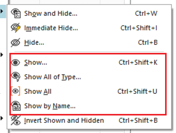

explore all the commands (under HIDE) that begin with SHOW and one
of them should be able to show what is needed when many are hidden,
Jerry J.
UGV5-NX1899
Hi Jerry,
This is exactly what I was saying in my previous comment. "You have to either unhide all the bodies at once or unhide the intended bodies one by one." The commands you mentioned in the screenshot unhides the all the bodies or a class of bodies or one by one. Unhiding your intended bodies by these commands is tedious and it will slow down your modeling speed. But in isolate command it will hide the unselected visible bodies when you run the command first time then when you run the command again it will return only those bodies again. This is the power.
