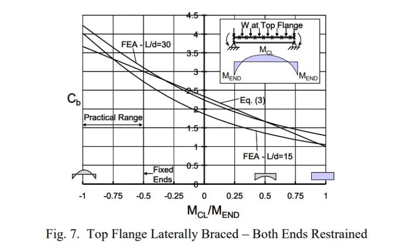

When you posted Cb_Yura here:
Kootk said:
To provide a more meaningful comparison, I reran the beam as fixed ended with a uniform load.
M_LTB_Mastan_Concentrated = 690 k-ft
M_LTB_Mastan_Uniform = 854.2 k-ft
Cb_Yura = 3.00
M_LTB_Celt83 = 919.4 k-ft (Your calc adjusted by ratio 3.00/3.67)
854.2 k-ft / 919.4 k-ft = 93%. As approximate as this stuff is, that's a non-discrepancy in my book.
What is this referencing? Or what equation is this?

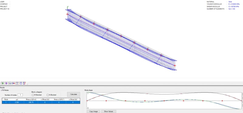

I just ran a quick one in LTBeam and its showing the bottom flange kicking out again at longer effective length than AS4100 assumes.
Loading is central point load, with fixed ends (free to rotate in plan)
I haven't compared the actual numbers against AS4100 yet...

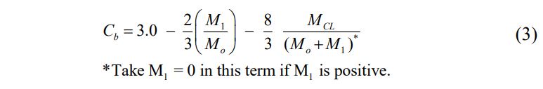

It's a equation/graph from the Yura paper that I attached to one of my posts early on in the thread.
It seems to be the modern AISC approach to lump many of the complexities into the Cb factor, including load height and lateral only bracing impact. I think that it's a bit of a departure from the very old school stuff where Cb was solely about the impact of the disposition of the bending moment along the segment being studied.

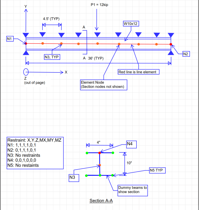

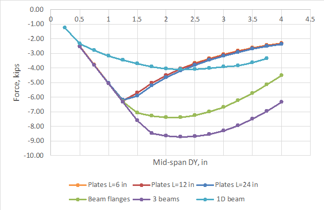

Interim update:
I have been doing some analyses using Strand7, and get widely varying results, depending on how I model the beam. The options I have looked at are (in order of increasing complexity):
- Linear longitudinal beams with beam offsets to the top flange
- Longitudinal beams for top and bottom flange connected with vertical beams
- Longitudinal beams for top and bottom flange connected with plate elements
- Plate elements with 3 levels of plate size
I carried out an incremental displacement analysis with geometric non-linearity, and got the results shown below:
Only the plate models showed a clear buckling load, although the beam models were also highly non-linear.
The buckling load of about 6.2 kips agrees pretty well with my LTBeamN analysis, but the elastic critical load from Mastan2 was much lower, and the elastic buckling load from Strand7 was much higher.
Looking at the LTBeam report on validation tests (linked earlier) all their results agreed with Ansys and Drill within about 0.5% (!). I am going to run some of the examples from the validation report in Strand7 and see what I get.
I'll post more details next time, but the model was as shown in Rfreund's post of 17 Dec, except with a 32 foot span.

I ran this scenario in LTBeam.
LTBEAM: 1.526 (FLF) (Mcr = 266.4kNm)
According to LTBeam the AS4100 clauses work in this instance.
